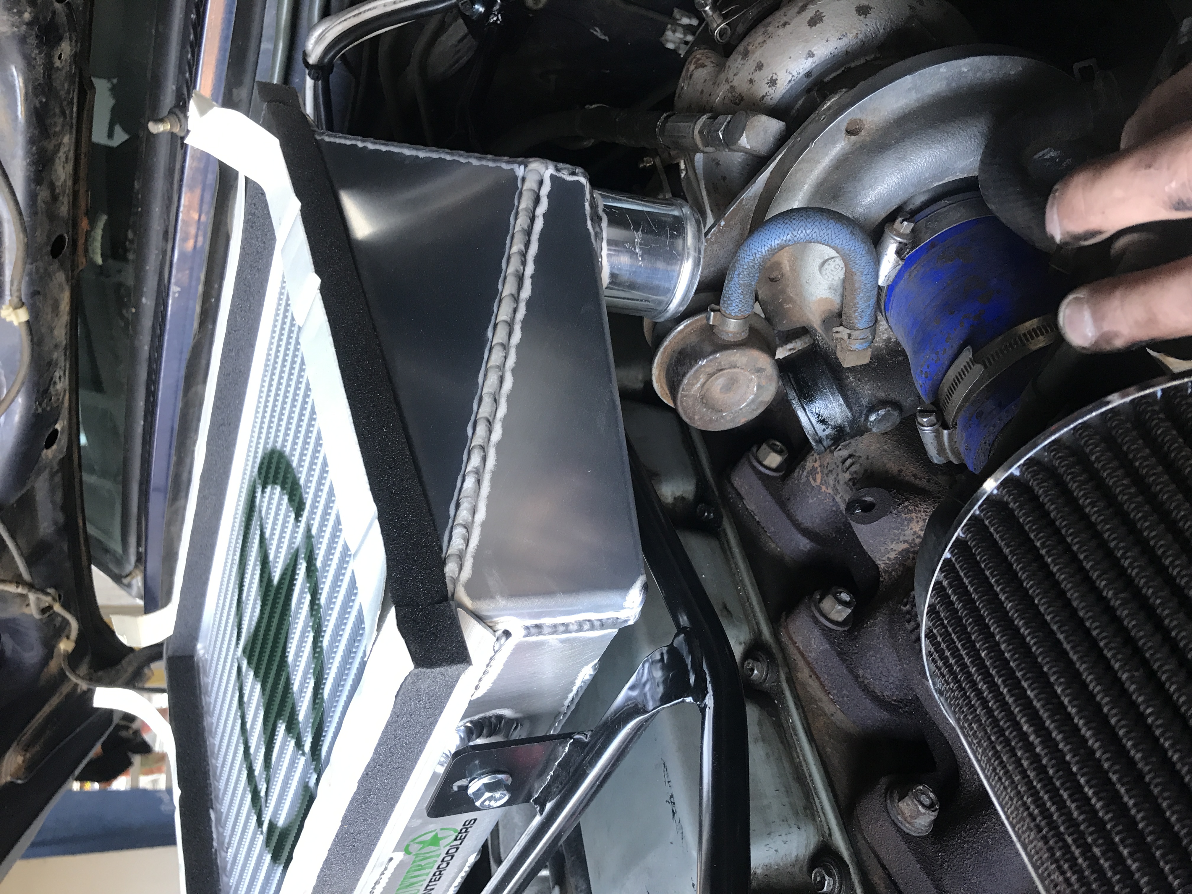

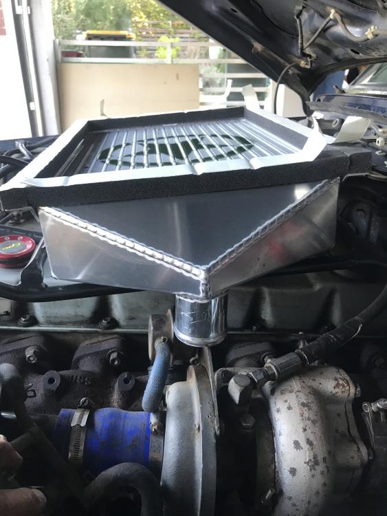

Hi mount turbo/ top mount intercooler issue
I recently bought a top mount cross country intercooler for my maverick and was told by their salesman after sending him a pic of my top mount set up that it will fit. Im running a schwitzer dyn125? Turbo and the wastegate actuator is right in the way of the pipe leaving the intercooler unit. Is there anyway around this cheaply?
G'day,
Lots of turbo charger compressor snail housings can be turned around at different angles so you can change the position of both waste gate and the outlet port.
Some have V clamp which needs to loosened  to turn the housing, some have bolts with clamping plates towards facing centre bearing section it same principle.
You only need to turn it about 30 degrees seeing from the pic
