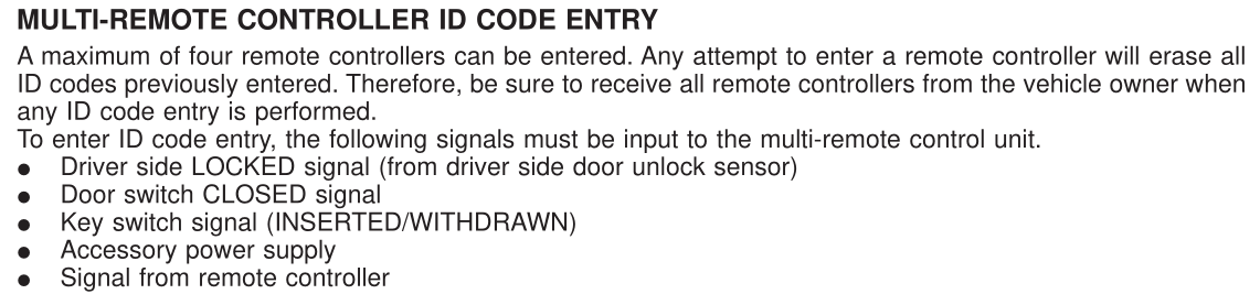

November 17, 20178 yr comment_9075 The part I don't understand is how the immobiliser can work but not the remote? Anyway there is a method to get programming mode ON for remotes aka ID code. Does your warning buzzer work when you leave ignition key in position and open the door aka that annoying chime? If it doesn't it is possible that previous owner had disconnected the plug under the steering wheel to silence it (very popular modification) which means the remote programming function can't be activated due to no detection of the key or "key switch signal" which can be unintended consequence of such modification. Easy to fix temporarily, just remove cover under the steering wheel and re-connect it for remote programming. Regards be Edited November 17, 20178 yr by Rumcajs Report
November 20, 20178 yr Author comment_9076 Thanks Rumcajs. It was disconnected but it still will not go into program mode. I was so excited as I thought it was going to work. Anymore suggestions? Report

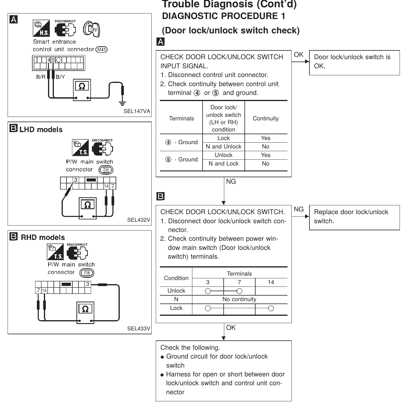

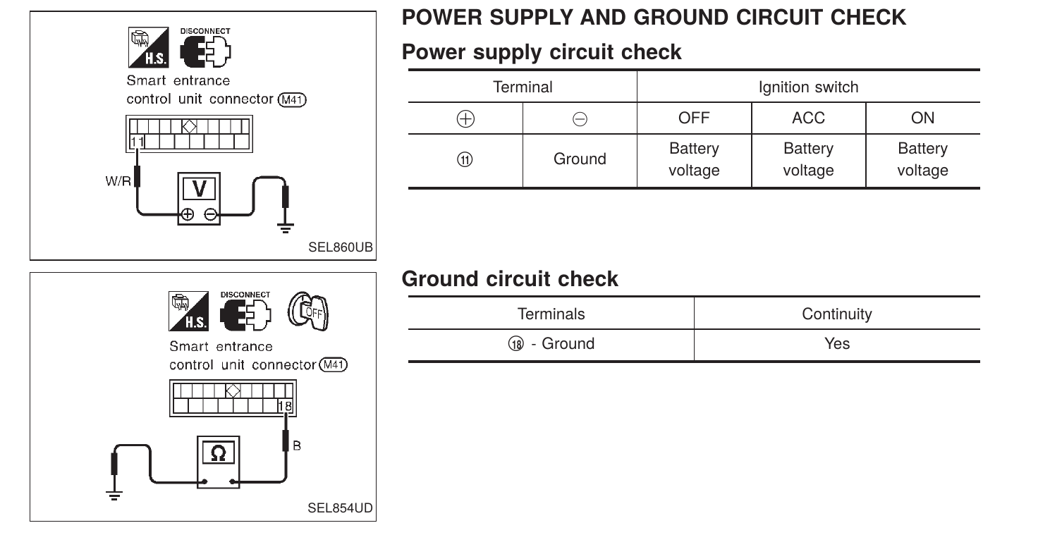

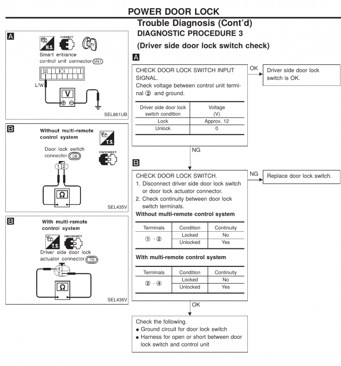

November 21, 20178 yr comment_9078 Well, it may be that some of the prerequisites are not fullfiled therefore it will not go in to programming mode. For start, the actual method is less then ideal so any discrepancy there may be a cause. The unit itself is mounted on the passenger side underneath the SRS airbag module on the steel tube which holds entire dashboard/crash pad in the place. When you remove glove box and look up you'll see it. It is a white semi transparent box. (That is on mine ST model 2005 Series 4) You should confirm that all condintions are fullfilled. Here is trouble shooting guide: Edited November 22, 20178 yr by Rumcajs Report

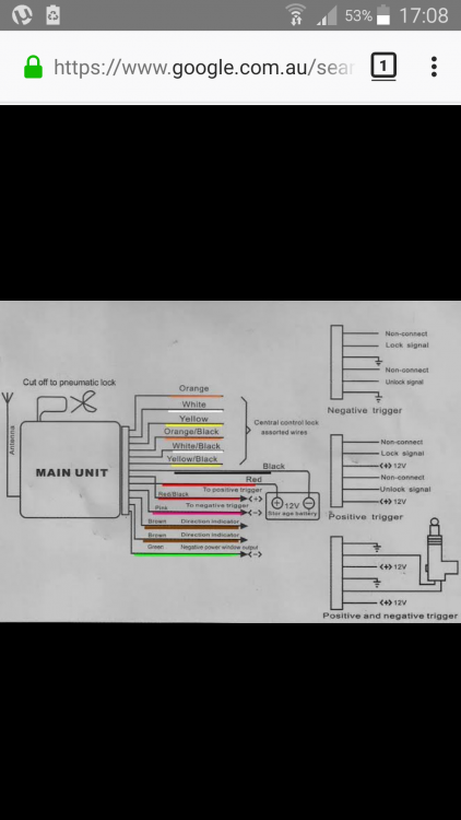

December 2, 20178 yr Author comment_9089 Tried and failed. I think the unit I need to test is behind the stereo. The unit I located was the keyless system. Which only had 8 wires coming from it. From further research, seems it is a common problem and the best solution is to replace it with an after market one. I do have a Gourdan (or something like that)one which I intend to use but the wires do not match those of another thread. I wondered if you how and whether there is anything I need to know about. Thanks again. Report

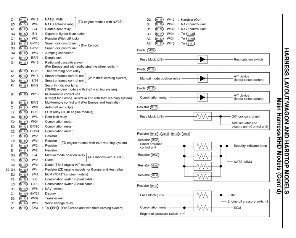

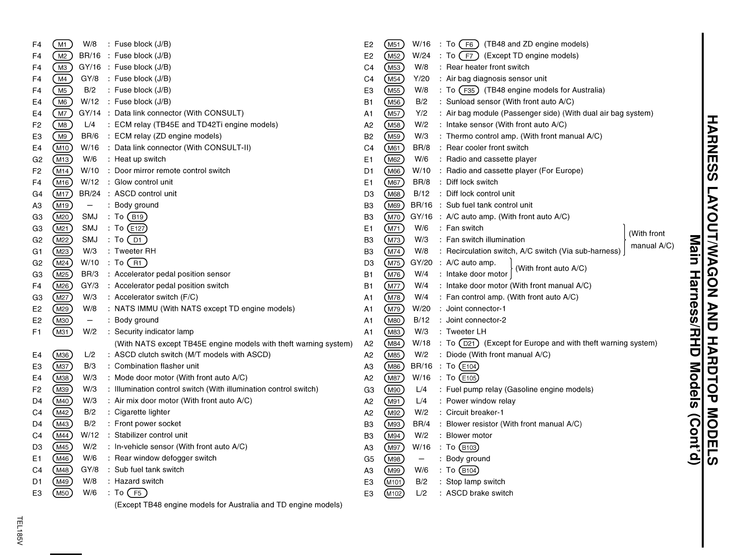

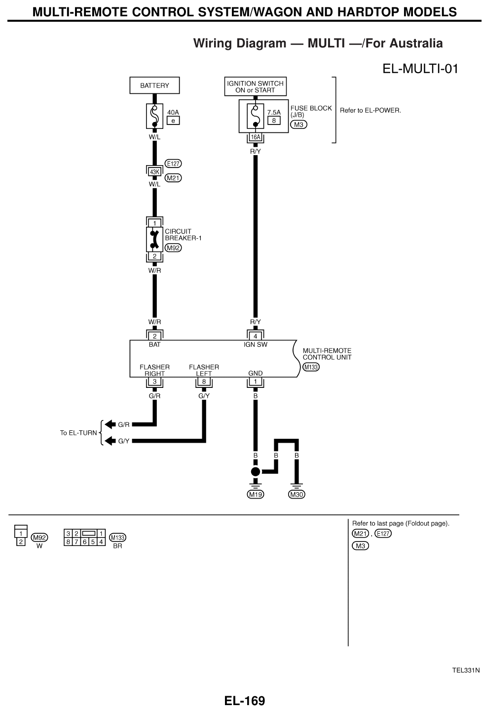

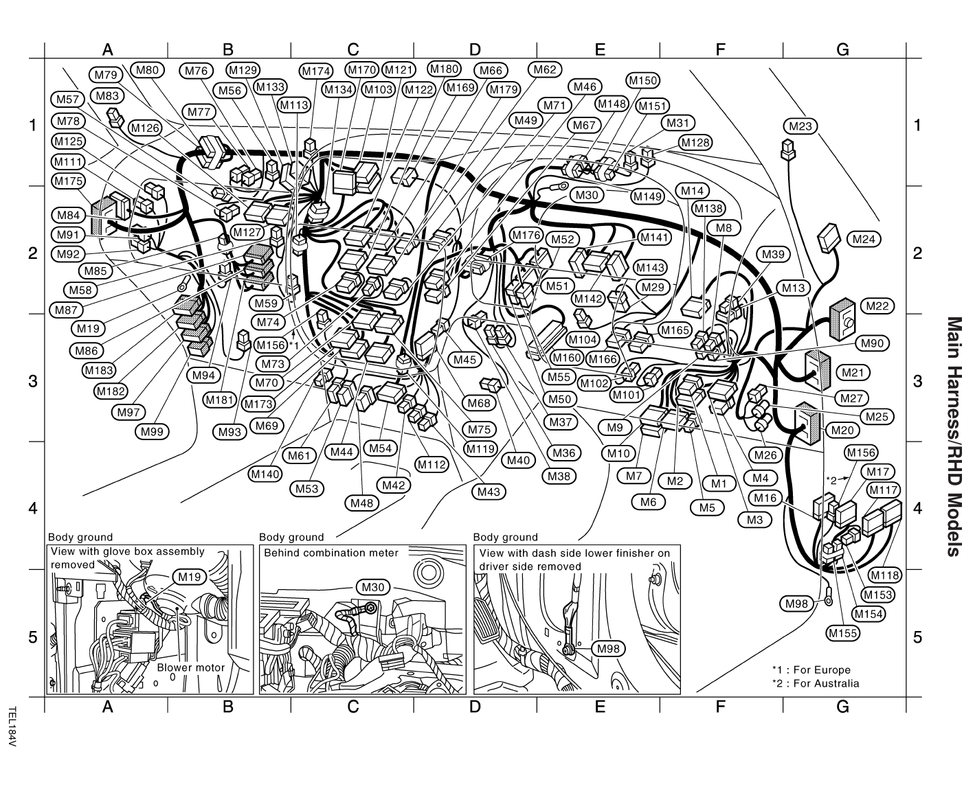

December 5, 20178 yr comment_9094 Sorry mate I would not know what "Gourdan" is, but if the factory remote works then I find it weird that adding keys won't work. Regards Here is wiring diagram for 2006 revision AU ==> maybe that one is yours. Location of multi-remote (M133) is B1 on the harness layout passenger side ..... Report

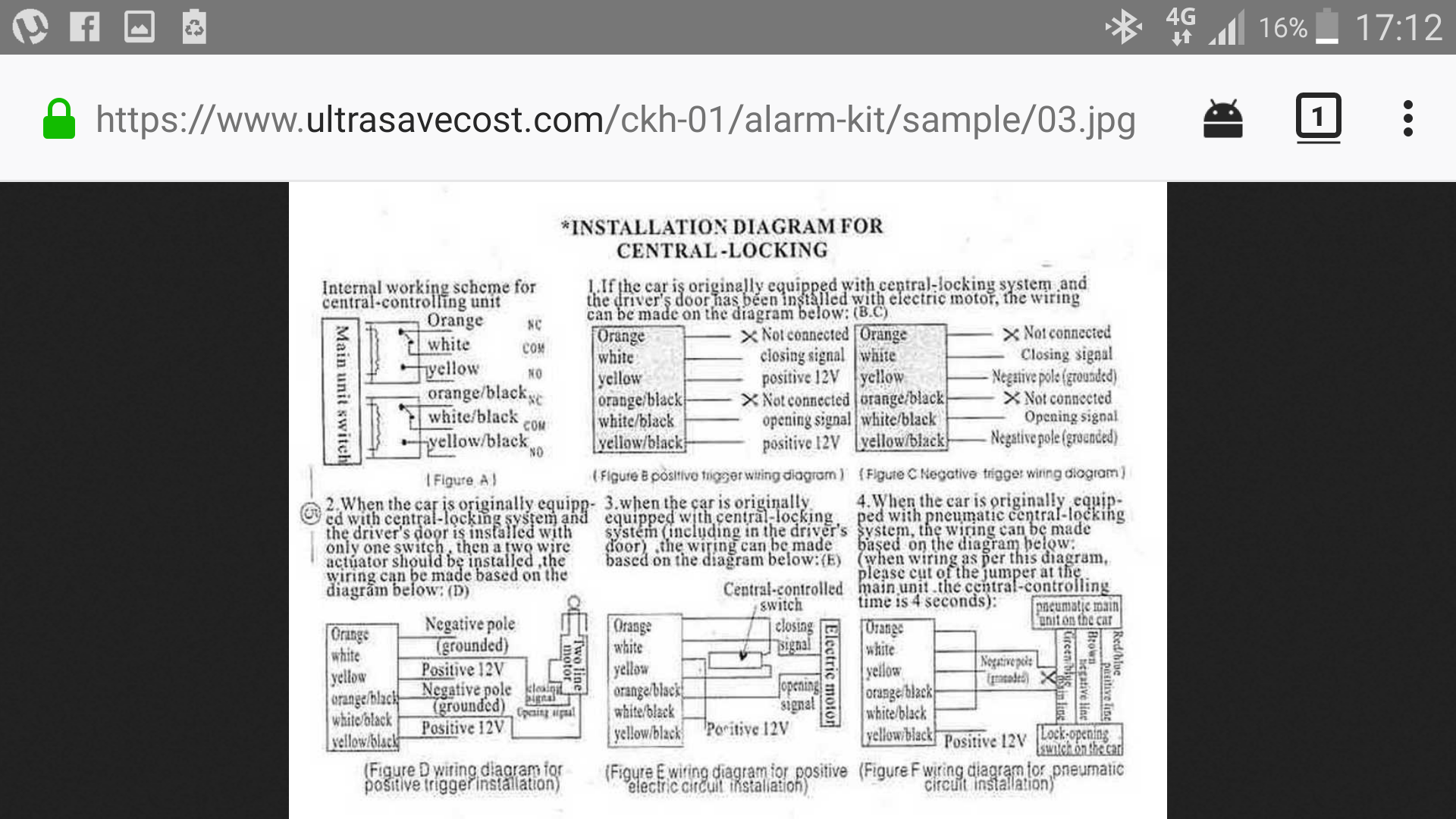

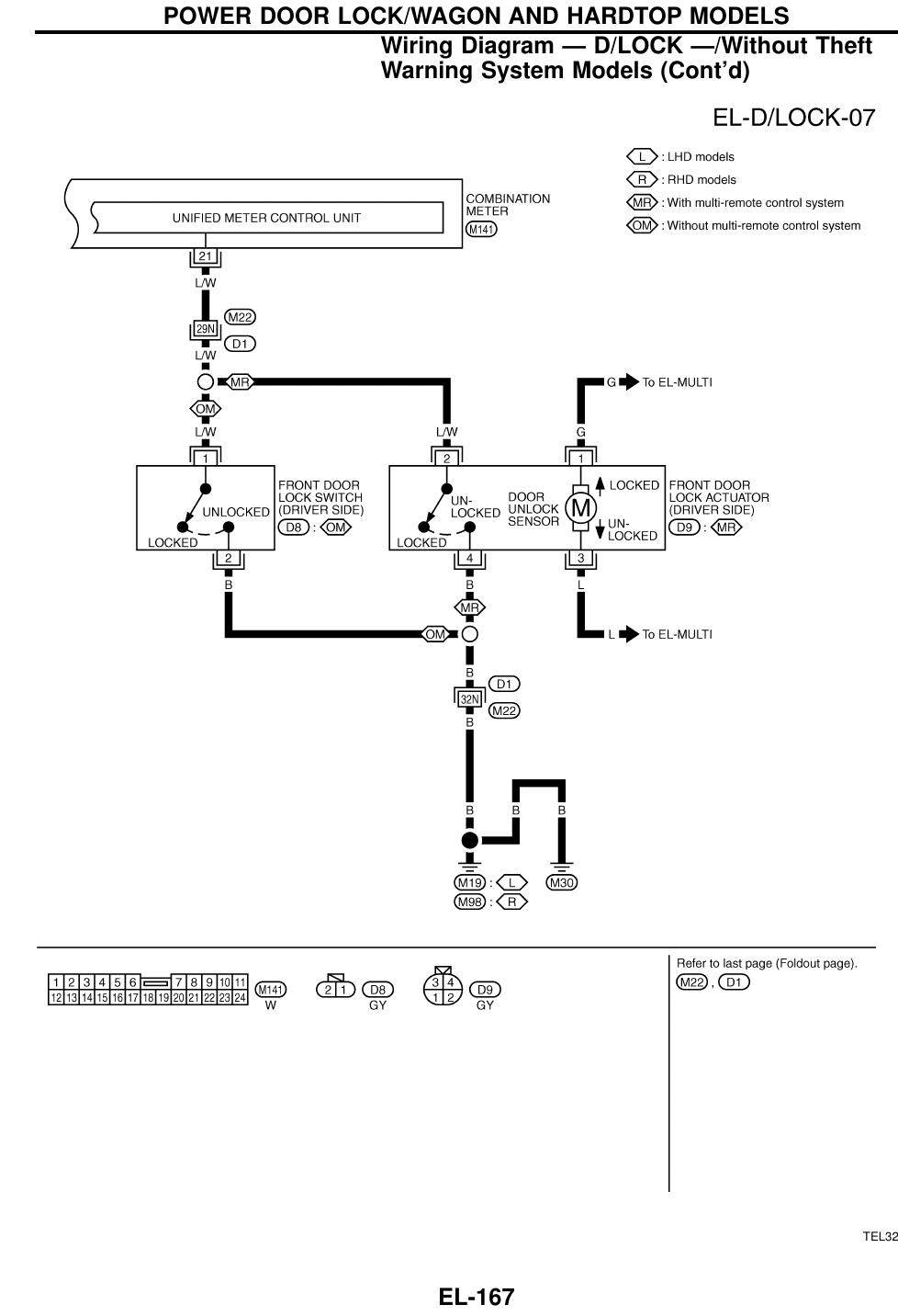

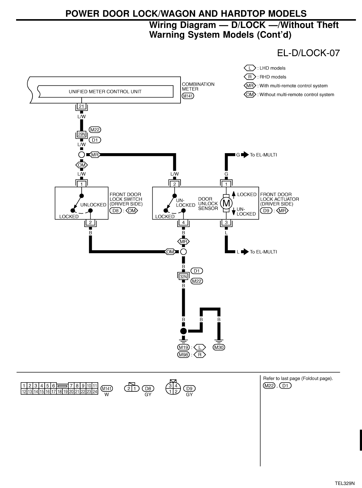

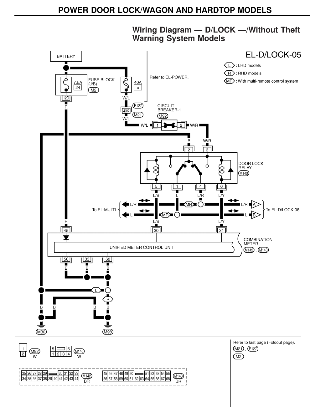

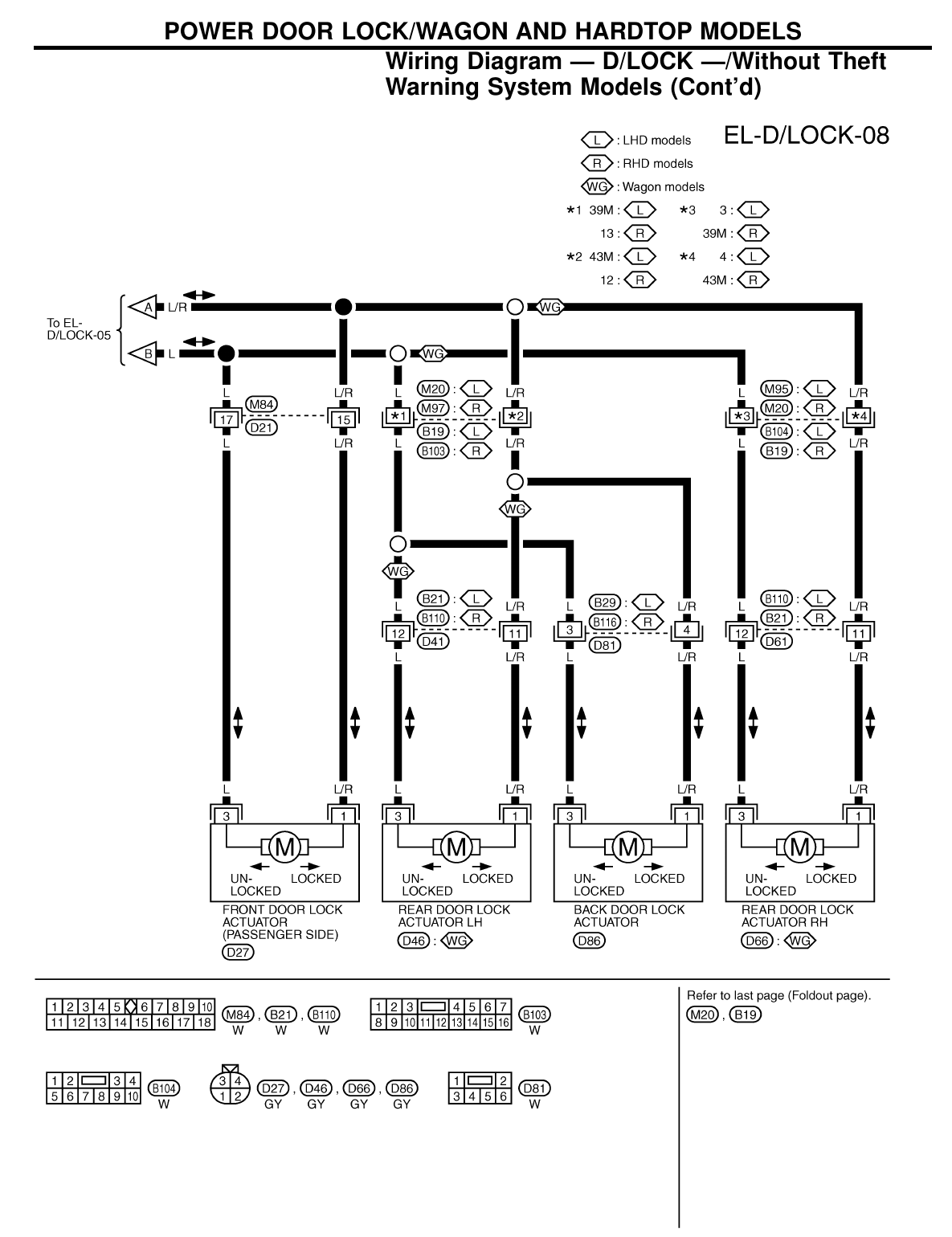

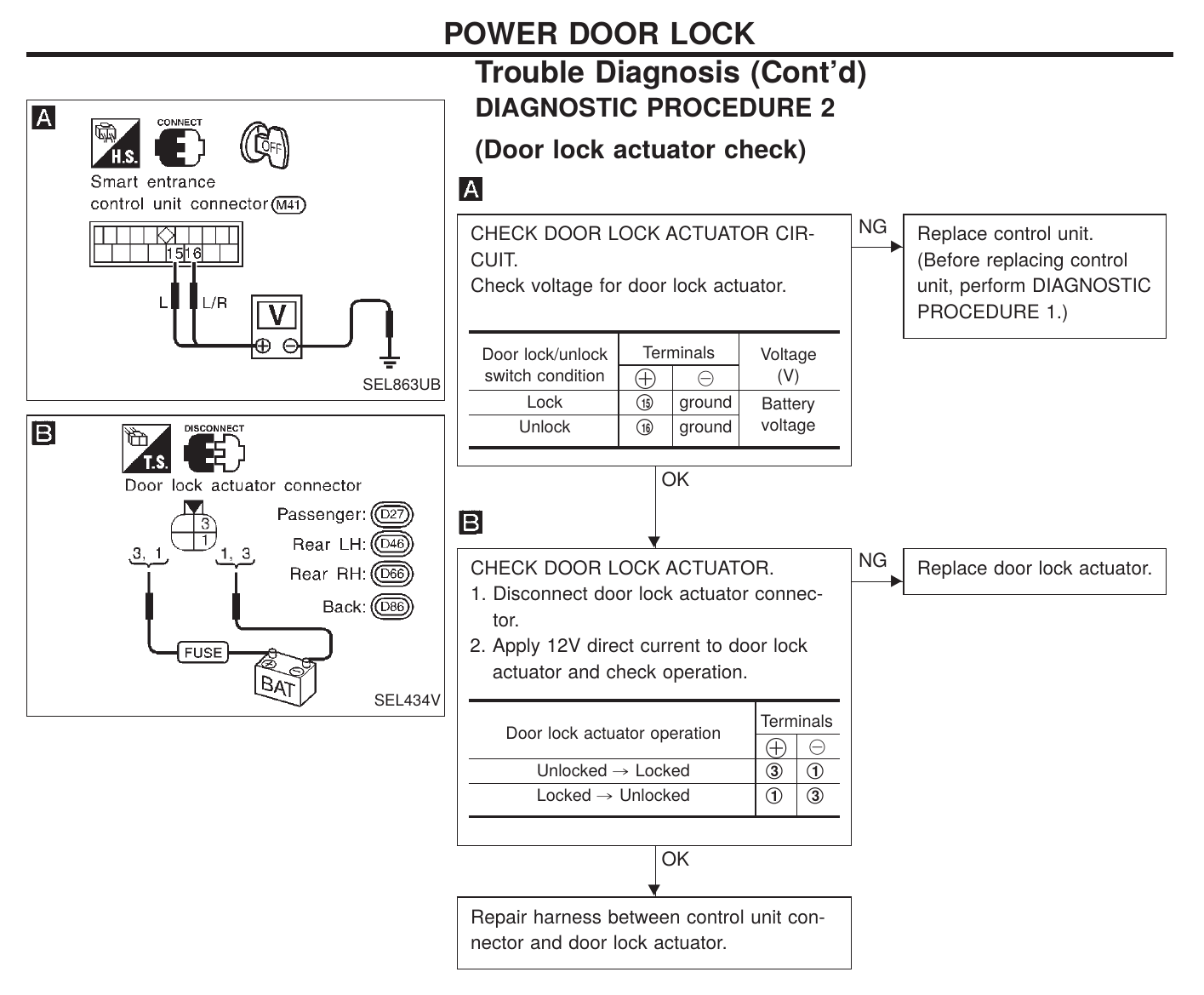

December 6, 20178 yr Author comment_9097 I'm no auto electrician and most of that was lost on me. I have picked up a workshop manual. Any chance you would know which diagram would be the one. Diagram attached. I can't find whether Patrols ate negitive or positive feed. Report
December 7, 20178 yr comment_9098 Mate, Patrols are positively switched for most of the things. Anyway I have posted previously the scheme/diagrams for central locking on Patrols. I don't really understand what am I looking at in regards to wiring manual you have posted. Is it for central locking or for alarm? IMHO No.3 sounds like one. Don't forget that door locking relay reverses polarity to electric motors to lock or unlock. Is the central locking working? E.g. when you turn the key in the drivers door lock does it lock/unlock all the doors and or when you push central locking button on the drivers side does it lock/unlock? If so then all you need to do is to hack the multi-remote signals nothing else or so is my understanding. If you look at multi-remote from Nissan for Australia for 2006 revision (my previous posts) then it is simple 8 pin control box (M133) Pin 1 => Ground Pin 2 => Battery positive B+ Pin 3 => RH side indicator signal Pin 4 => Ignition ON positive aka 15+ Pin 5 => Lock signal to unified meter control unit (aka Instrument cluster) Pin 6 => Unlock signal to Unified meter control unit Pin 7 => Driver lock status (ground when locked from driver door actuator) Pin 8 => LH side indicator signal There are multiple variations of multi remote, there is 16 pin unit in previous revisions, unless you know what is in yours it isn't easy to figure out from just wiring diagrams. However you've mentioned that yours is 8 pin unit. Regards Edited December 7, 20178 yr by Rumcajs Report
