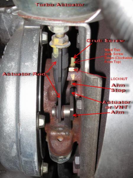

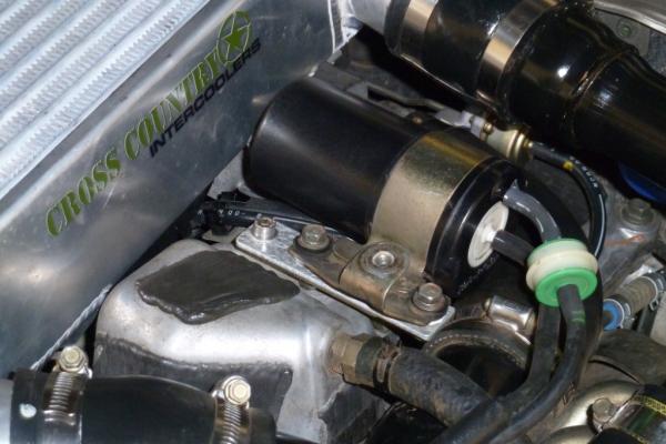

May 16, 201412 yr comment_7891 Please check the turbo actuator first, it should lift up fully and not fluctuate while the engine is idling. 02 Patrols have vacuum canister mounted next to intercooler and they like to leak so badly that there isn't enough vacuum generated to actuate turbo vanes. You can temporarily bypass it if needed when you see no movement in the actuator. Cheers Edited May 16, 201412 yr by Rumcajs Report

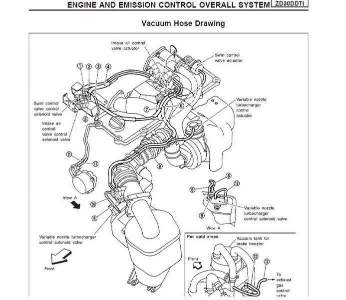

May 17, 201412 yr comment_7894 You need to check if it is vacuum leak or control solenoid going silly. This is a process of ellimination. You can connect vacuum line directly to actuator to see what will happen. Line with what looks like a little filter is the direct line from vacuum pump. Cheers Report
