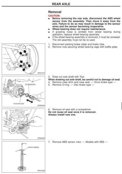

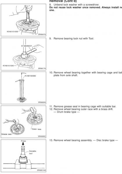

capeyorker Posted February 16, 2015 Report Share Posted February 16, 2015 Hope one of you guys can give me some advice on a leaking rear wheel bearing seal on my 99 4.2td wagon with rear discs. I have removed the axle from the housing and see there is a large nut on the axle holding the wheel bearing in place and Im sure there is a seal behind it. does any one know whats involve in removing that bearing. do I need a press to get the bearing out, cheers. Link to comment Share on other sites More sharing options...
Rumcajs Posted February 17, 2015 Report Share Posted February 17, 2015 (edited) G'day mate, Welcome to the forum. Yes, you will need a press/puller to remove bearing .... See pages bellow: Regards Edited February 17, 2015 by Rumcajs Link to comment Share on other sites More sharing options...

Rumcajs Posted February 18, 2015 Report Share Posted February 18, 2015 (edited) I'm not sure I follow as I gave you disc brakes diagram itself (overview of parts) and dismantling part. Are you after installation/asssembly part too? I went through entire manual I have from 1997-2007 (includes Australian models) and there is no change in any revisions to actual hardware in that manual. It appears that dismantling instructions are more or less similar with just extra notes if it is drum or disc brake type. Now what I posted is semi floating type H233 setup and as far as I'm aware H260 full floating type setup is on leaf suspension utes with drum brakes only.. but being Nissan it is possible that you have H260 with semi floating axles and disc brakes but I'm only familiar with H233 axles. I just checked GQ service manual and instructions are identical (why wouldn't they be, the same axles) Regards Edited February 18, 2015 by Rumcajs Link to comment Share on other sites More sharing options...
