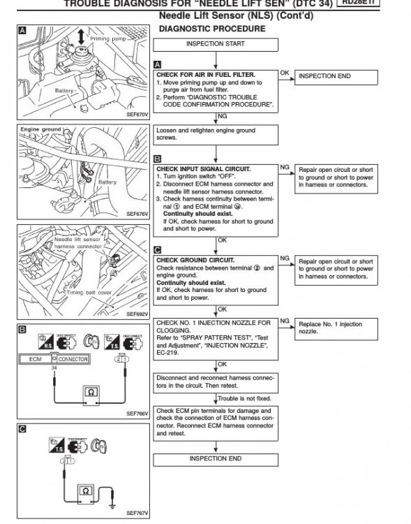

Tico_Patrol Posted March 24, 2017 Report Share Posted March 24, 2017 the cable that runs from the connector to the NLS broke and I have no clue on which line is soldered where... Any clue? On 1/22/2016 at 1:49 AM, Rumcajs said: Needle lift sensor is the part of the no: 1 injector. I suggest you take the car to the diesel specialist. Regards Link to comment Share on other sites More sharing options...
Rumcajs Posted March 31, 2017 Report Share Posted March 31, 2017 ....the cable that runs from the connector to the NLS broke and I have no clue on which line is soldered where... Any clue? Not sure I follow but I'm pretty sure you will need a new injector with NLS if the internal connection is damaged..... Regards Link to comment Share on other sites More sharing options...
