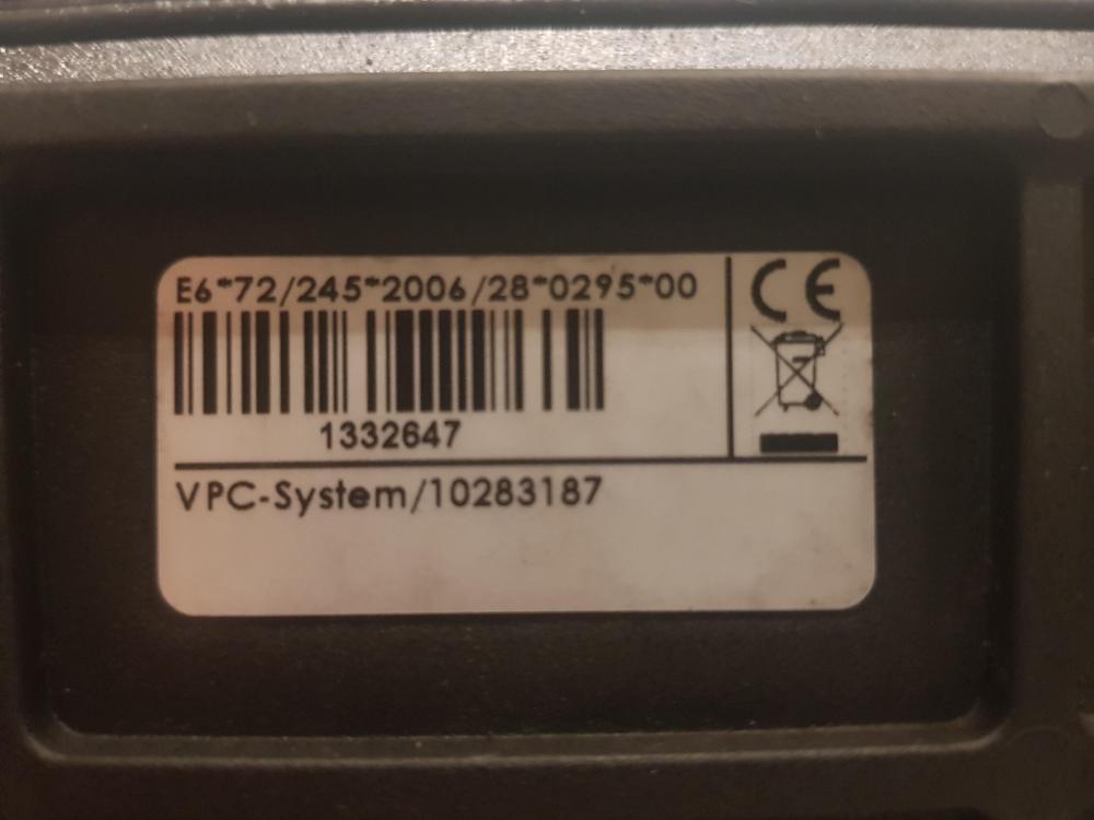

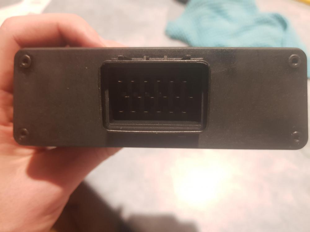

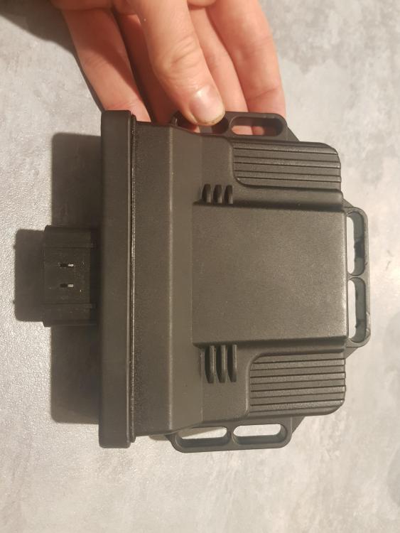

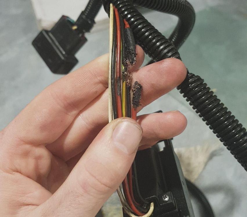

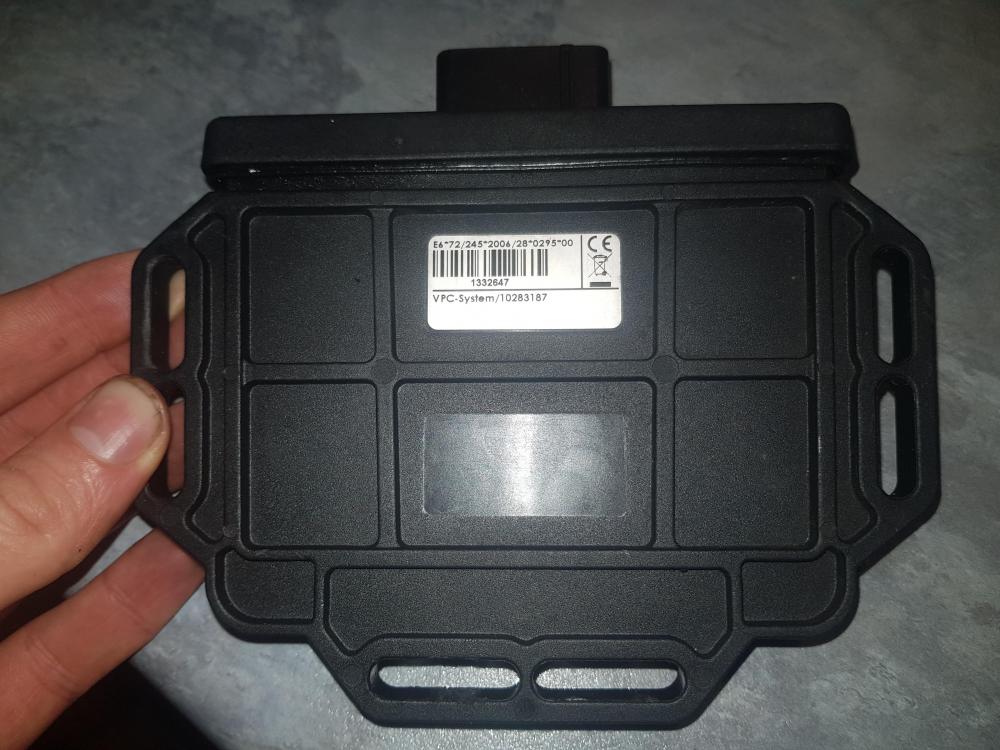

September 20, 20188 yr comment_9156 Hi, Can anyone identify this chip? Looks similar to a DTE when searching and seems to have the same casing but the DTE chips have buttons, and look slightly different. Searching the numbers on the tag return nothing Also Is it possible to buy a replacement Wiring loom from Injector Pump to the factory loom (with or without the Tee off for the chip)? cheers, Shane Edited September 20, 20188 yr by ShaneOwnsANissan Report
September 21, 20188 yr comment_9157 G'day, For which model of GU is this unit for? Is it for ZD30 VP44 injection pumps? The sad reality is that for the most if not all of these aftermarket "piggy back" controllers is that they're usually repackaged same electronics from just one manufacturer. As for the plugs or perhaps entire loom the best chance is to go to wreckers. Technically they should also be available as spare parts but the cost is usually very high. Regards Report
September 21, 20188 yr Author comment_9158 Hi Rumcajs, It's installed on a 2001 GU ZD30 VP44 pump. 3L non-common rail. I've been unsuccessful in my many hours of searching to find a picture of this exact one, I've found DTE and DTUK chips that are very very similar with the same outer casing but they are also slightly different.. :\. I've soldered these bad boys back together and the car now runs (Bought it not running) but not sure if soldering affects the readings to/from the pump in anyway. I'll have to find some electrical guru who knows for sure. Report

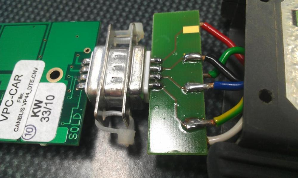

September 22, 20188 yr comment_9159 What a mess! Soldering wires if done properly should not affect readings however soldering is not performing well under mechanically stresed connections. If I was repairing that loom I'd make intermediate plug/crimp joint in the wires but thats me, even RAAF teaches its technicians that "soldering is for PCBs and crimping for cables and I had same training for my trade from the vehicle manufacturers.... As with the chip your best bet if you really want to know is to expose its internals aka check the PCB with all the electronic hardware. Like this one ==> Essentially repackaged DTE chip the grand daddy of them all. Anyway, yours seems awfully like the DPU system or Diesel Power Unlimited I found the link to to it on Russian E-bay (DPU chip) Regards Edited September 22, 20188 yr by Rumcajs Report
September 22, 20188 yr Author comment_9160 Thanks Mate, A friend of mine did the repair and chose to solder. If I have any issues I'll definitely look at using the plug/crimp joint as suggested. thanks for the info! Report
June 14, 20215 yr comment_11154 hi guys..Im wondering if anyone might know if we are able to have these things checked? i have the exact same unit ( running the same numbers as the one above) on my 06 rodeo 3ltd..when i bought the ute i found this unhooked and cable tied on the firewall and as the engine is using heaps of fuel im wondering if unplugging it has tricked the tune in the ecu or some modern day things..I did my time when we primed a pump and cracked an injector to make them run and wound the fuel screw 1/4 turn to make em go faster but im well in the dark with these electronic pumps, chips etc..any help would be greatly appreciated Report
