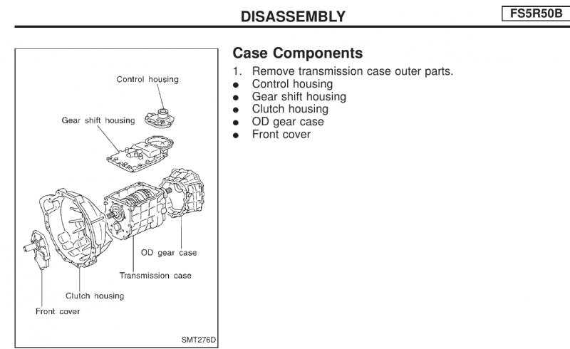

lovejones Posted April 17, 2015 Author Report Share Posted April 17, 2015 I understand your point, however, (and whilst i havnt looked any further in the manual) my example is if i follow the guide for dismantle of gearbox, it advises mount adapter plate onto vice, remove OD and fork rod, mine doesnt have an adapter plate, its a solid unit, i cannot work without taking the shafts out (shame really as the adapter plate scenario looks so much easier to work with). Id prefer to have a manual for the box i have instead of assuming and going gungho only to find ive done something i a) dont need to do, something wrong. Cheers Link to comment Share on other sites More sharing options...
Rumcajs Posted April 18, 2015 Report Share Posted April 18, 2015 (edited) Well, I hope you understand that the manual contains info about multiple options so I hope you are looking at right one. What you are describing is/sounds like FS5R30A which is in 2.8 L GU. You need to know what gearbox model you are dealing with first. Yours should be FS5R50B. Does it look like this one? ==> I can email you relevant pages if you are stuck, PM me your details Edited April 18, 2015 by Rumcajs Link to comment Share on other sites More sharing options...
