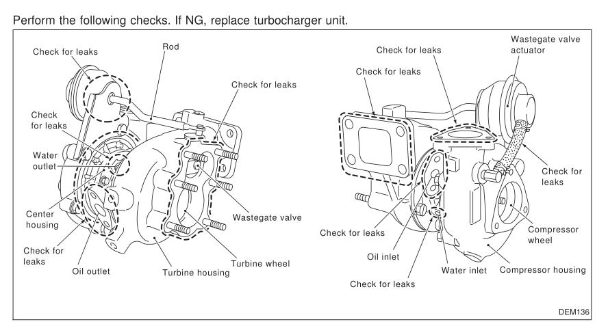

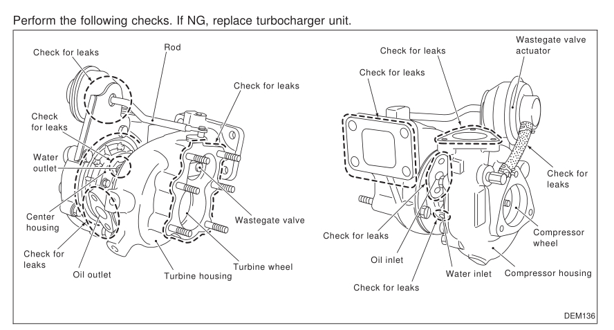

September 6, 201511 yr Author comment_8427 Many thanks for the detail, I had to read it several times to make sure I had it all in order.When I bought the car new I had the 3"exhaust put on and the turbo modified and boost to 14psi.I have to say I was a little dissapointed with the outcome. The first trip we did the thing over heated going up Cunninghams gap and we pulled into nissan at Warrick to have fhe vehicle checked. We did have the campertrailer on and it was a hot day.This issue has plagued us ever since and I sometimes wonder if the engine timing is actually correct.I have just replaced the exhaust system and thought while I am under the car i may as well see what else can be done to get the power up. I have noticed some oil leaking from around the turbo, I found it was leaking from the boost controller. I am not sure if this is reasonable . Your thoughts would be most welcome.Regards Roland Report
September 7, 201511 yr comment_8430 There should no oil leaking out of boost controller. I'm assuming you mean waste gate actuator piston. If that's the case that means either turbo is not OK or better the amount of blow-by gases contain so much oil that it now contaminates the intake side of the turbo where it then gets to the actuator via the boost controller pressure hose.Possible solution to that if thats the case is to fit catch can or oil separator to the breather hose between rocker cover and intake hose before turbo charger compressor housing.As for the overheating issue just make sure the fan is working (you should feel certain resistance in viscous coupling clutch when engine is cold and stationary if it spins easily check for tell tale traces of dust build up on the fan hub around the center of the shaft, that means silicon oil has leaked out, or and this is crucial you don't have the radiator blocked either externally (easily checked with workshop light) or internally (common problem) blocked which requires specialist to confirm.Cheers Report
September 9, 201511 yr comment_8432 First and most important, in my opinion is to fit a EGT Gauge (pyro gauge). The TD42 with aftermarket turbo if set up incorrectly will push HIGH egt's which can cause major problems.I have a bigger radiator fitted in mine, and that makes a HUGE difference. Viscous coupling also needs to be in good working order too. Oil blowby is a problem on mine too as I have the boost set quite at 12psi, but so far other than sweating around the turbo, all is good so far. An oil catch can is also a good mod to do and adds piece of mind.At 12 psi I have pretty decent pulling power, even with my big camping trailer, but on a long uphill I can see my EGT's climb easily into the early 600 deg C ( probe pre turbo) Report

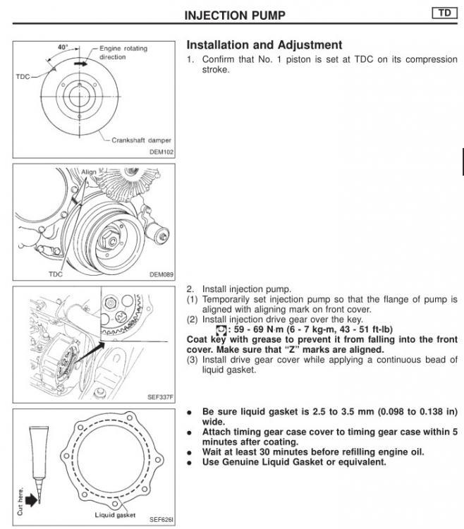

September 9, 201511 yr Author comment_8434 Seems my reply got lost in the ether.When I had the original mods done to the car in 04 they fitted a GBF boost controller and wound the pressure up to 14 psi - good or bad. The oil is leaking out of the small hole in the side of the controller ( I assume when it reached boost pressure) which means there must be a lot of oil coming out of the turbo to the intercooler. As you suggest, I will fit a catch can to the PCV line and see what happens.I have had a look at all the points for leaks as per your diagrams, other than the oil from the boost controller, there are no other leaks so we will watch this space as I have finally got it back together. (I lost the E clip on the boost arm and it took me 3 days to get a new one, problems of living in the bush)Next time I have my head under the bonnet, I will check the fan, I have had it tested however, again I am not convinced.One last thing, is there a way to check the timing of the Injector pump???Once again, thanks for the advice.Hi Ricster,Thanks for the reply.All this has convinced me to fit a few gauges so I can see what is going on. I will start with the boost and Temp. I know the temp has been up high when climbing and I have had to back off on the pedal just to get to the top. One hill I had to stop twice to let the motor cool.It seems everyone else's patrol goes better than mine especially when towing so I am going to get to the bottom of it this time. (gives me a reason to use the new hoist)At least the car is back on the road and it seems to be a lot quieter, except for a thump in the rear but another story for another day.Thanks for the interest.Regards Edited September 9, 201511 yr by rolandcox Report
September 9, 201511 yr comment_8438 ......One last thing, is there a way to check the timing of the Injector pump???..... There is but specialist tool for injection equipment is required ===>That's for fine tuning subject to the pump being correctly timed to the engine in first place ==> Report
