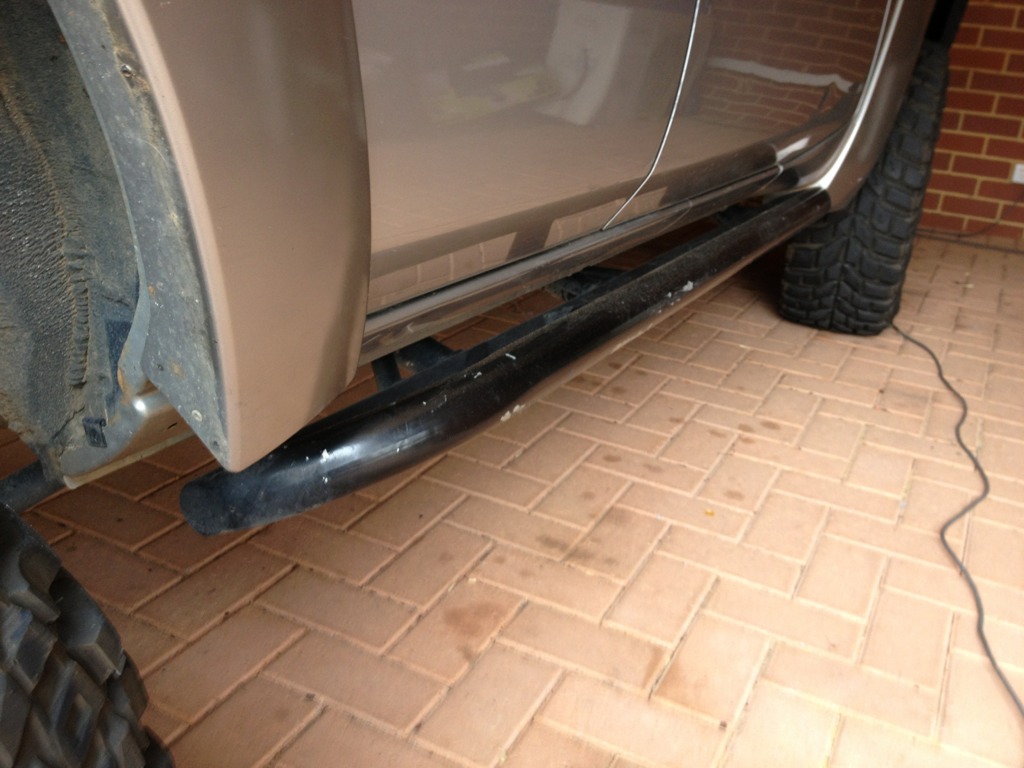

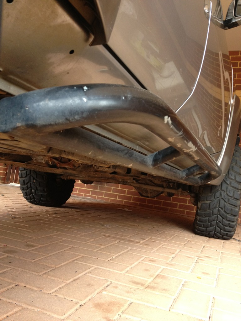

Oldmate Posted June 2, 2012 Report Share Posted June 2, 2012 Hi Guys, I am about to embark on some DIY sliders for series II GU. Wondering If some of you guys can take some pics and post in here off your chassis mounts ( as where they are positioned on your chassis) especially drivers side as there seems to be some crap in the way. I am planning on using 2 U shape mounts and the front one utilize gearbox crossmember bolts I think. Any pics would be great. Cheers fellas Link to comment Share on other sites More sharing options...
Russ81 Posted June 2, 2012 Report Share Posted June 2, 2012 (edited) Here are a few pics of mine I will get some pics of the mounting points next time I'm down the workshop Edited June 2, 2012 by Russ81 Link to comment Share on other sites More sharing options...

GPSTI Posted June 2, 2012 Report Share Posted June 2, 2012 Here are a few pics of mine I will get some pics of the mounting points next time I'm down the workshop Is it just my imagination or is your tie rod bent? BigGQWesty 1 Link to comment Share on other sites More sharing options...
Russ81 Posted June 2, 2012 Report Share Posted June 2, 2012 Nah your right it's taken a pretty big hit Link to comment Share on other sites More sharing options...
BigGQWesty Posted June 3, 2012 Report Share Posted June 3, 2012 It's a custom bend.. Out of the way now... Lol Link to comment Share on other sites More sharing options...
Russ81 Posted June 3, 2012 Report Share Posted June 3, 2012 Lol I like the way you think Link to comment Share on other sites More sharing options...
