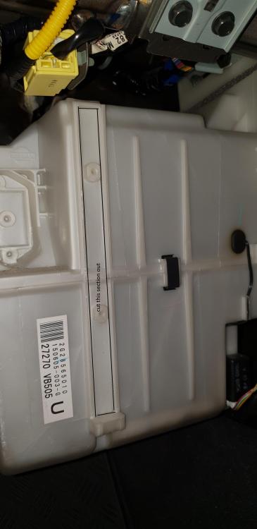

  1. I took the glove box out and the filter slot was closed see photo. Its a two part filter that clips together then slids in. I just wanted to no were to buy the right filter for it. Ill problem go to Nissan spare parts if i have no luck here but there so expensive.
  2. Does any no the were i can get a cabin filter for a gu 2015 patrol, i no it didnt come out with one but you can cut the section out of the air box to make one fit. Just need to no which one it would be. cheers paul

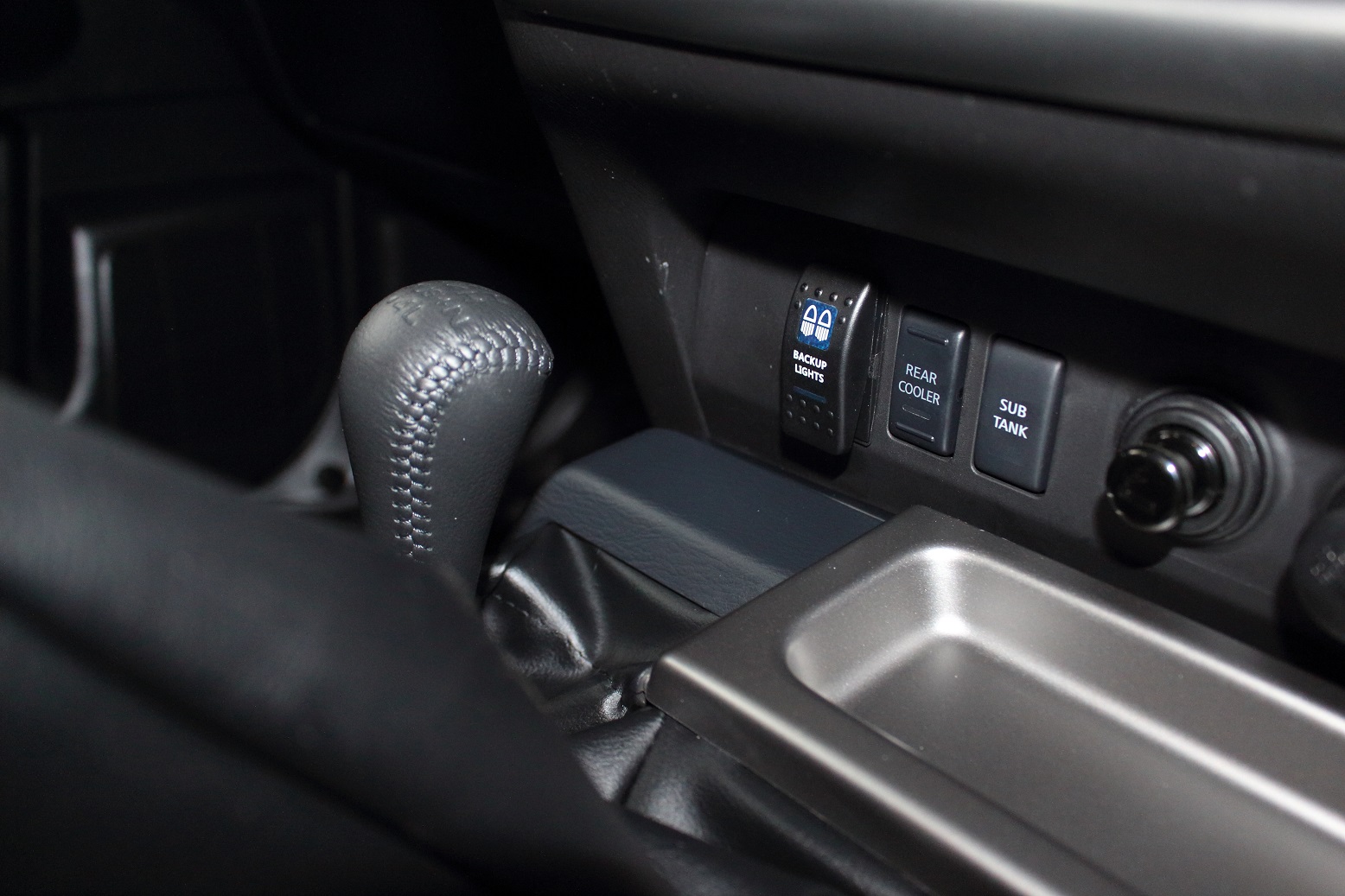

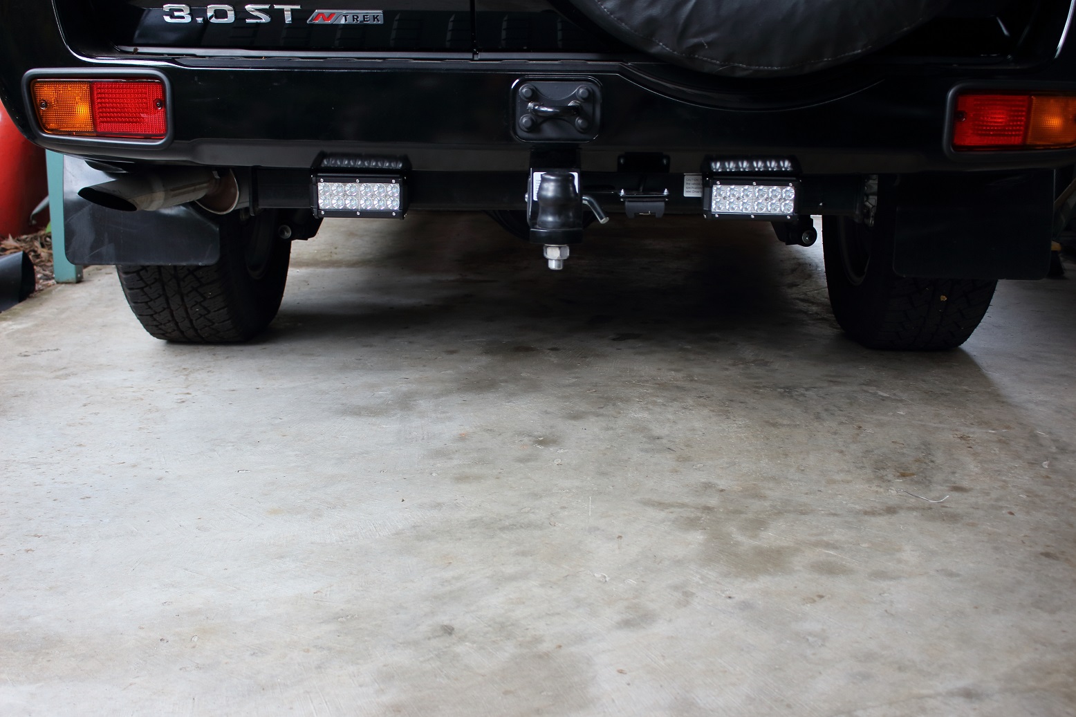

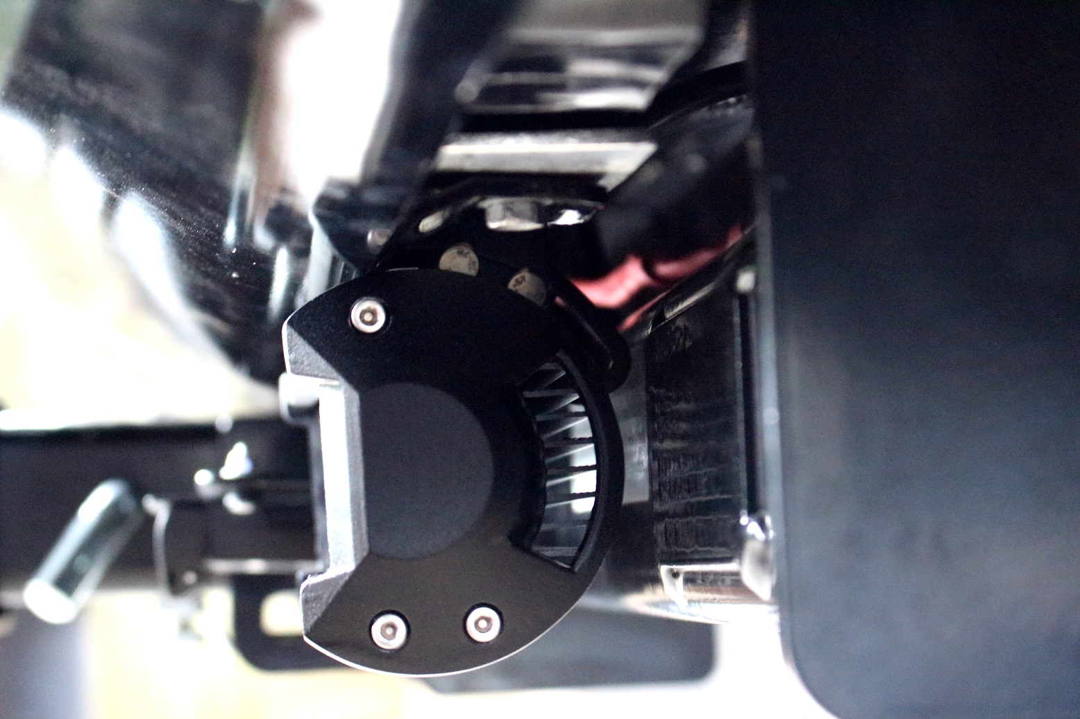

  18. Just tested those lights down our drive way very impressed. Can see easily threw window tint to the mirror, hope the neighbours don't get pissed off if some light heads there way. paul
  19. Ok costing, 1) X2 pack 7"inch 36w 60deg Flood beam, 12pcs *3w high intensity Cree Leds - Waterproof ip68. Also in the pack was rely, fusible link with fuse, & a push button switch. Got this on eBay special for $55 http://www.ebay.com.au/itm/2x-7INCH-36W-CREE-LED-WORK-LIGHT-BAR-FLOOD-OFFROAD-UTE-REVERSING-SPOT-12V-24V-/230895224211 2) Aluminium strip 40mm(wide) x 3mm(thick) x1m(long) - mitre 10 $12 3) Twin core 4mm shielded cable x 7m to reach back of car - Auto Barn $22 4) Narva switch with dim light & on light - The 12v shop $26 5) Two 8mm x 20mm brass bolt with nylon nuts and washers to mount light to bracket, I had theses. Cost around $12 6) x25 - 200mm zip ties. Was good value for money @ a Total cost = $127 I mounted the Aluminium bracket on the 2nd & 3rd bumper bar bolts from the side of the car to stay away from the x2 recovery points on the under there. Cheer paul
  20.    Rumcajs reacted to a post in a topic: What did you do to your GU today?
  21. Finished installing x2 camping lights/ reversing lights which runs threw a rely & switch. Made a bracket with a 25mm off set to raise the lights to nearly above rear toe -bar out of 40mm x 3mm aluminium about 400mm long. Screwed it up across x2 rear bumper bar screws, solid as. They shouldn't get hit on departure angle. Got some pic for you to, thanks to all that help me out in this installation to. cheers paul
