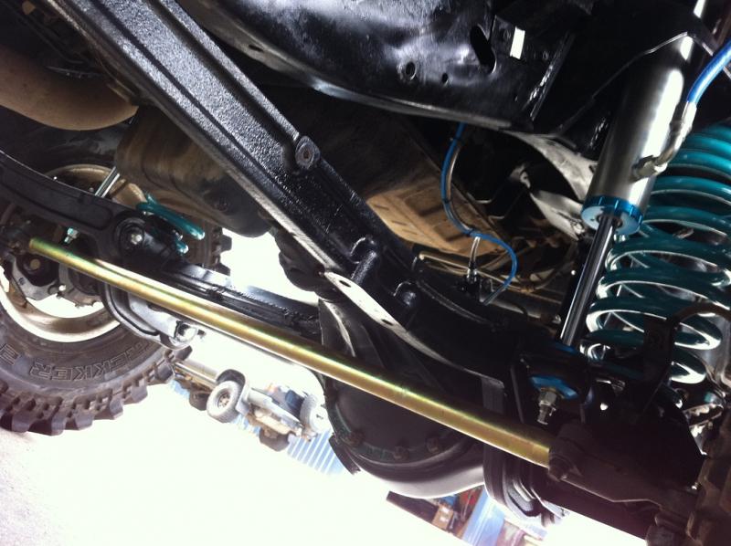

May 25, 201214 yr comment_3662 Steering draglink is the forward most rod going from your steering box to your left front swivel housing. . . rock rod is the rod on the back of the front diff connecting both the swivel housings together(keeping the wheels aligned) Report
May 25, 201214 yr comment_3666 This is a steering draglink and a rock rod. This is what they look like fitted to a car. The forward most one is the steering draglink, and the one beside it is the panhard rod. This is the rock rod, or tie-rod, whatever you like to call it. -its the rod behind the diff. Report
May 25, 201214 yr comment_3677 good timing. I just discovered today that my track/drag/tie (delete as per preference) rod (the back one) is bent. looks like some fool's dropped the car onto a rock at some stage. shame I'm the only one who drives it! Report

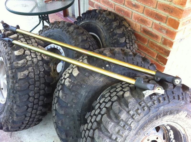

July 17, 201214 yr comment_5834 Yeah this is common problem with GQ GUs, Ive bent a few in my time as well. Because the drag link is lower then the diff the drag link gets snagged on pretty much anything. Superior engineering have made a comp spec drag link out of 4140, They are bomb proof, They retail for $375. highly recommend. Mick. Report
July 17, 201214 yr comment_5836 What happened to all the other posts here?? My 'more clearance' comment has gone after your photo of your bent rod Admin. I've got a funny feeling I've picked this up on another thread.. Or is it just me? Report
