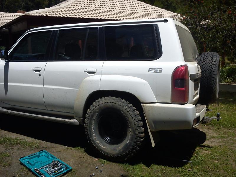

Jacket_1985 Posted May 4, 2012 Report Share Posted May 4, 2012 iv had 35's on a stock GUIV, and they are the smallest in terms of tyre clearance of all the GU's. 2inch lift was perfect for the road and 35's, so ill say 33's are the go. First pic is no lift, 2nd is 2inch. Link to comment Share on other sites More sharing options...
admin Posted May 5, 2012 Report Share Posted May 5, 2012 That pic without the lift is funny... Looks a little close. Looks awsome with the lift. I think 33's would please the wife more than 35's. Link to comment Share on other sites More sharing options...

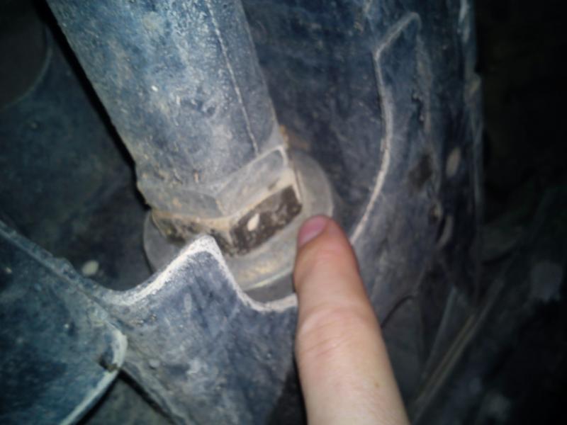

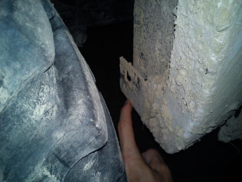

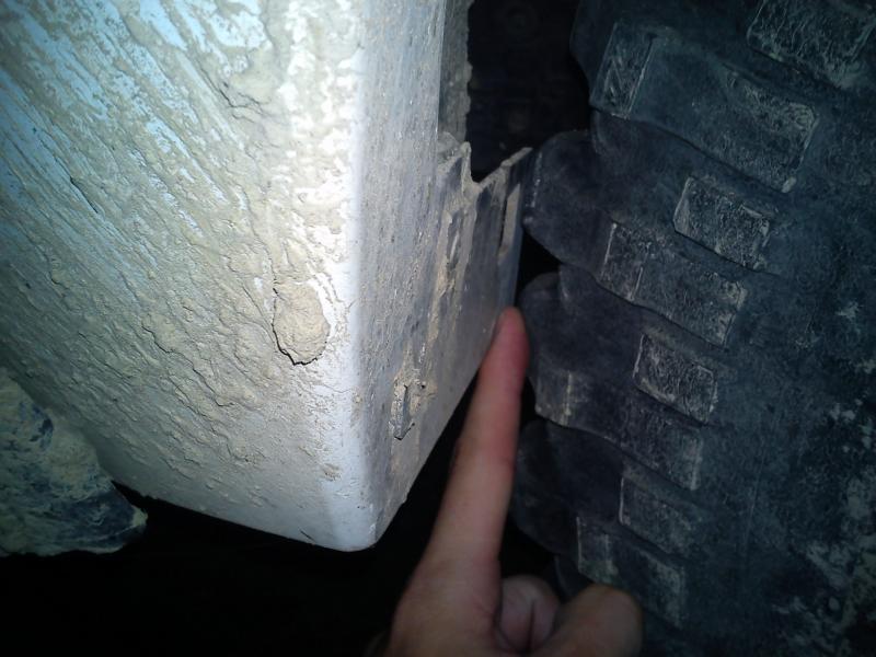

Jacket_1985 Posted May 5, 2012 Report Share Posted May 5, 2012 Do your 35s scrub out with the 2 inch lift? No. . . . but you have to space the front diff forward with radius arm spacers, remove front mudflaps, and cut a bit of plastic on the inside of your flare, but nothing cosmetically damaged, nor structural. the 35's fit like a bum in a bucket on a 2inch lift. The radius arm spacer. The bit that contacts on 3/4 lock after the mudflap is removed Wheels straight plenty of clearance. Just cut that little useless flap off the flare inside the colord' bit of your flare. Link to comment Share on other sites More sharing options...

Jacket_1985 Posted May 28, 2012 Report Share Posted May 28, 2012 Only fouling is on the front. If you have a series 3 even better. Just chuck a 20mm radius arm spacer in with your 2in lift. And running 35's will be sweet, I had 35x12.5's on the guiv. And they were BFG's so they are a fat 12.5 Link to comment Share on other sites More sharing options...
