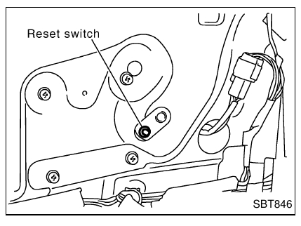

Mate, it appears you have a problem with the "interuption detection logic" aka anti-pinch function. Possibly your window winder is putting up extra resistance when cold and that causes the controller to activate the function in auto mode. Or the limit switch is dodgy. You can reset the system apparently.
 See bellow:
Quote
INTERRUPTION DETECTION FUNCTION
CPU (combined with power window main switch) monitors the power window regulator motor operation and
the power window position (full closed or other) for driver’s power window by the signals from encoder and
limit switch in front power window regulator (driver’s side).
When CPU (combined with power window main switch) detects interruption during the following close opera-
tion in the driver’s side door,
1⁄4 automatic close operation when ignition switch is in the “ON” position
1⁄4 automatic close operation during power window timer operation
1⁄4 manual close operation during power window timer operation
CPU (combined with power window main switch) controls driver’s power window regulator motor for open and
the power window will be lowered about 150 mm (5.91 in).
Quote
Front Door Limit Switch Reset (Driver side
only)
RESET CONDITIONS
After each of the following operations are performed, reset the limit
switch (with built-in motor).
1⁄4 Regulator removal and installation
1⁄4 Removal of motor from regulator
1⁄4 Operation of regulator as a single unit
1⁄4 Door glass removal and installation
1⁄4 Glass run removal and installation
RESET PROCEDURES
After installing parts, proceed as follows:
1. Close the door window completely.
2. Press the reset switch and open the door window completely.
3. Release the reset switch. After making sure the reset switch
has returned to the original position, close the door window
completely.
4. The limit switch is now reset.
CAUTION:
Be sure to manually open or close the door window. (Do not
use the automatic open-close procedures.)
Reset switch is a part of the winder.
