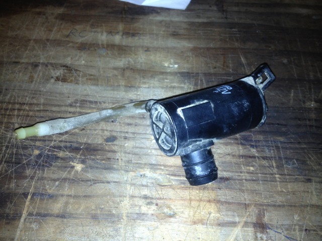

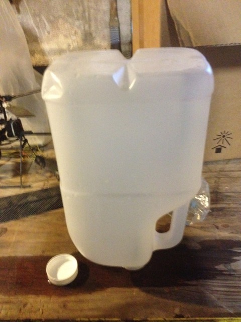

July 10, 201214 yr comment_5600 Well I'm off to the wreckers tonight to price them up. They are known to be a rip off joint so I guess I'm going to find out.. If they are I'll go eBay.. Once I have the pump I'll just be using the sprinkler system sprayer and some push together fittings and hose for the rest.. I'll start with the 3ltr milk bottle and build a nice 15-20ltr tank once I'm happy and the dual battery system is in.. Might see if I can fit it into the 1/4 panel... I'll try and photo it but I've been known to just do it, then think about photos.. Lol.. Report
July 10, 201214 yr Author comment_5603 The pump I use is a VDO one from Commodores. It's black and has the 2 push on fittings. There is another one that is black as well but it has a pickup for pushing into a bottle with a rubber grommet from memory. The couple of wereckers I have been to around here both charge $10 for these pumps as a guide for you. I have seen new pumps at supercreep for $22 so $10 would be what you would want to pay and if they ask for 30, just punch them out for being greedy Crunts. As for taking photos, I'm a photographer and it's the last thing I ever think of!! I have a few Vids at home of my veg burners I have been meaning to put on youtube. Some of them look awesome. One sounds like a rocket and is too loud to run in surburbia for long without upsetting the distant neighbours. Report
July 10, 201214 yr comment_5614 LET US SEE THEM!!!! That sounds freaking awesome... Anyway, pump and bottle bought... Eb falcon parts.. I trust a ford part over Holden any day... Lol I choose it due to the 12mm inlet. I can get a neat flush 12mm grommet for the bottle And the simple 6mm hose to the air box.. I'm going to wire in a override switch as I don't want it on at first start up untill the engine is warm.. I'm also going to put a tap in it for 100ml/ min flow.. It sounds good on paper but I'll adjust it when it's all hooked up. Going to start on a 30% blend. Just need to get some filters to filter the water threw.. Edited July 10, 201214 yr by BigGQWesty Report
July 10, 201214 yr Author comment_5628 I think the garden nozzles are 4mm if that's what you intend using. You may be able to couple them to the tube with some model aircraft silicone hose which is very pliable or heat shrink the nozzle to the tube. I think you r flow is a bit low even though I appreciate you want to be cautious. You could easily go 200 ml with no worries at all. I don't know how much difference 100 Ml would make although I suspect it would take some time to have any effect. I certainly wouldn't expect to see much if any performance improvement at that rate. The amount of extra fuel would be around 5 HP if that. Just mentioning it in case you are expecting more and are dissapointed. I'll dig up the burner vids and post them up. I bought a blower I'm waiting on that does 400 CFM@ 1 PSI. That may not sound like much pressure but you would have to see what you can get with maybe a 10/th of that to appreciate the potential Kaos. I'm not sure of the maths as I keep coming up with incredible numbers but in any case, it will generate an obscene amount of heat. I haven't Videoed the rocket Burner, I'll try that on the low pressure blower on the weekend. Report
July 10, 201214 yr comment_5630 Ok. Thanks for the heads up. 200mls/ min it is. Hopefully my weekend is free... Report
