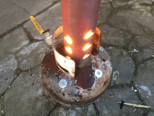

Well it ran.. A solid hour but backfiring every minute or so.. The way I look at it is with the cuts facing down it creates the turbulence you were talking about.
I will cut down the chamber (thinking 80-100mm lower) and put the main pipe to the centre and down..
Once it's going it roars... Live it..

I think you need to put more holes in the secondary section. It's roaring which is good but I think needs more constant draft through the flue.
ne thing I picked up on straight away is the crackling sound of boiling water in the oil.
Be real careful of that. If the water drops out and coagulates as it will tend to do in hot oil, If can flash to steam and create BIG flareups and like throwing water into a pan of burning oil, can spray everywhere as well.
I did this the other week. Got Some old oil slops and was burning that for a bit. I think I pumped into the water layer and when I put it in th lit burner, I heard it start to spit straight away. It hissed and bitched for about 10 Min then I heard the pops getting louder and more intense although it slowed for a bit like an animal getting ready to strike. And strike it did. A few thuds I felt through the concrete and some eruptions that pumped about a litre of half burnt veg out of the holes in the burner. The fire completely blew itself out into a still hissing but smoking, stinking mess.
Wet oil will also nor burn properly I think the energy required for the evaporation combined with the escaping steam interupt the burning process and throw everything off. Seems to in all my burners be they forced air or passive.

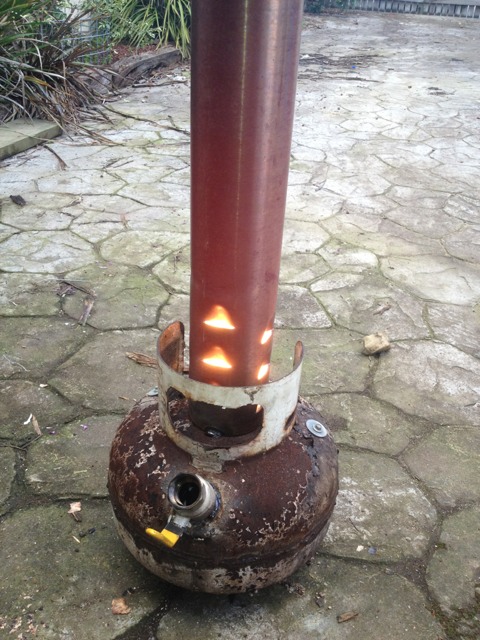

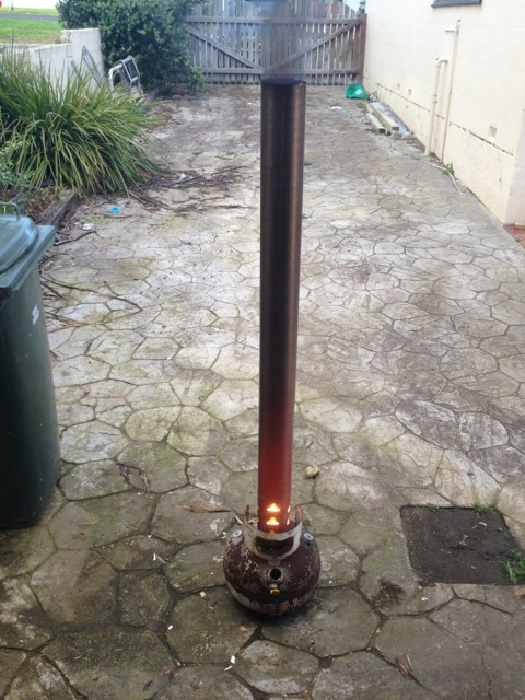

And we're glowing.. Have been fiddling with the hole pattern on the rear...
And although I found a triangle pattern works best, I can't shut it down...
It seams to be working fine with just the 1' ball valve and I can control it..
So tomorrow night I'll weld all the holes up, cut more slots in the secondary as its still smoking a bit and I have flames jumping half a foot out the top and see how we go..
Also no crackle tonight? Maybe it was the left over wash out water??

Mate, that's excellent!
As for the flame coming out the top, I have never figured that one out.
I have built a load of different burners and how to make the flame burn in the chimminey, almost no matter how long it is has escaped me.
I have studied Gas turbine burners as they work on a real short burning chamber for their output and I think you need pressurised air and a bit of a pressurised chamber as well.
If you are going to use this for a shed heater, I wouldn't worry about the extra flame. If you put a length of flue horozontally and then duct it up and out, it will be more heat transfer area to warm the shed.
Alternately, You could put another bottle on top but put a baffle in the middle to spread the flame to the outside to get more surface area again and then take the flue up. I saw that somewhere on the web some time back on a wood burner and it looked very effective. Another guy took it a step further and had a gas bottle a little way up the flue of his wood burner. He had welded in 4 3" pipes horizontally so the output from the wood burner hit and heated these tubes before going up the flue.
The guy put and electric fan behind the tubes and you could see the extra heat that would have pumped out.

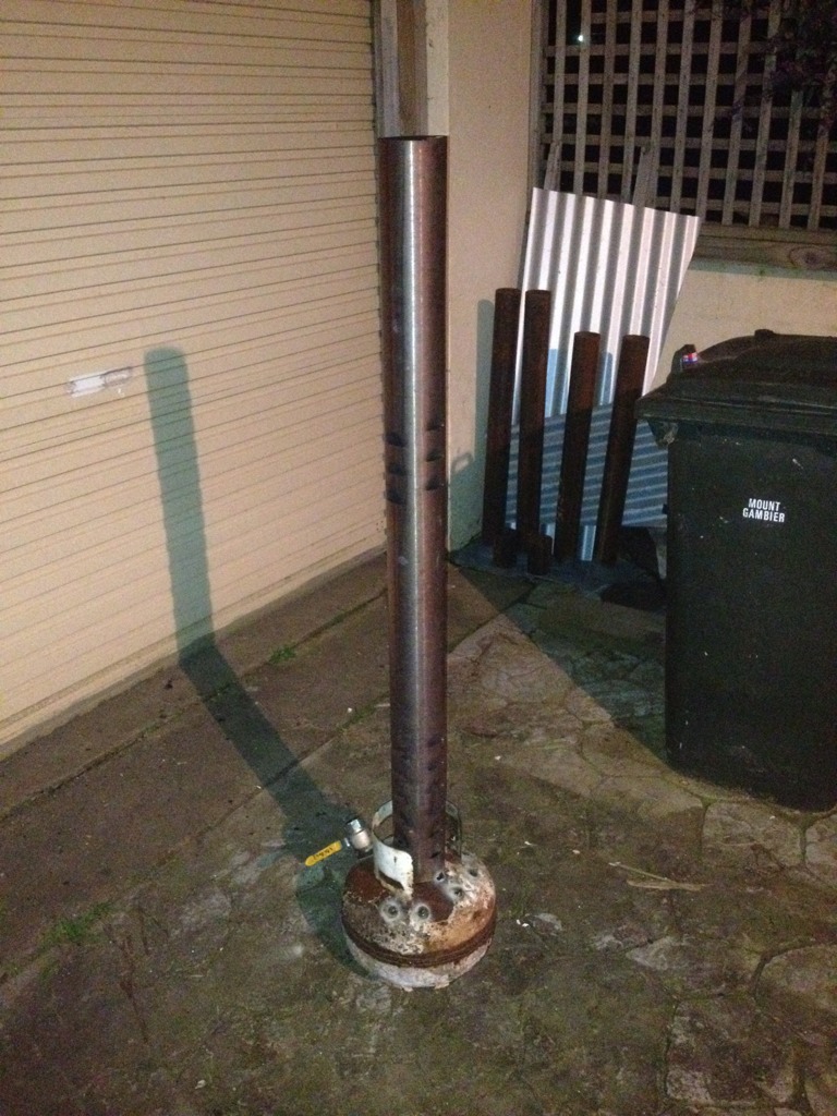

Holes have been slotted so there are double now..
And stuff it. I'll stick the tertiary burners there to.. The flu was free... Lol

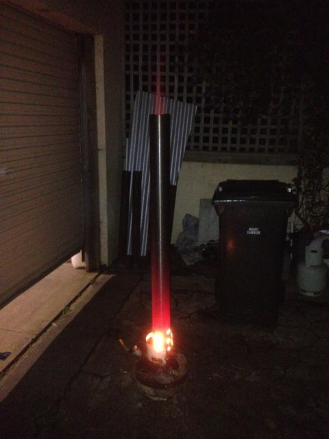

Well... FAIL....
I added double to the secondary burner and added 1/2 the secondary another 600mm up the flu. And I also welded the holes in the rear so only the ball valve is supplying air..
Well boy is it susceptible to wind.. If you fart I recon it would go out... Lol.. But it also only burnt for 15 mins and died.. And that's with a liter in it...
But while it was running it was blowing more smoke than before. But I could see the tertiary working well, the flame was reaching it but not burning past it.. So it's looking ok so far..
So I don't think my flu is the issue.. I think the primary is not burning well enough.. So I'm going to implement my next induction idea once I scorce the parts threw the rest of the week.

In the mean time, just for fun, get hold of a vaccuum cleaner and reverse it and give the thing a shot of air down the valve.
I have tired this on mine though the holes and it actually went out. On yours because of the single hole and the angle you have it, the thing may burn like mad and heat up like never before.

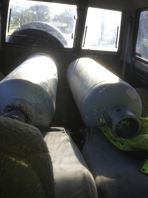

I wanted him to get me some gas bottles and old Kegs. They come in to his work and they have to set them aside till they get a heap to take away for disposal being pressure vessels.
I want the kegs to make a Retort for cracking engine oil etc but cut down a bit they would make one hell of a burner like this!

The design is simply a fire extinguisher bottle with an air inlet about 1/4 of the way up from the bottom to get the swirl effect.
On the top of the bottle. Where the flame exits I put a bit of pipe larger than the neck of the bottle to create a venturi effect. This allows air between the bottle next and the pipe and the bit of 90o bend sits on that. The over size pipe allows secondary air to get the flame to burn shorter and more completely.
Sorry I can't draw a diagram, I'm infinitely better with a camera than a pencil or brush.
I did take the thing to my mates place to heat up some drums of veg oil to boil off the water. With the thing still choked down a bit in the inlet side, We managed to bring a 44 to the boil in 17 minutes. Actually it was a little less because the oil was sitting at 110 when we looked at the time. My mate had quite a bit of old engine oil around so I threw that in and it certainly burnt well. One lot was abut 50% Biodiesel from where he had been washing out his engine and I put that with some more oil to make about a 20% Bio mix. Having it thinner and warmer allowed the fuel to run through much faster so I was able to get the thing to run pretty hard.
My mate had quite a bit of this wet slop oil and was expecting a long drawn out day of trying to dry it but was amazed at how quick we were able to get this stuff dried. At one stage we had a drum up to 120o and being a bit wary of an eruption of the water in the oil boiling all at once, we backed the thing right down. We did 3 drums of oil all up and it wasn't much trouble at all.
The burner was just aimed at the side of the drums so there was a lot more heat going to waste than was actually being put into the oil. If we had to do this regularly, we'd encase the drum itself, up the efficiency and really get the thing cooking up fast!
It was good to be able to handle and use this stuff we thought was otherwise going to be way too much time and effort. We didn't measure the fuel burn suffice to say one would want to be fitting up at least a 60 L drum rather than the 25 I was using if one were wanting to walk away from the thing for a decent amount of time.
