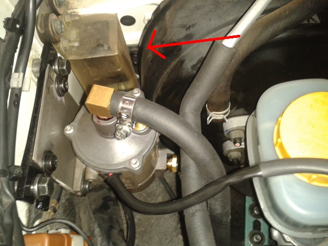

October 21, 201511 yr comment_8564 yeah... take them all forward and fit a little air filter on the ends or make a small minifold that connects all the breathers with a small filter on the other end of the manifold. A neat place to end the lines is next to the Glow plug relay Report
October 21, 201511 yr comment_8567 Good question!!...... hahaha..... On the TD42's, it's at the back corner of the engine bay on the drivers side, between the brake booster and the fender. Report
October 21, 201511 yr Author comment_8568 Since this used to be a zd30 where would the unit on one of those be? just in case... Report
October 21, 201511 yr comment_8569 Glow relay on ZD30 is in RH corner of the bulkhead and the inner side fender underneath near where bonnet strut is mounted. It is covered with plastic white cover right next to brake booster....Basically same spot as Ricster described.Cheers Edited October 21, 201511 yr by Rumcajs Report
