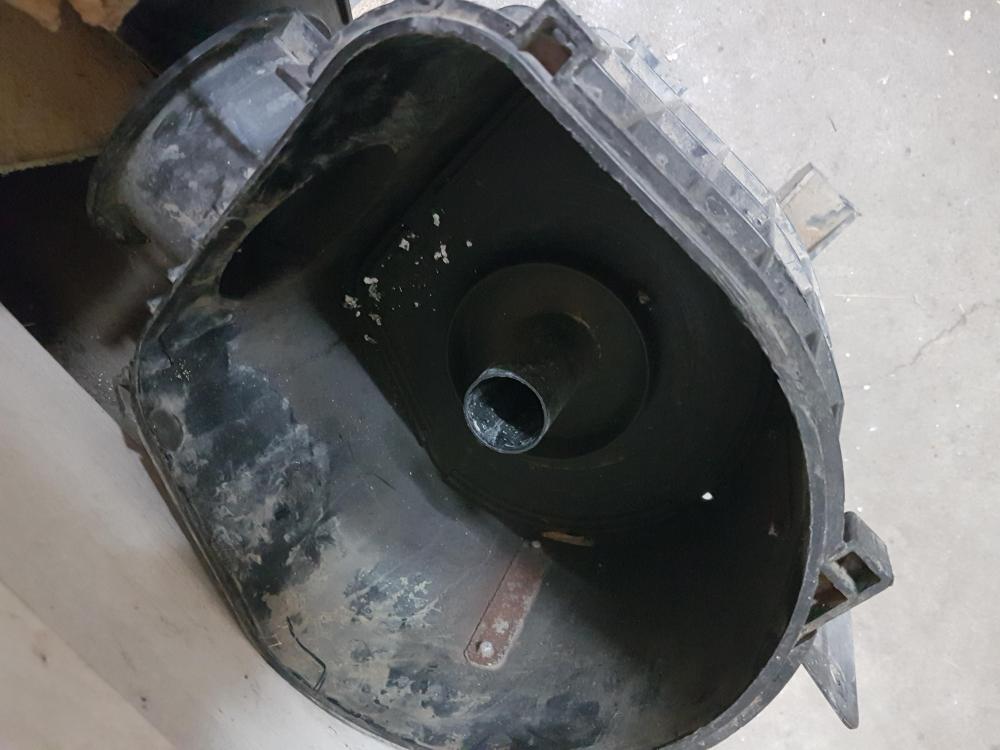

skid Posted May 6, 2016 Report Share Posted May 6, 2016 Dumb question but when replacing the air filter for the first time since I got the car last year, I notice that there is a tube in the middle of it which seems to go no where, What is its purpose? Do I need to block it off for my snorkel properly? Thank in advance Link to comment Share on other sites More sharing options...
Rumcajs Posted May 6, 2016 Report Share Posted May 6, 2016 Pics? Link to comment Share on other sites More sharing options...
ricster Posted May 6, 2016 Report Share Posted May 6, 2016 is it not a water outlet.... or am I barking up the wrong tree.... Are you talking about the filter itself or the air box? Hey I have blonde hair.... that's my excuse and I'm sticking to it.....hahahaha Link to comment Share on other sites More sharing options...
skid Posted May 6, 2016 Author Report Share Posted May 6, 2016 Its part of the box, right in the center, the filter goes around it... Link to comment Share on other sites More sharing options...
skid Posted May 7, 2016 Author Report Share Posted May 7, 2016 The bit in the center.... Link to comment Share on other sites More sharing options...
Rumcajs Posted May 8, 2016 Report Share Posted May 8, 2016 (edited) That's to centre the filter I suppose, mine looks different but it has something similar to the lower section without that tube extending upwards, perhaps earlier design. Also the lower lip is to act as a barrier should the water get inside the filter box hence the drain hole outside of it. Many people mistakenly block it and then face the consequences, although jury is still out in regards to it. Regards Edited May 8, 2016 by Rumcajs skid 1 Link to comment Share on other sites More sharing options...
Lost-Benji Posted May 9, 2016 Report Share Posted May 9, 2016 The drain is the small hole seen there opposite the air intake port (no one-way valve either, long swims will end badly). The centre stork has an acoustic chamber under the airbox to help (apparently) the greenies sleep better. Link to comment Share on other sites More sharing options...
