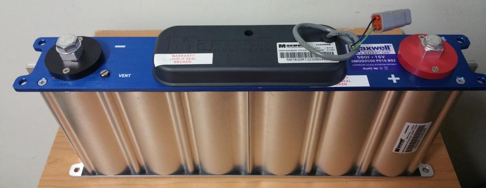

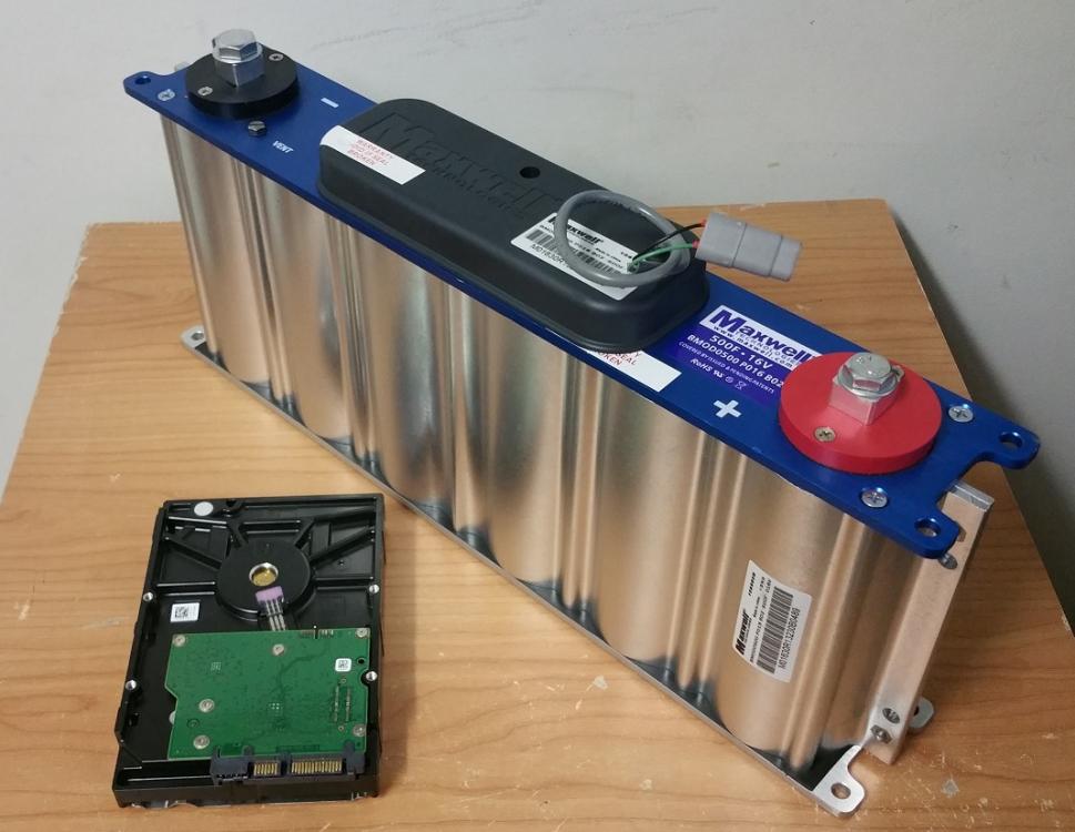

  6. That sucker holds the effective cranking power of a 1000CCA battery yet weights roughly 5 kilos. So I will have it sitting in where most would put a 35 kilo battery on turbo side of donk, will replace the cranking battery with deep-cycle battery. I can now crank the motor with very little Vdroop (voltage stays high rather than dropping low meaning slower and harder starts) while not having the extra weight. Jump on Youtube and watch some videos on the Maxwell caps or "Ultracapacitors"
  7. A new toy arrived today. 500 Farads @ 16V Seen here with e 3.5" HDD sitting in first shot for size comparison.

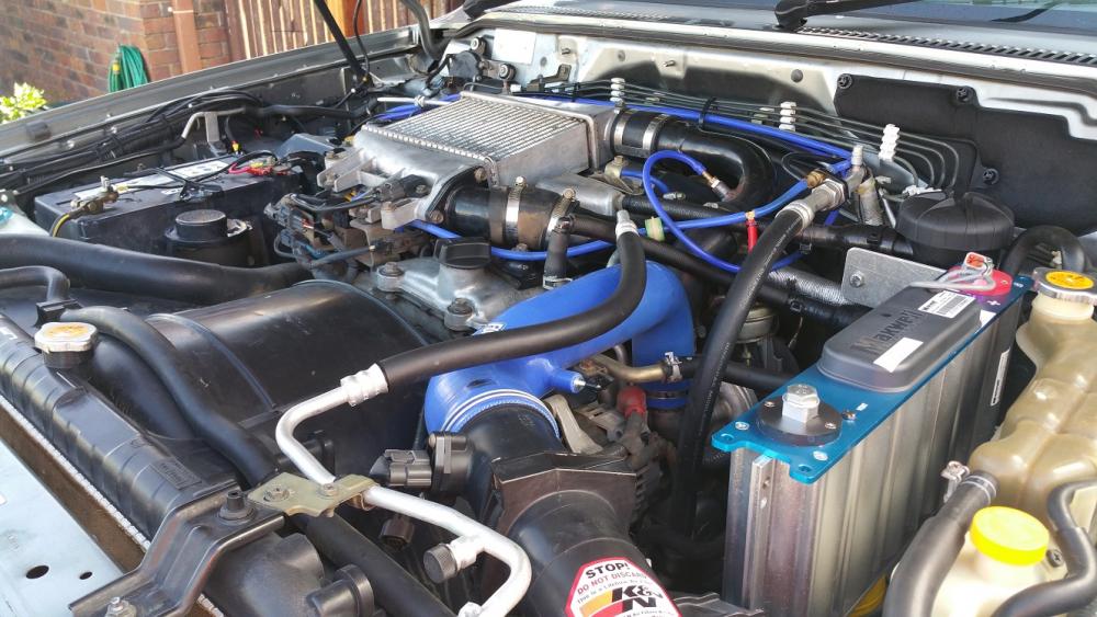

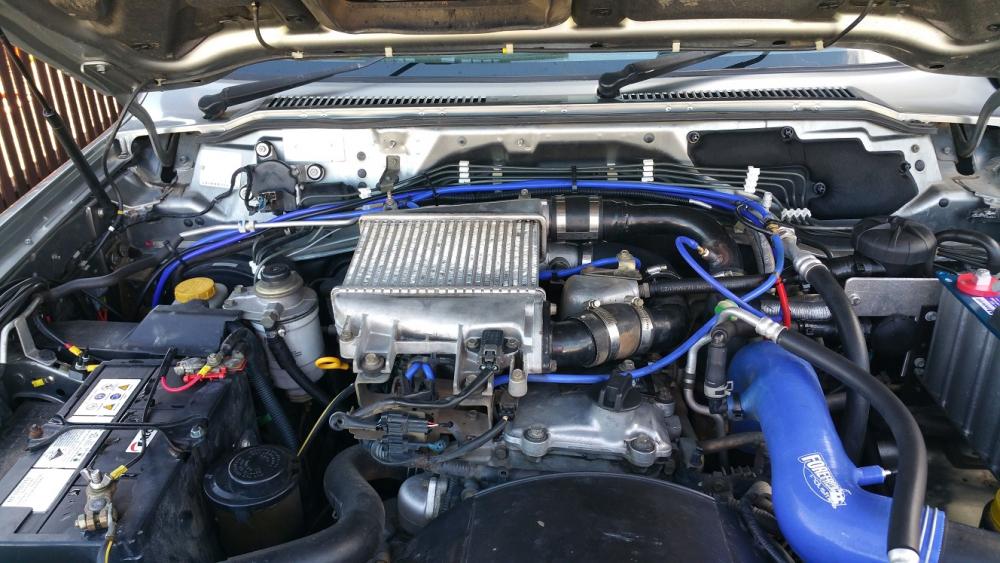

  13. So here is my little rundown on the daily drive. The basics: 2004 GU ST-L Wagon ZD30 (270K+ on the dial) 5 speed man. 32.5" Michy boots The Under-Bonnet Mods: K&N filter Molded Silicon Induction tube (Air-box to Turbo) ProVent 200 Oil catch can Dawes Valve set at 17PSI Bleed Valve mounted in cabin just under handbrake lever 3" Turbo back Exhaust - Stainless muffler, No CAT (found HERE) EGR blocked Boost & Pyro gauges Extras: UHF Radio (Uniden POS, Simoco or Icom on way) Factory Steel winch bar RFI CDQ5000 & CDQ2195 antennas plus FM band whip on bar 2x 7" 100W HID spot lights 1x 100W Spot/flood LED light-bar (on top of bar) 2" lift coils 2" lift Dobinson Shocks Return to Center Dampener Whats on-way or planned mods: 16V 500 Farad capacitor unit (Maxwell) to augment a large, single deep-cycle battery, ON-WAY ARRIVED Boost controlled VNT actuator (Vacuum + Dawes + Bleed valve going), ON-WAY ARRIVED Simoco or Icom radios, PLANNED Larger, fan forced intercooler, PLANNED Rebuild of another ZD30 with stronger guts, PLANNED 35" Boots when others are due to be replaced, PLANNED Water-Meth injection, Post Turbo, PLANNED Clean out entire induction system tract, PLANNED ECU mods, way-off planning there Taller 5th gear, POSSIBLE So, the GU is no virgin, but she hands out a spanking when needed. The beast will happily sit in 5th gear @ 50+Kph and be able to pull all the way to 120Kph. Usable boost is @ 1000RPM, 12PSI @ 1500RPM, full boost (19PSI, I know what I said about the Dawes setting of 17PSI) @ 1750RPM. I get around 10.5L / 100 and EGT's sit on 190°-210° town driving and 280°-300° on highway @ 100-110Kph. EGT's rise to 480° when pushing up 10% grade with full tanks, tools in back while still holding 100+Kph. The Ultra-capacitor will be mounted on passenger side (where second battery normally goes) and be connected to main battery via 2-guage cables with 500A fuse. These suckers can dump Mega-Amps of current in milliseconds (hence fuse). This will enable the vehicle to have instant current with little or no sag while allowing me to swap the cranking battery for a Deep-Cycle battery. The biggest Bitch: The crappy diff-gears. I need shorter gears or a taller 5th (considering it too). 35's will help here soon. Make no mistake, this ride is my daily drive where I do a lot of highway work. Very little 4WD action until I get a project car.
