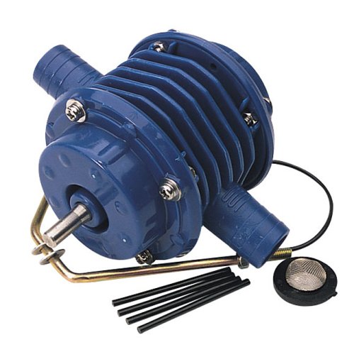

As for the pump pictured above, They are not reported to be very good on veg. They tend to burn out very quick due to the wiring to the brushes in the motor overheating due to the extra load the viscosity of the oil creates over water or diesel they were designed to pump.

A number of people in the states use these pumps but most tend to use the original ports or at least one of them which are far too small for max flow the pumps are capeable of. They also drive them with cordless drills which are lucky to get much over 500 RPM so flow rates are appropriately poor. To get the things really working they have to be opened up and larger fittings used.
Being gear pumps these things are positive displacement so cannot be closed off at the input or the output. When blocked on the output side the things will pressurise up till either the motor stalls or the hose bursts. The latter in my experience is more common. The upside is I have pumped ats so thick they extruded out of the hose and held their sausage like shape for a good 5 min before I wiped the stuff away. I don['t normally collect fats but they are good for my mate who makes Bio.
The yanks have a number of rather expensive pumps sold for veg collection but even mains powered ones barely if at all eclipse the Chev pump output and are always heaps more bulky and cost min 5 times more.
If using a water type pump, always go for ones with large impellers. Technically these are called centrifugal pumps and the ones with the small impeller housings are called Turbo pumps. To tell the difference, the centrifugal pump will have an impeller LARGER then the electric motor and a turbo pump will have an impeller SMALLER than the motor.
The small rotors simply can't get enough " Bite" on the oil to flow it successfullt where the larger impellers bite very well.

Centrifugal Type pump.
Turbo Type Pump.
Drill Pump, the type GOOD for oil. ( never seen them in blue before!)
Drill Pump. The USELESS for ANYTHING type.
