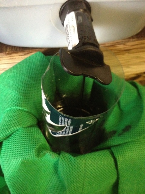

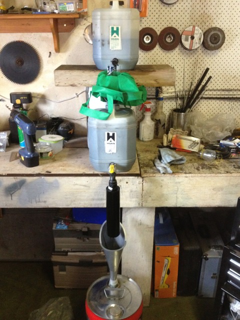

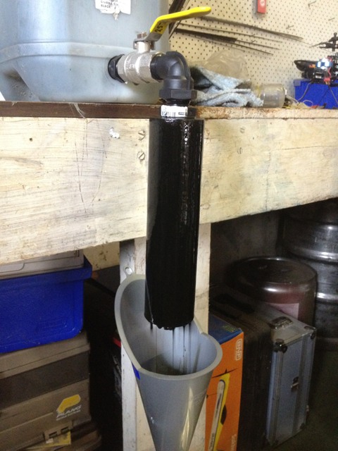

It's settled for 2 weeks in the 44.. Pulled 20L off the top and into the top container.
That's trickling into the shopping bag filter with 20 rare earth magnets in it.. (f-ing strong. Each has a 3kg pulling power..)
Then into the next bottle and threw a 1 micron poly woven filter..
And into a clean holding drum ready for use.
Going to start at 25%.
