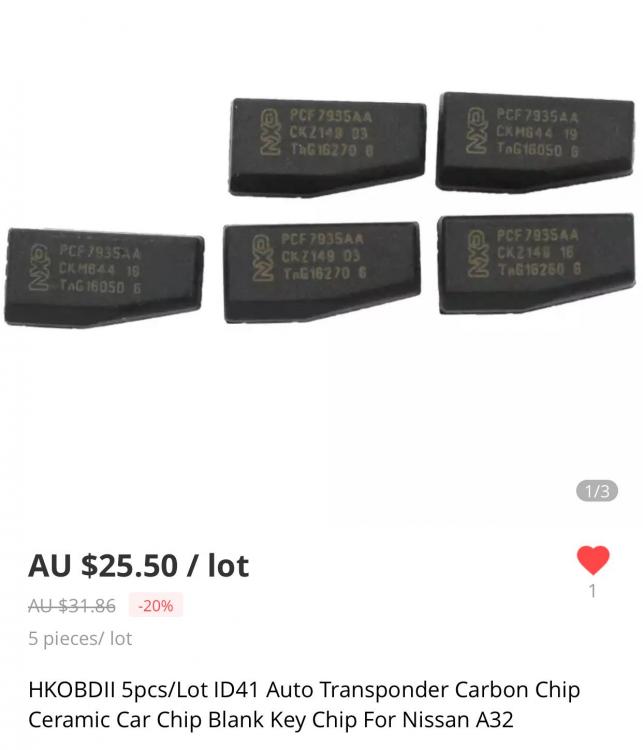

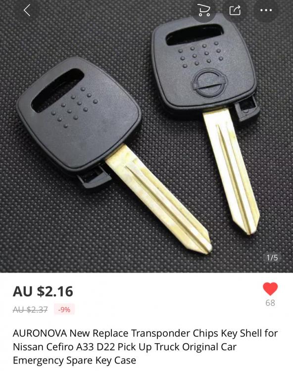

August 7, 20197 yr comment_9631 Hi guys I have a Nissan gu y61 2000 model yesterday I programmed two keys to it by my self I brought ( id41 chips ) and a few Nissan keys i then used the computer I brought to add the keys to the immobiliser it took about 60 seconds to add two keys . Edited August 7, 20197 yr by James1 To add photos Report
April 25, 20224 yr comment_11663 Hi James1, This thread is old I know, but I would love to know what you used to talk to immobiliser and make it accept new keys. Regards Jo Report
