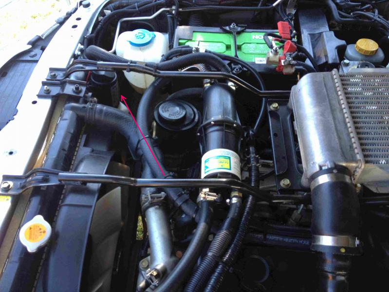

May 7, 201313 yr comment_7253 P.S Thanks to RCA at Wyoming for the install. They did a good job, nice and neat and the hose connectors are awsome. Where did they end up putting your flow jet pump in your install? Report
May 8, 201313 yr Author comment_7254 You can see it in the last picture (in the post with the install pics on page 1).. Its a little hidden, but you can see it next to the water bottle and to the left of the radiator (drivers side) Edited May 8, 201313 yr by admin added pic with arrow to pump Report
May 8, 201313 yr comment_7255 You can see it in the last picture (in the post with the install pics on page 1).. Its a little hidden, but you can see it next to the water bottle and to the left of the radiator (drivers side) Ah nice. Cheers for that. Didn't see it on the first look..unfortunately I have a big PWR radiator, it may not like it. Ill look tomorrow... Report
May 9, 201313 yr Author comment_7257 Its tight in their... If your radiator is wider, it will probably not fit.. Other option is behind bull bar somewhere. The current location is good because its out of the weather/rocks etc but it would get a bit of heat.. Im not sure whats worse. Report
