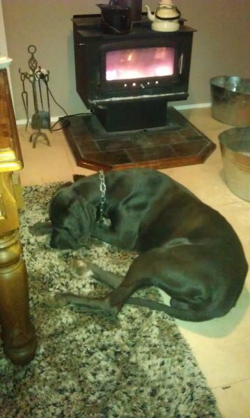

June 6, 201214 yr comment_4499 With the carbon tax to stab us in the neck on 1 July, electricity and gas prices are going to cost more in a year than a night out with Craig Thompson on your credit card. So today, we finally had a wood fireplace installed to replace our gas, mock wood, fireplace. A 45kg gas bottle was lasting about a week or so, at the fire's lowest setting and run for no more than 4 hours a day, and costing us $127 a refill. We were going broke just trying to keep warm. It just makes one wonder, the more we have advanced technologically in the last 200+ years, the more we now seem to be regressing to what was the norm 200+ years ago. Cheers Ray Edited June 6, 201214 yr by Ray! Report

June 7, 201214 yr Author comment_4535 I wish the price of a 45kg gas bottle was $90 delivered, here it's $127. The wood fire is working brilliantly, keeping the entire house at a nice temperature; a bit warmer in the lounge, but the heat is permeating nicely into the other rooms as well. Drawing the curtains makes an enormous difference to heat retention, as one would expect. The only annoying thing with today's wood heaters is that because of some EPA regulations you can't, by default, close down the flue so that at night the wood goes into a very slow burn. Kind of stupid really, when the solution to that is all too easy. I closed the flue to its lowest setting last night and the fire was completey out by the morning. Part of this was probably due to the type of wood (gum, but not red gum), but also because too much air was moving through the heater box. Remedies are required. Another thing I found out when I went looking for fireplaces is that many manufacturers are now offering cast iron plates in lieu of fire bricks, as they apparently retain heat better and thus provide better performance. I'm not sure about that, but if it turns out to be true, rather than getting those 'specially' made cast iron plates, which I didn't even ask how much they cost, I might get some proper 20mm mild steel plate, cut to size, and use that instead of the firebricks. The cast iron plates were only about a third the thickness of the firebricks, so a big lump of steel should work a lot better. Anyway, things are nice and warm, even if the chimney is smoking like a 4.2. Cheers Ray Report
