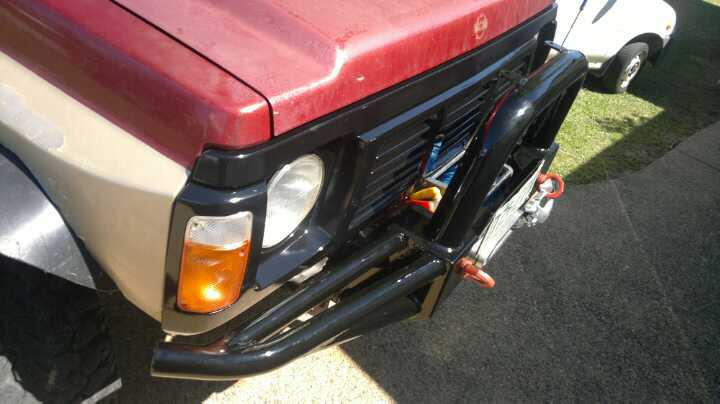

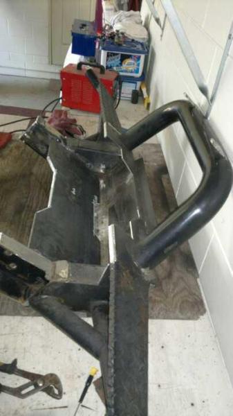

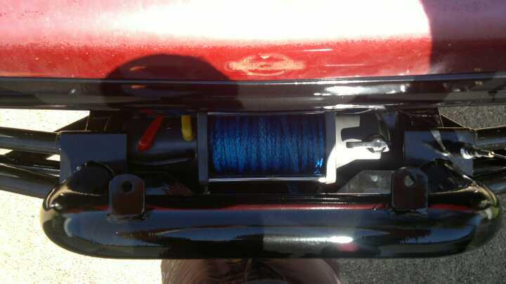

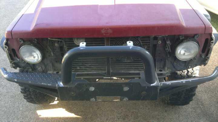

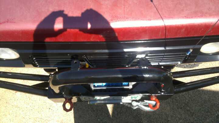

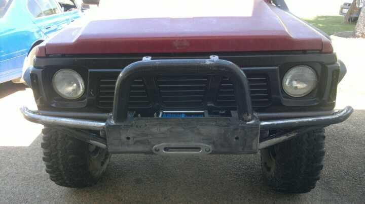

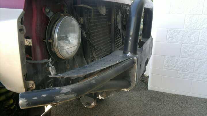

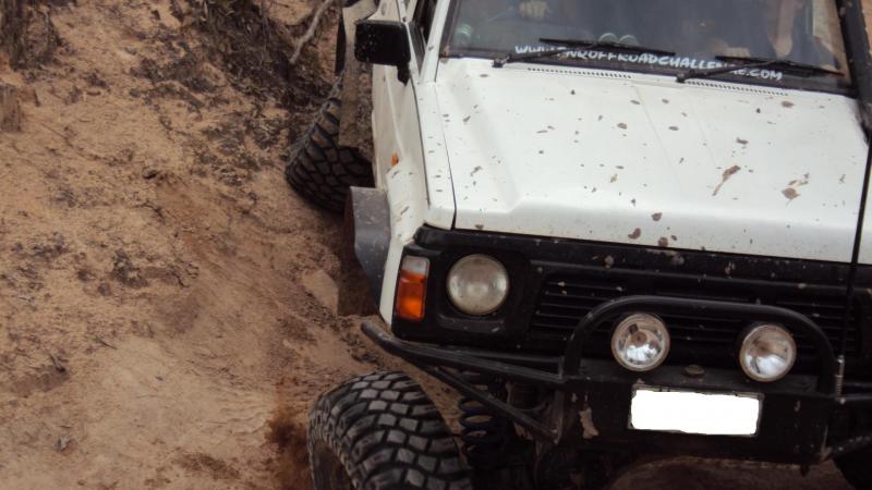

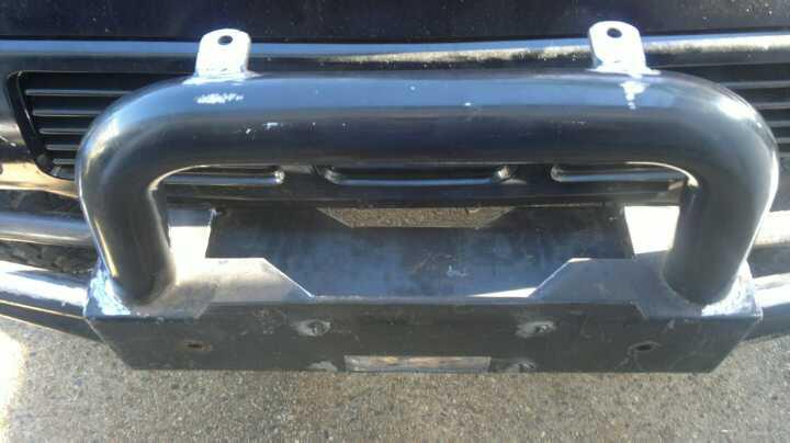

I've had this winch laying around for ages, I thought it was time to put it in.

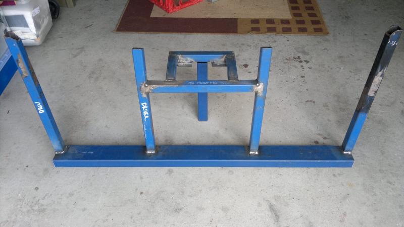

The winch is a low mount 12000 pound and my bar is a cheesy high mount so it had to be modded..

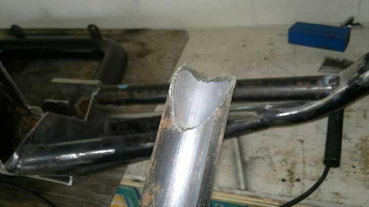

I found that under the wings of the bar were rusting out so off they went.
New tube wings and top of bar cut to suit.post-176-0-42859900-1344916209_thumb.jpgpost-176-0-26438000-1344916225_thumb.jpg

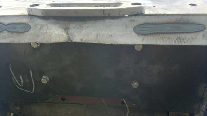

I cut some 10mm plate for the base. Tacked in place.post-176-0-85346000-1344916326_thumb.jpgpost-176-0-22214100-1344915918_thumb.jpgpost-176-0-60393400-1344916680_thumb.jpgpost-176-0-28578100-1344916710_thumb.jpg
A quick test run for the winch to make sure everything still fits then all to be welded up. post-176-0-14716200-1344916814_thumb.jpgpost-176-0-99192000-1344915974_thumb.jpg
Then painted.post-176-0-72794200-1344917074_thumb.jpgpost-176-0-94908500-1344917093_thumb.jpgpost-176-0-04395700-1344917114_thumb.jpg
I tested up the hill on the week end and pretty happy happy with it.

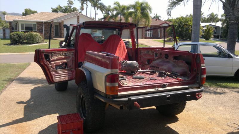

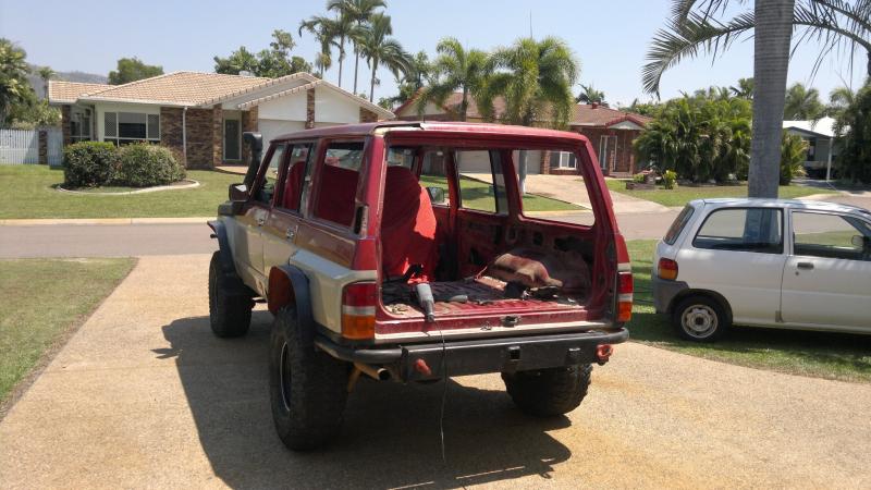

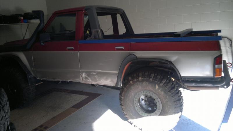

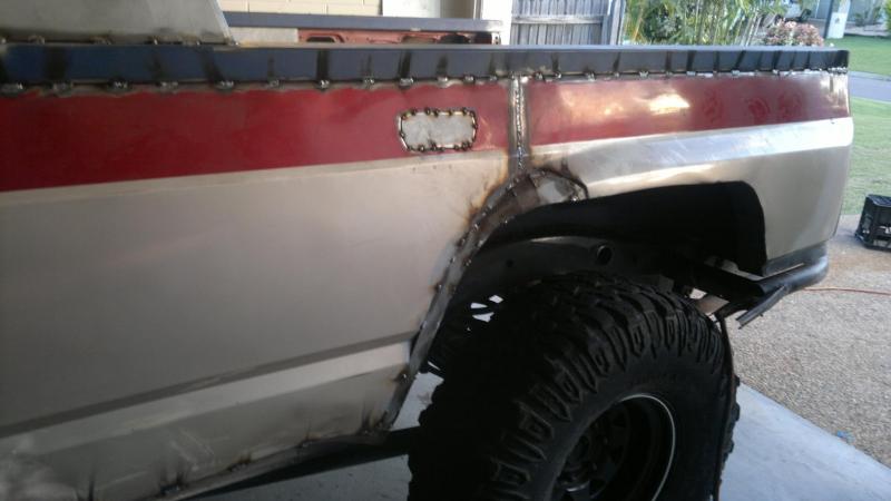

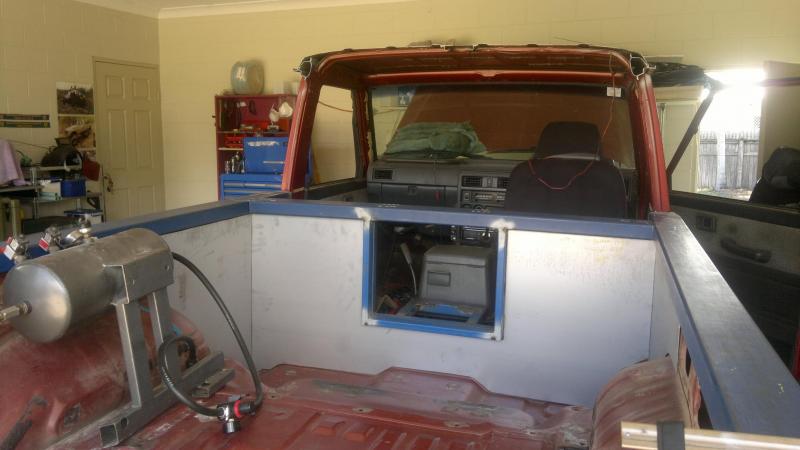

Ok here is what i have been up to pictures speak louder then words.
So i thought i wanted to try something different so we will see how it turns out.
Let me know what you think.
More pictures to come as get it done.

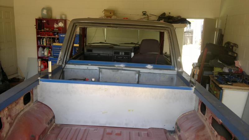

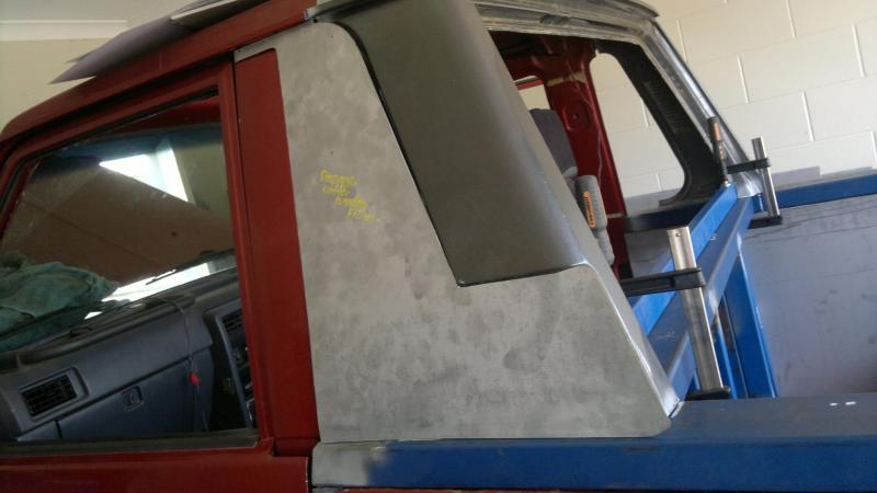

The floor pan what do you mean? The rear tub ? If that's what you mean it will be storage and sheet the top in so it acts like a flat tray on top and storage under neith.
hope I answered your question..

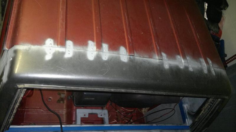

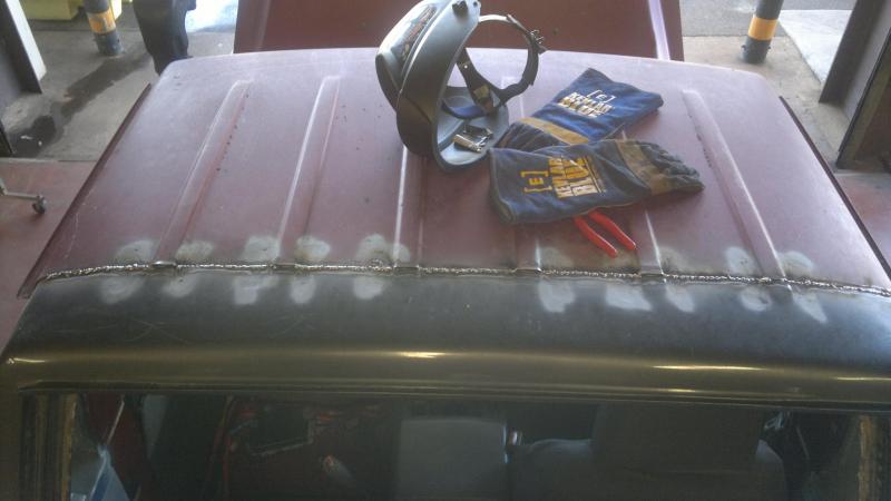

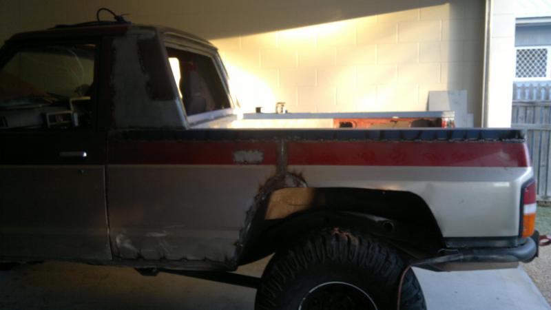

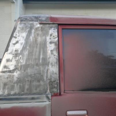

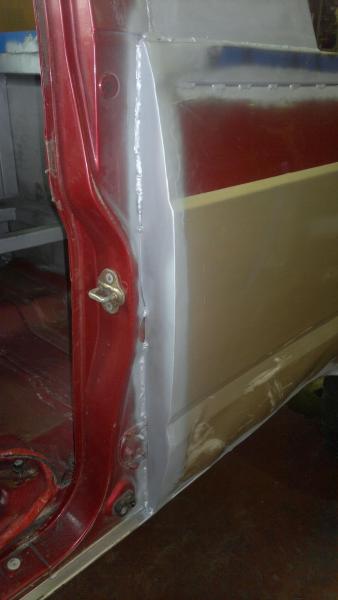

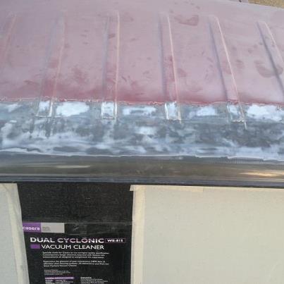

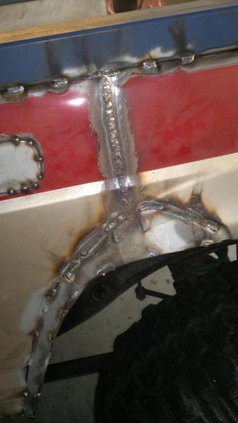

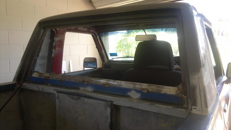

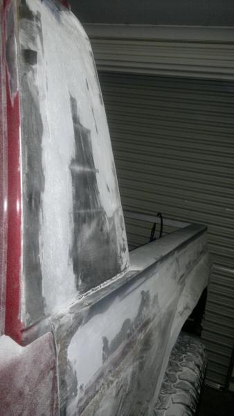

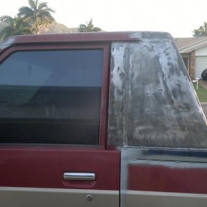

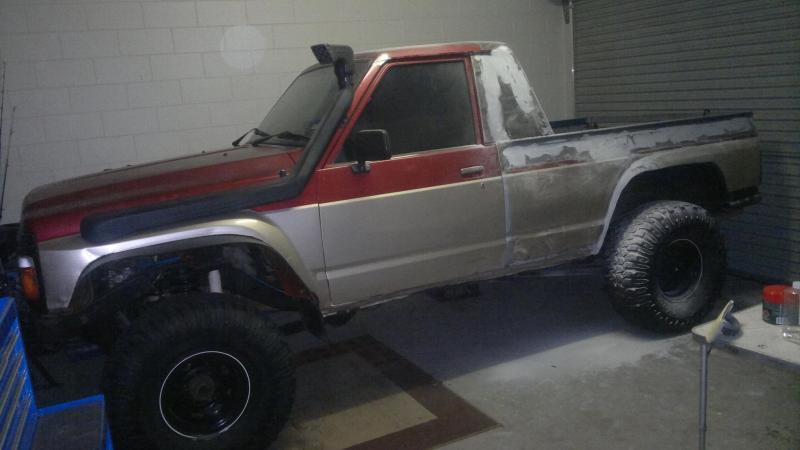

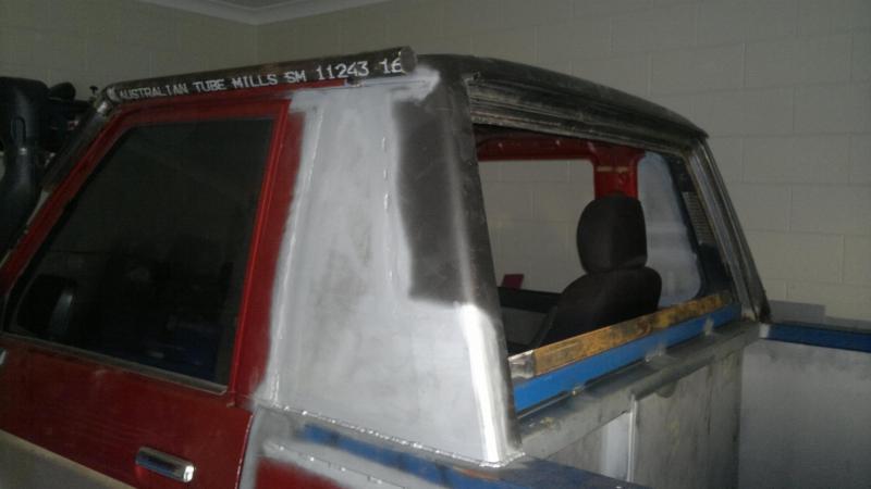

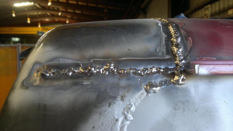

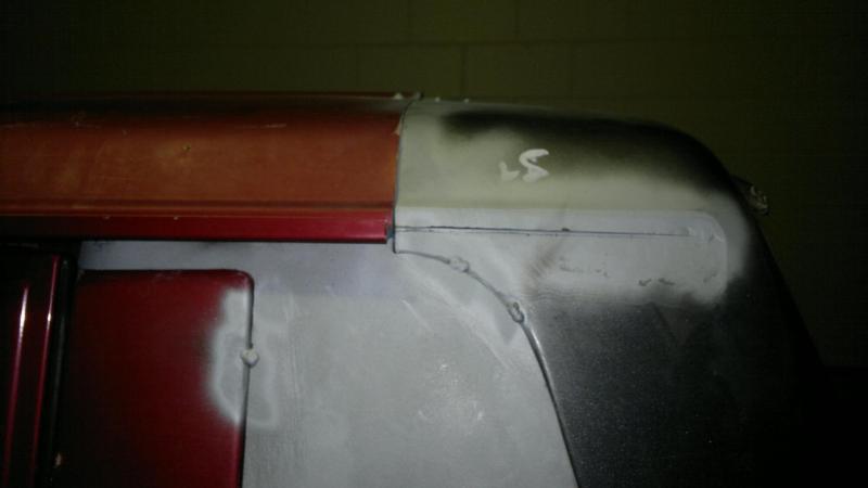

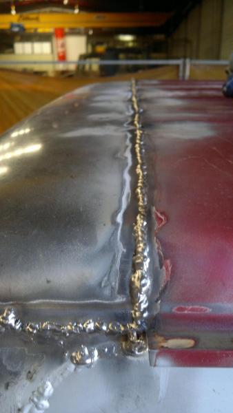

Got some more done today got the roof welded up with out warping it ( was pretty worried about it warping being so thin ) but come up awesome, Now a have something to work with here some pics.
This should clean up really well, a bit more welding then bog time.
Edited by tailpipez
Top job. Yea I was asking about the tub. Didn't know what your plan was for that 4" step behind the rear seats.. Top effort on the welding to get no buckles.. just be cautious when grinding down that you don't take out the parent metal.. if I was you I'd try get a large flat buffer and put a course paper on it, once you've removed most of the weld, finish it by paper then bog.. Kallen Westbrook Owner of Westy's Accessories

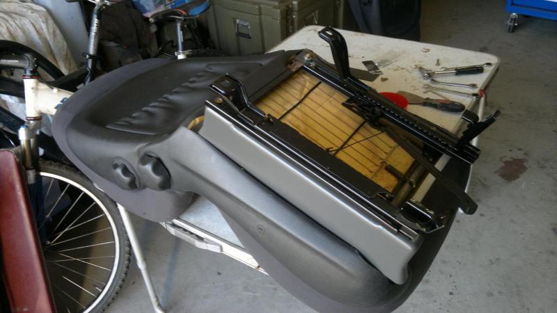

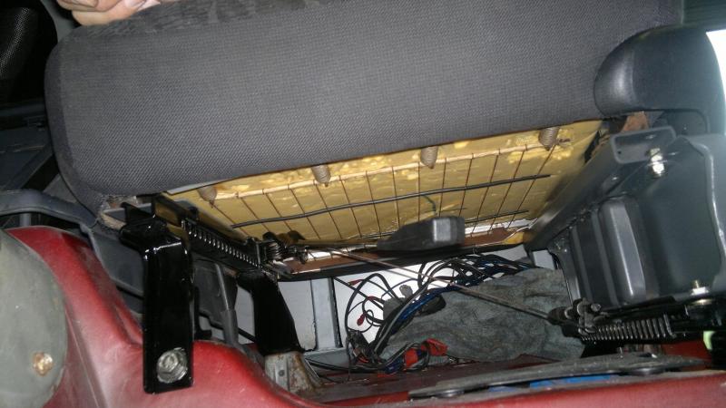

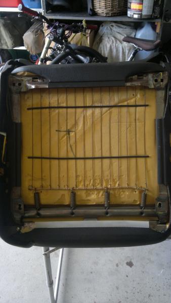

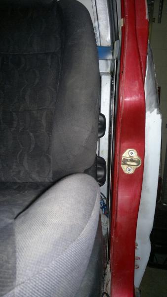

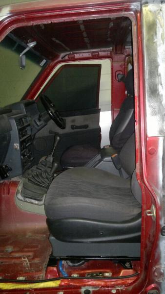

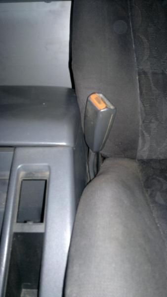

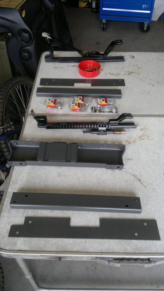

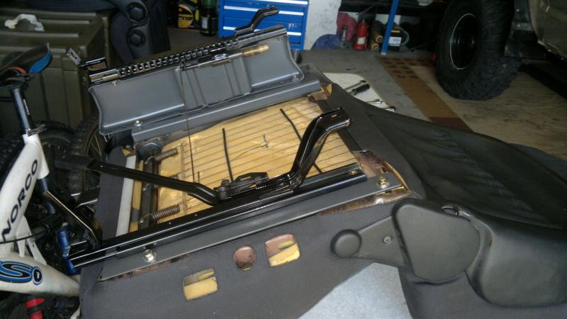

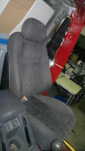

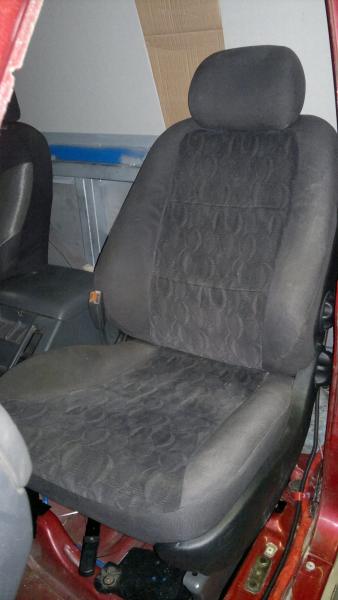

Ok I thought this seats were a straight bolt in from what i have read.They were close but not close enough. I started by re drilling 2 new holes in each seat.
Made brackets to mate up to the rails.
 Brackets all fitted up and painted.
All fitted up in the truck one side any way.
Bit of a tight fit bit all in all turn out ok.
