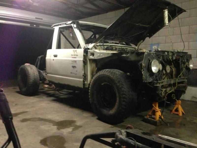

  4. its came out very nice in the end, he last two days iv almost been late for work catching up on the zzzzz's still lol

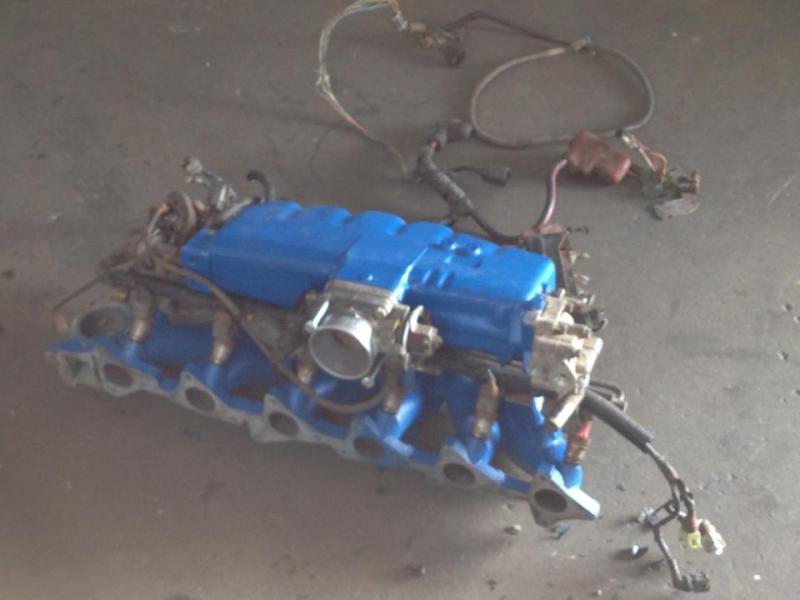

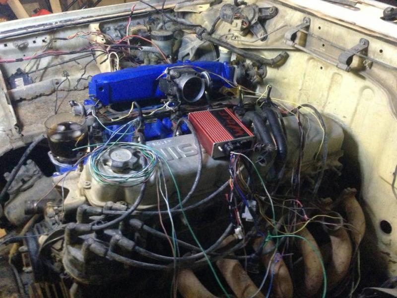

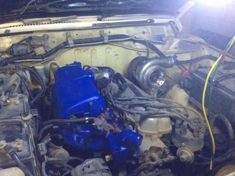

  5. Standard tb42e manifold for now will eventaully make a forward facing intake plenum with 80mm v8 throttle body

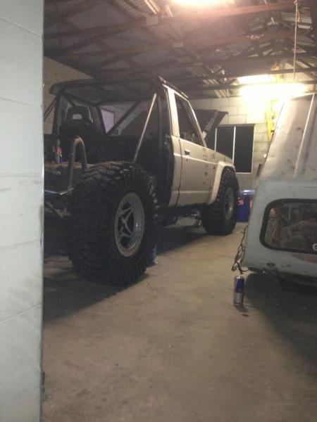

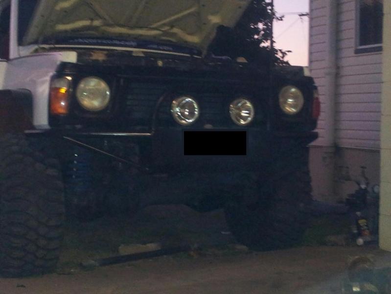

  7. Some pictures of the truck how she sits and some of her good bits

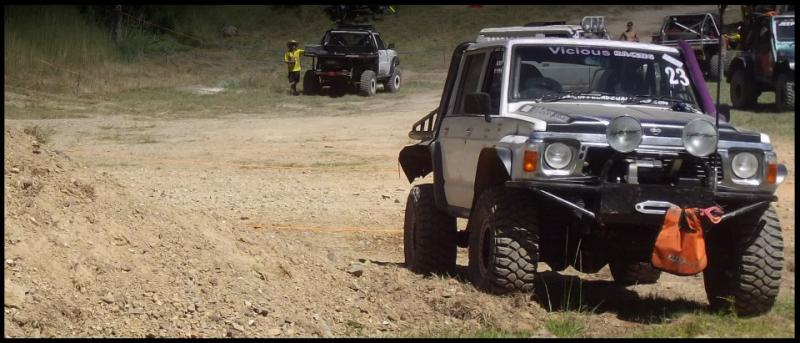

  8. Few more pictures from our race weekend

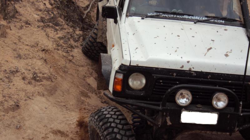

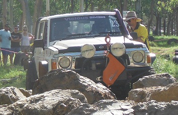

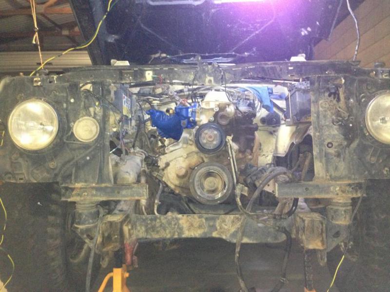

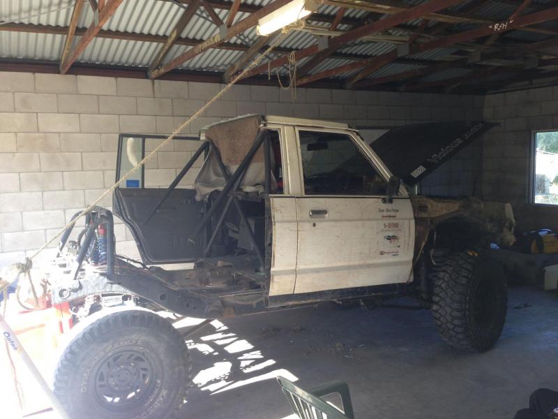

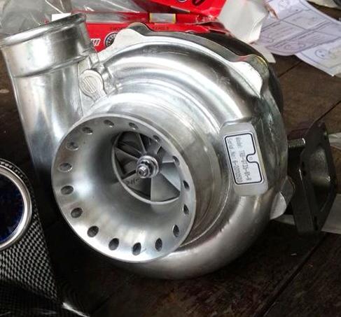

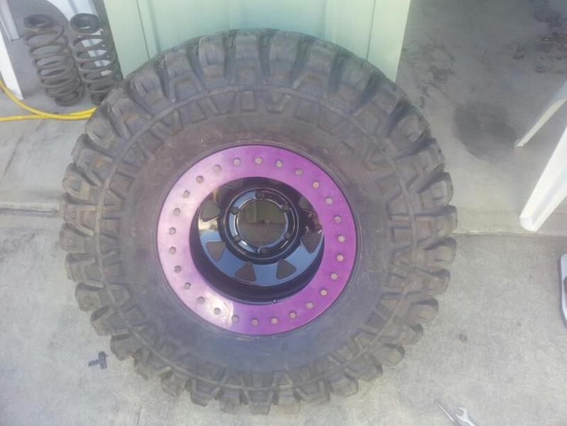

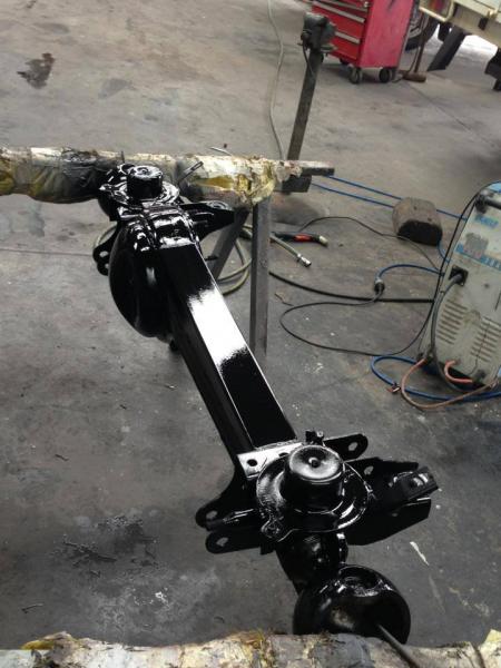

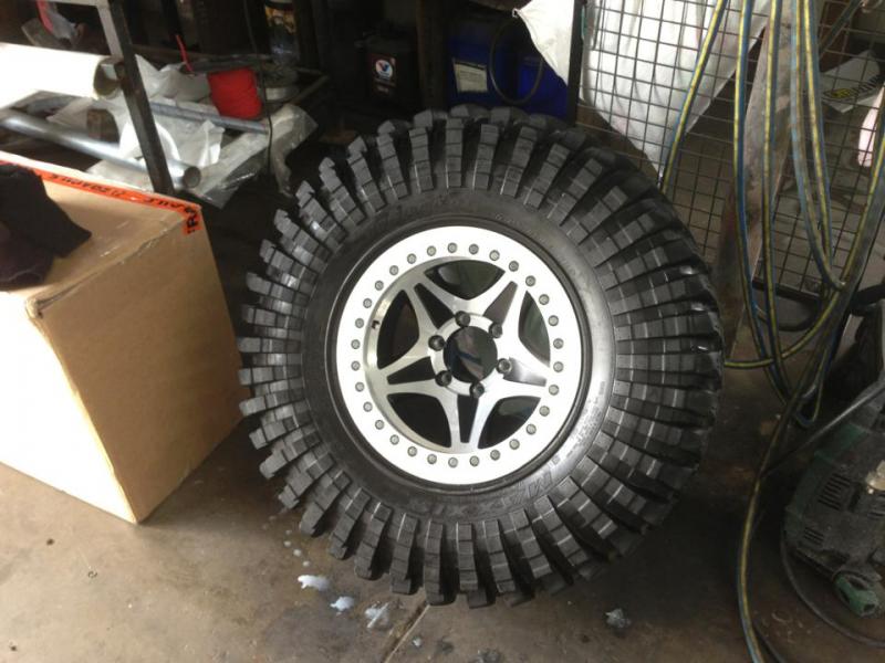

  9. Hey Fellas been a long time thought id update my section here for any one who may be interested, well since the coilovers iv done a double tri rear end which worked really well went on to beadlocked rims caged ect ect and competed in the Mackay Offraod Challenge this year to place 4th, was pretty happy about that but was pretty bummed that we lacked power all in all a great weekend we had down at Cathu where the comp was held since then sold the coilovers and everything under the front 5 link coils shocks ect went to some 37" treps, 17" beadlocked Savanna's, doing an efi turbo upgrade cage is getting more work chassis has been chopped inner guards getting worked for coilovers alot of custom sh1t taking place.

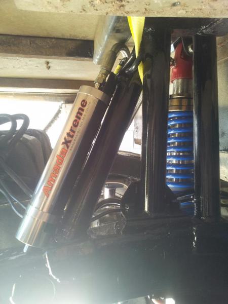

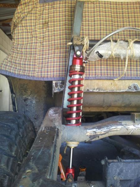

  10. Ok for anyone interested got my coilovers finished today, couple of quick snaps will go up as i was in such a rush to get it finished i didnt get many progress snaps sorry for that. I started with this idea but got stuffed around with the guys who where going to laser cut everything for me so had a last minute change of idea. Now it looks like this Little flex up just to make sure everything is working how it should

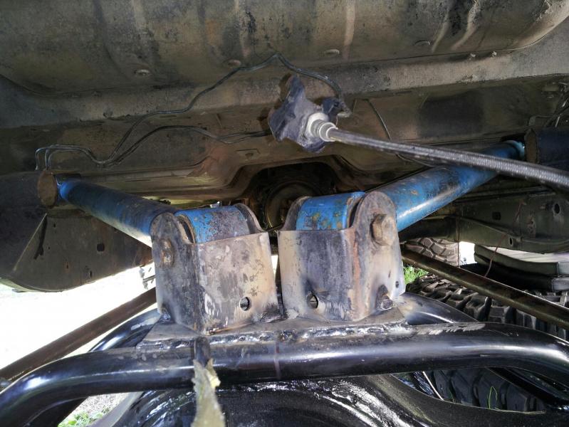

  11. In the front of mine i have been running dobinson heavy duty coils with tough dog adjustable shocks set to 4-5 clicks and its nice on road, off road i set them to 0. If your unsure ring Shane at suspension stuff tell him what you got hanging off the front and what your after in your ride and he can tell you exactly what you need.

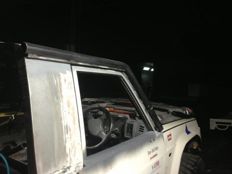

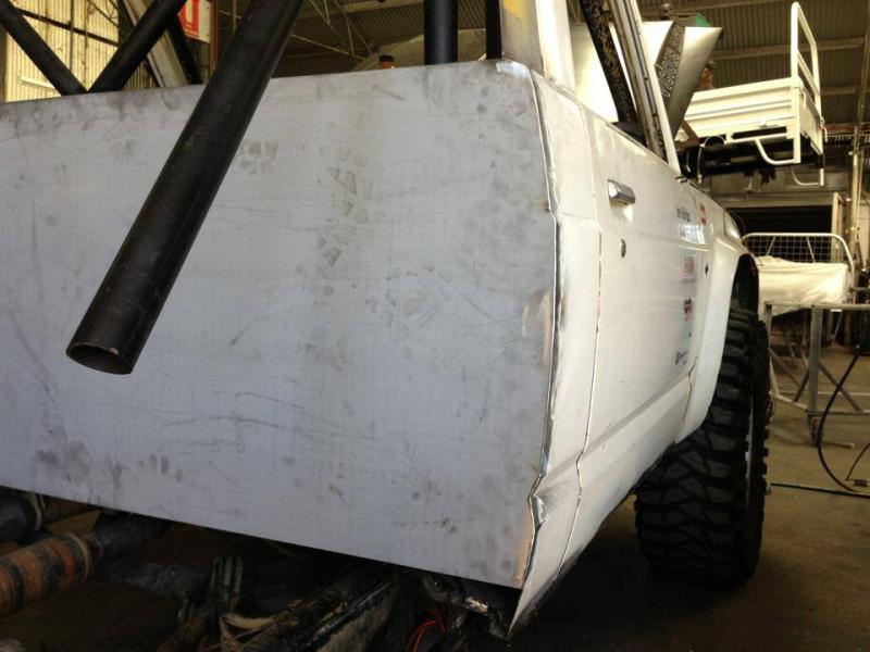

  13. Not as of yet Brando, once iv finished everything, so thats coilovers front and rear and changing to tri uppers on rear with longer lowers the lot will be engineered at once to save me time and some money instead of doing it in indervidual steps, as it sits its mod plated for cab chop, 35" tyres, the 4" coil lift and 2" body lift.

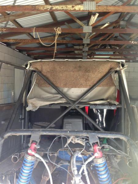

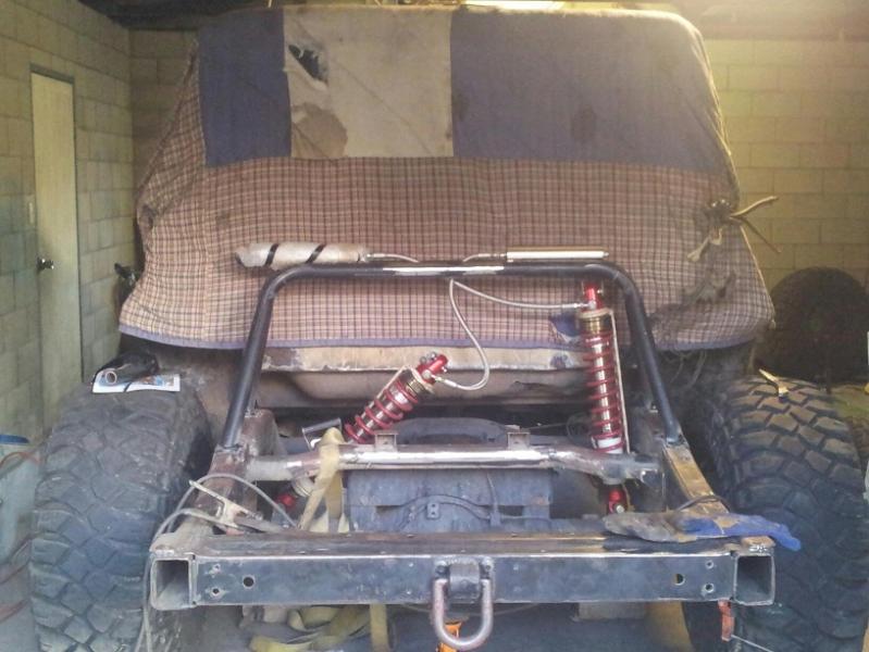

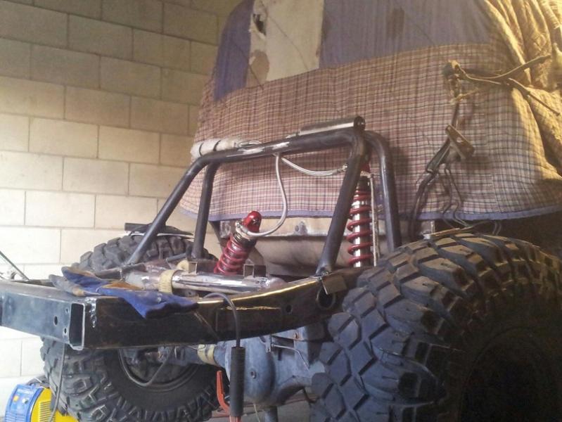

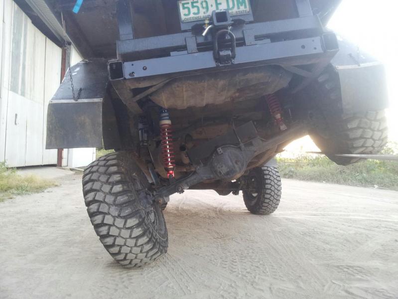

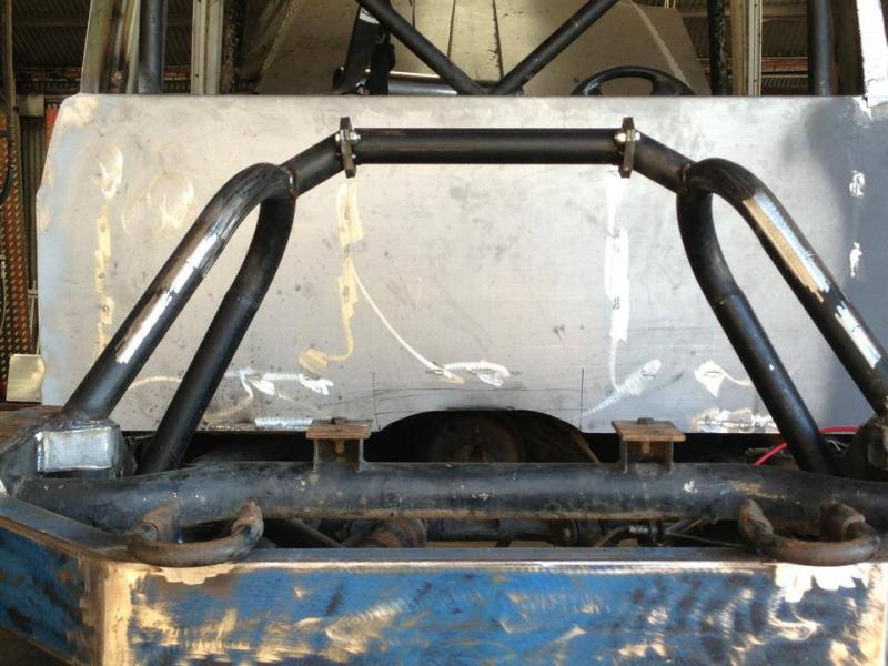

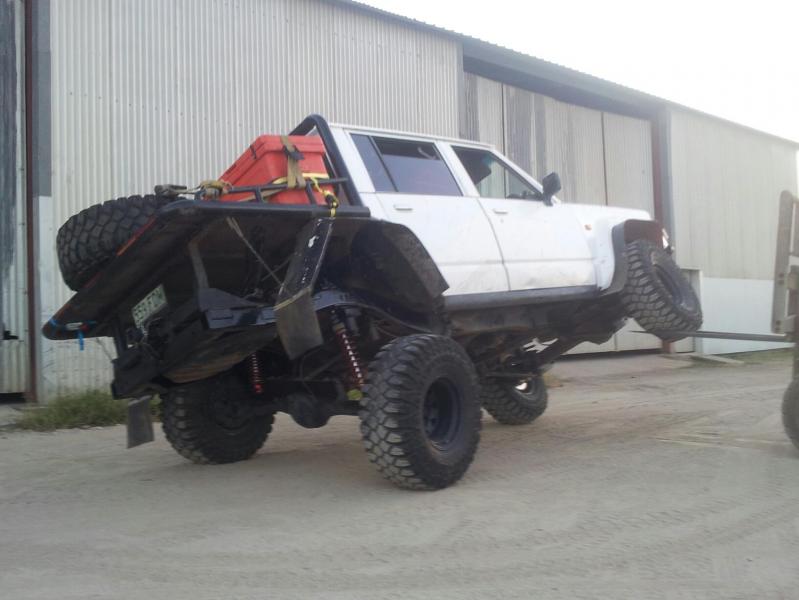

  14. Here ya go BigGQWesty the coilovers are in the final stages now and hoops are made and tacked onto the chassis ready and waiting for me to weld it all up but this will show you how much higher they sit now with the new tubes, ill also tomorrow take a picture with the cover off the back of my truck to see how far below the window they are.

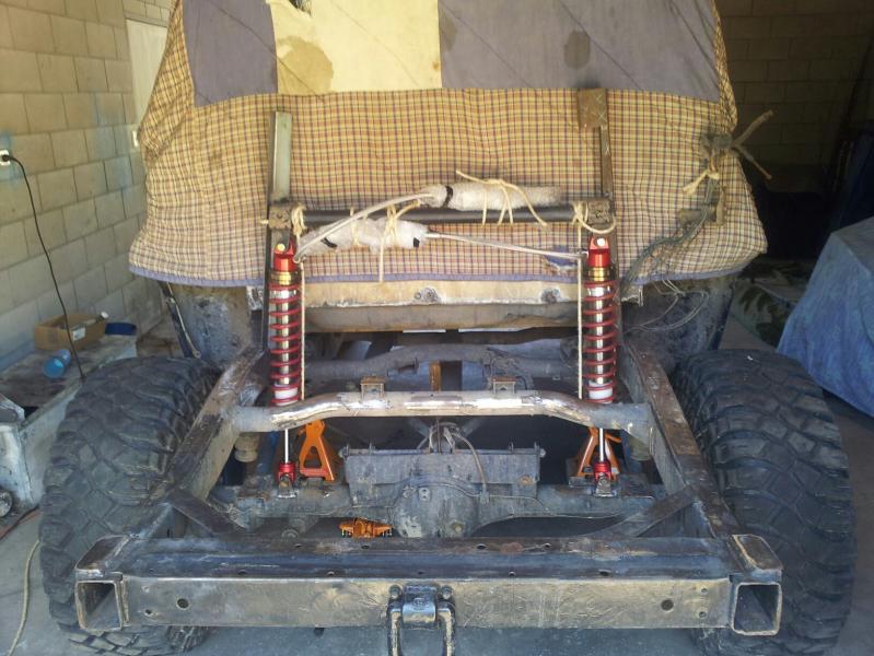

  16. Here a couple pictures of the progress so far, not long to go now have just finilzied the positioning and angles of the coilovers plus ordered the last two coils. Nearly all cleaned up mock up of the coilovers positioning and angles

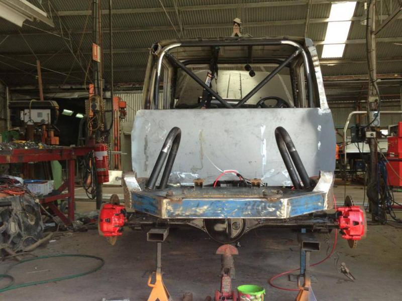

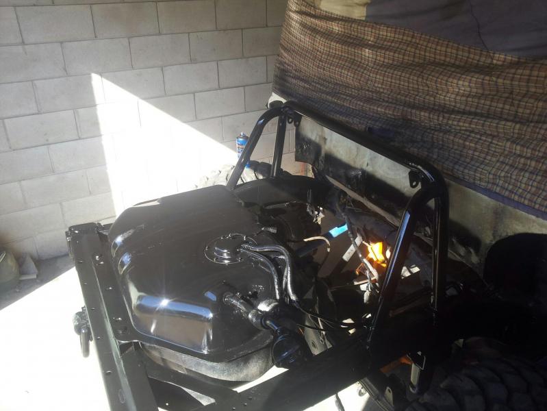

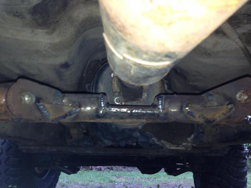

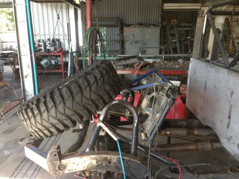

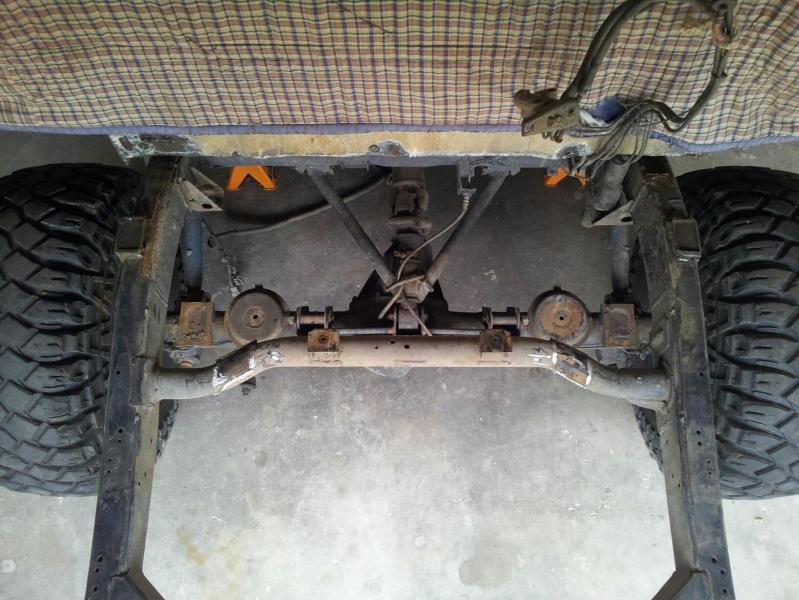

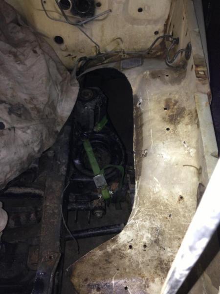

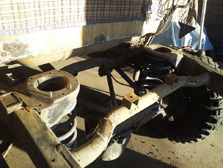

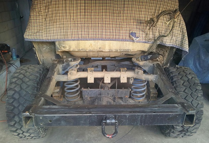

  17. The time has come to start my coilover conversion in the rear end, as a start iv dropped the tray, fuel tank ect to make room to work and have started cutting off all the standard mounts, also found some small rust in the rear wall ill fix while im there. Only have left to cut out the coil towers and i can get the grinder out and start cleaning the rails so when my coilovers show up early next week i can start fabbig up new towers for them couple quick snaps No turning back now lol

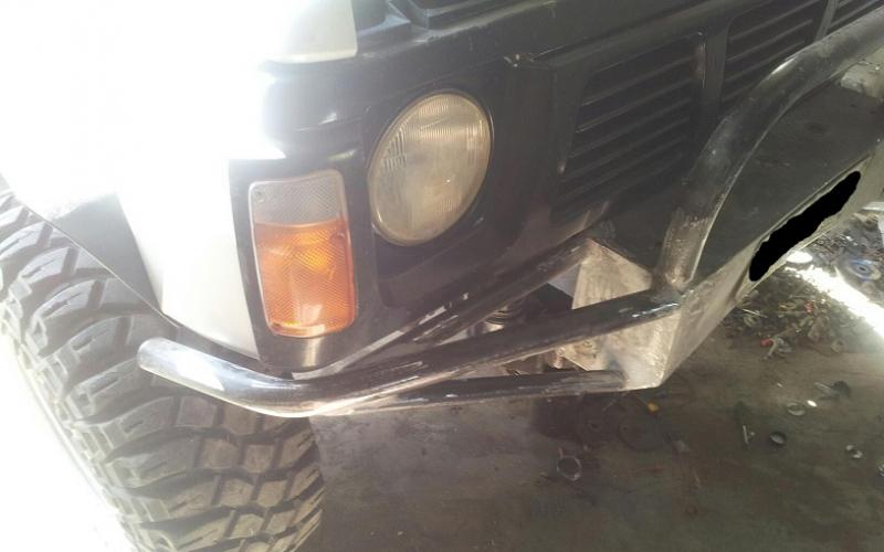

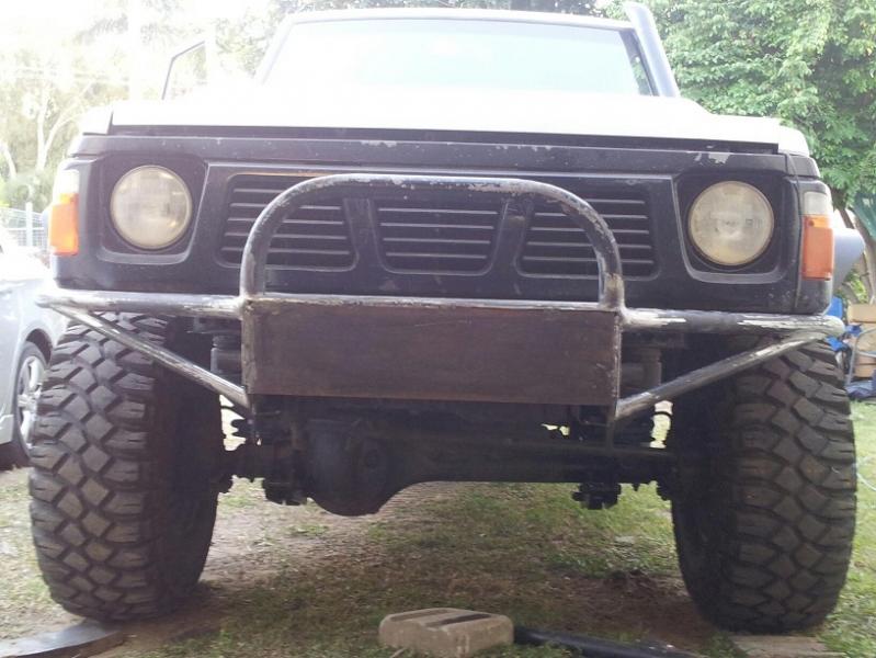

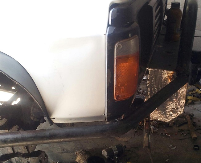

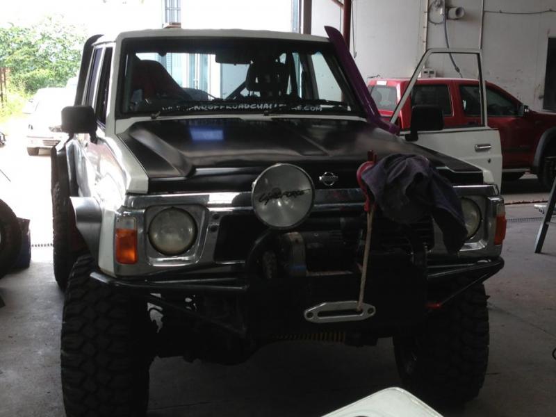

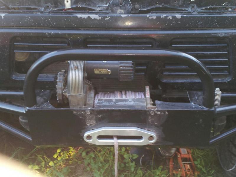

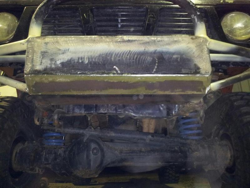

  18. Did a little bar work myself over the week, basically looks the same but has all new thicker pipe work and thicker center to hold a winch now. Firstly i cut all the pipe work off and then raised the bar 30mm and pushed it closer to the grill by 15mm to get it sitting perfectly, then i bent up some 45mm pipe at 4mm thick for the main wings that wrap around the guards (this was the main reason to redo the bar work as the old setup stopped at the corner of the grill), then cut and notched some 30mm by 4mm thick pipe for the bracing under and behind the 45mm wings, next setup was to cut out all the old plate work which was only 2mm thick and replace it with 6mm plate that wrapped all the way under and back onto the mounts for added strength in the mounting. I also slotted and straightened out the spottie plate onto which i was originally going to cut away for access to the low mount and weld tabs to the main hoop for the spotties but decided against that as i am in my spare time going to try and build a full tube bar to hold a high mount or low mount that will sit in closer to the grill again for comp use. Some quick pictures of before and during to the finished product.
  19. Ill buy them beadlocckers off you if you change size, And that bar looks so much better now with the pipe instead of that shitty tin plate

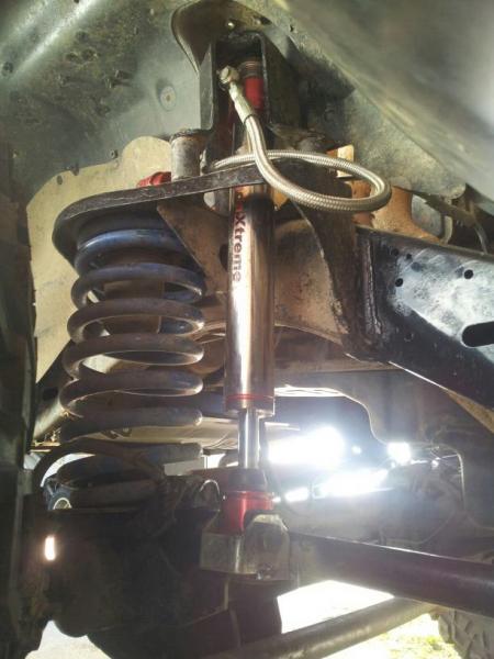

  21. New Armadas in the front of the old girl, top bolt has been drilled and pinned to stop it pulling out of its tread and went with eye lowers and welded in a new bracket to allow the shock to pivot nicer when flexing.

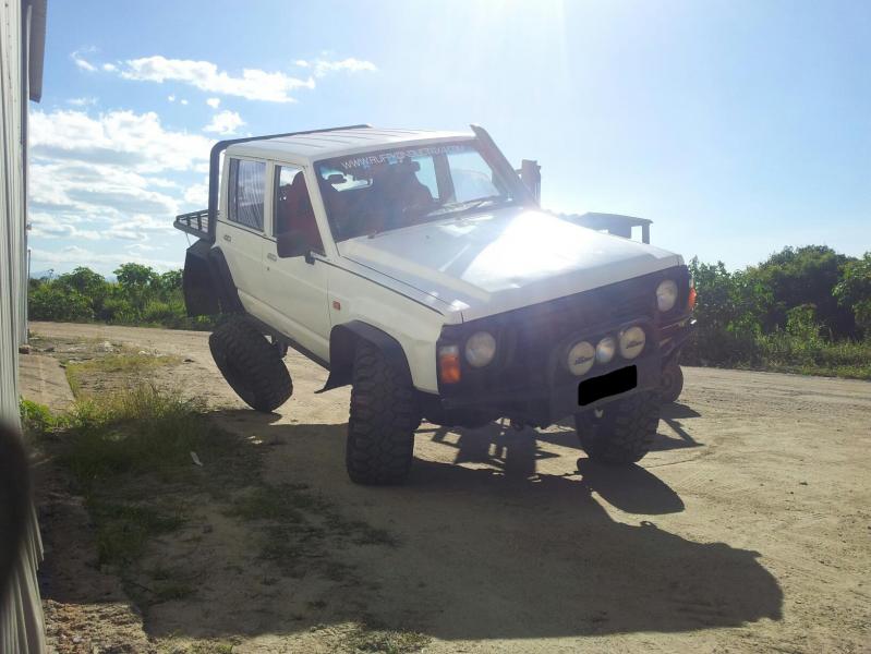

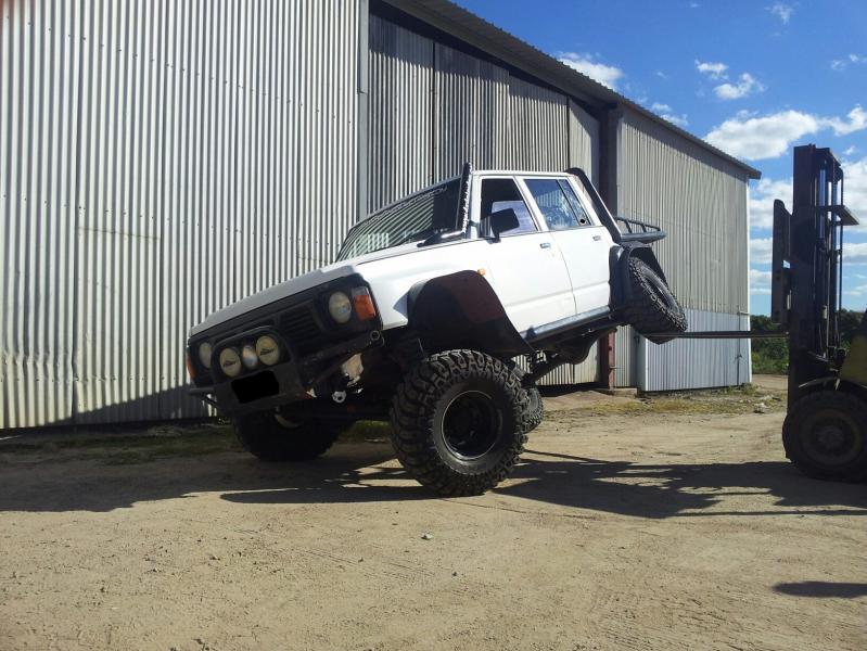

  22. Alot of pictures to come with next gorge trip i reckin we need to designate a picture guy at every possible spot

  24. Here is the long awaited flex shots with the 5 link in the front, thast only 6" shocks so im ordering new flexi coils and new longer shocks soon as i get other things on the list that are much needed done.
