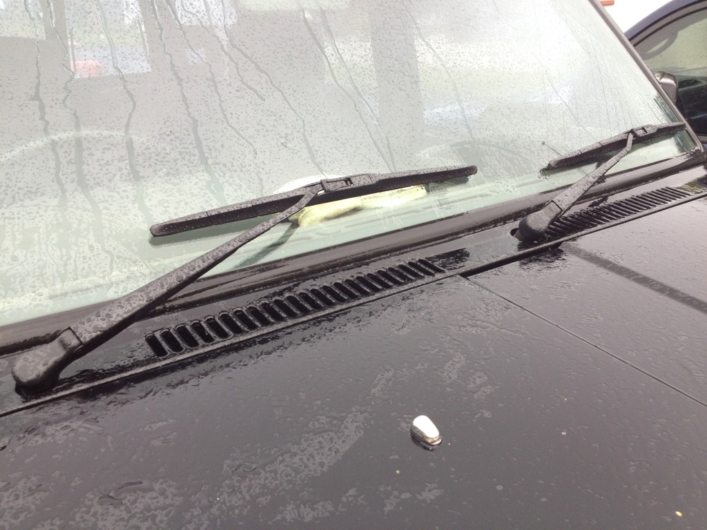

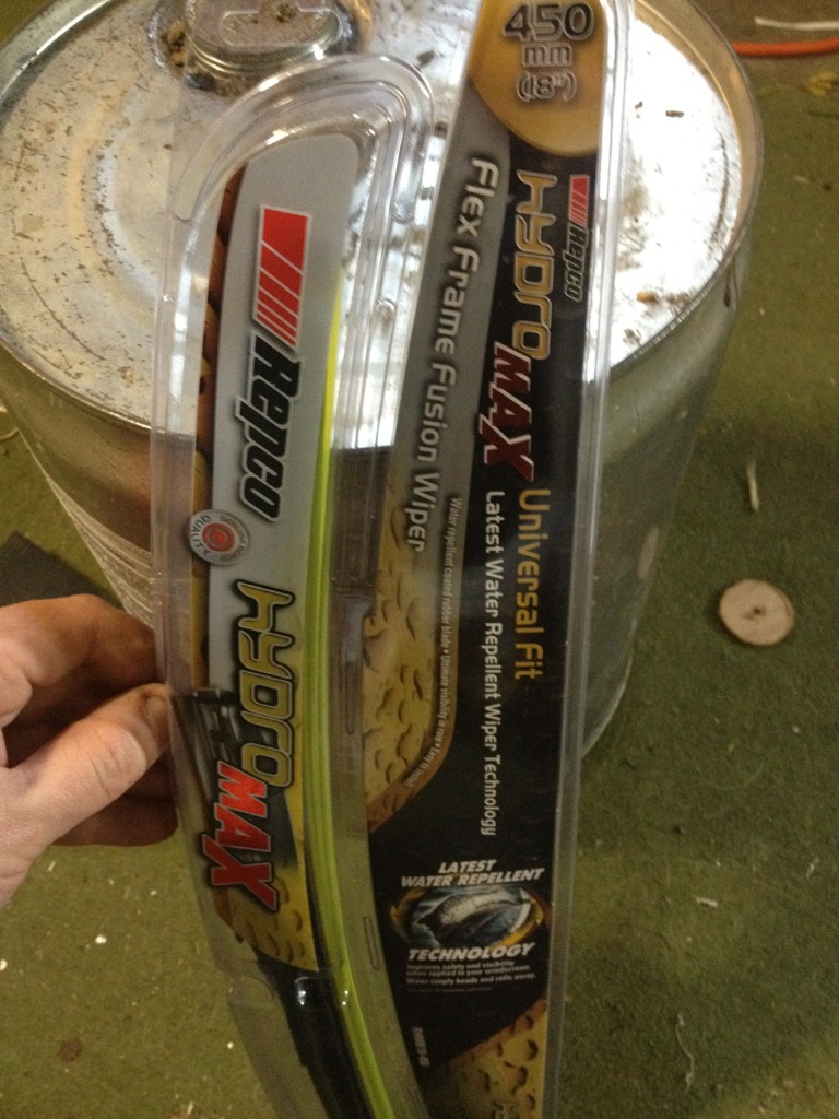

I'm on a roll.. Today was the window wipers.. After 480 000ks the originals were getting a bit sad.. The blade was nearly flat on the window.. Lol
So of to repco to get some blades and spines..
I first got the 430mm blades but the 450's give a full window wipe..

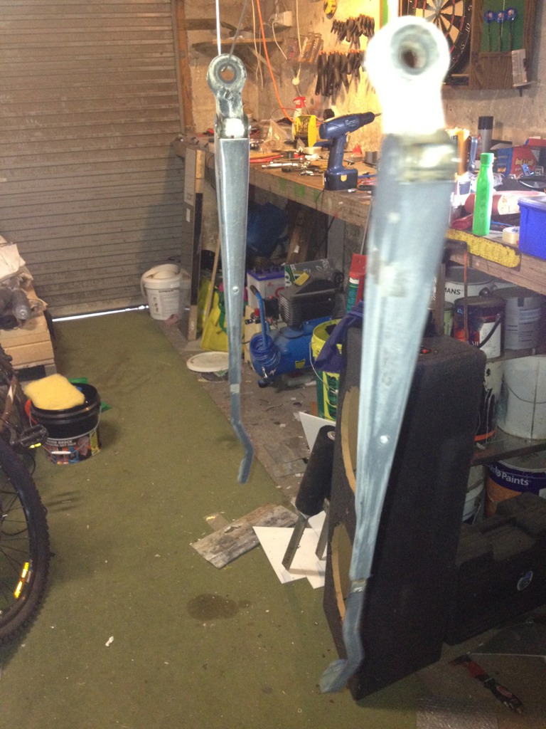

Next to get the old arms off.. Pretty simple.. First I undid the bolts under the cover, then using a small tyre lever and a but of timber to lever against they just pop off.. There a cone spline so they come off easy..

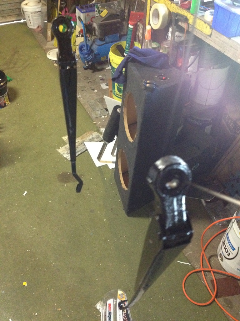

Right'o.. I gave them s light sanding to remove loose paint and roughen it a little. A quick wipe with the rubbing alcohol and hung them to dry..
3 coats of gloss black later...
And I've bolted them back on.. I have used never seize so there easier next time..
So smooth a quite... Well worth the $70..
All in a day..

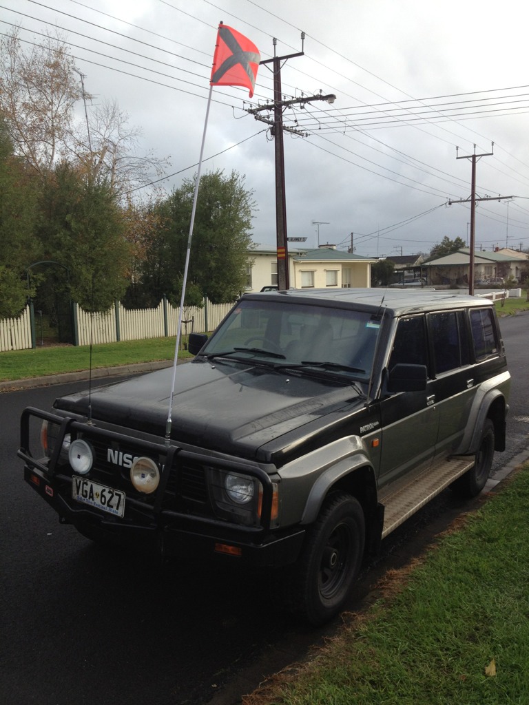

And today.. New 3 piece 3mtr sand flag.. (only 2 fitted ATM..)
Where did you get the sand flag from and cost?
Will need one for my Simpson trip in July.

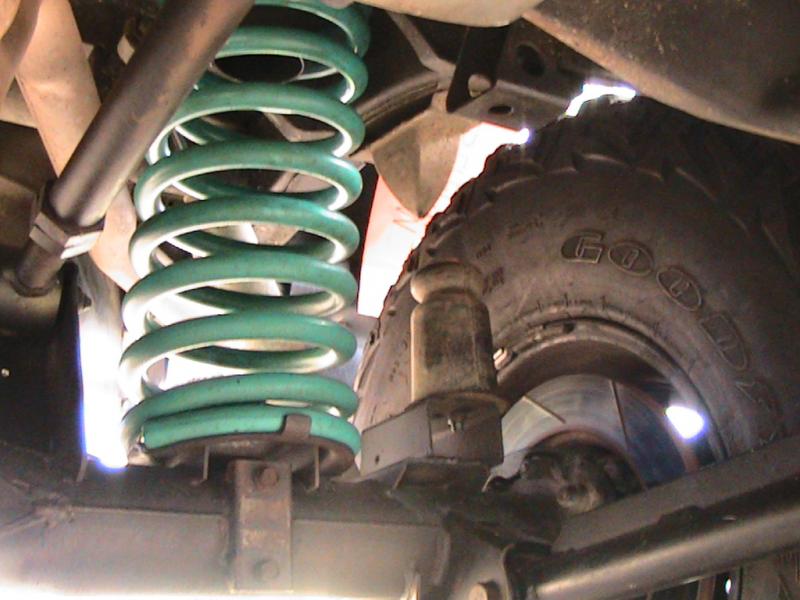

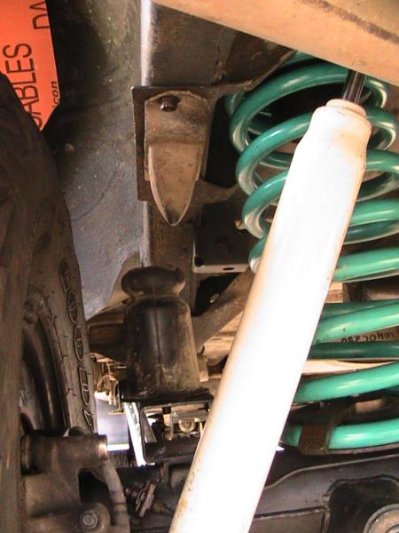

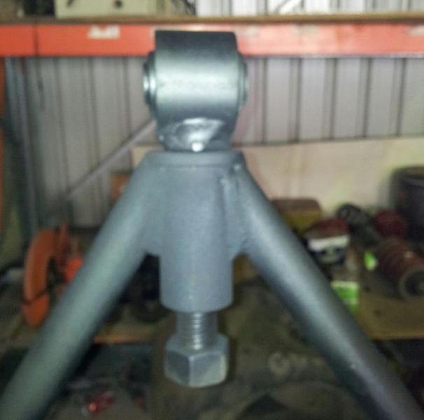

Built my bump stop extensions today, well really just fabbed up a extension off the diff for the bump stop out of some 4mm plate some 30mm OD pipe and some 2mm plate :)
