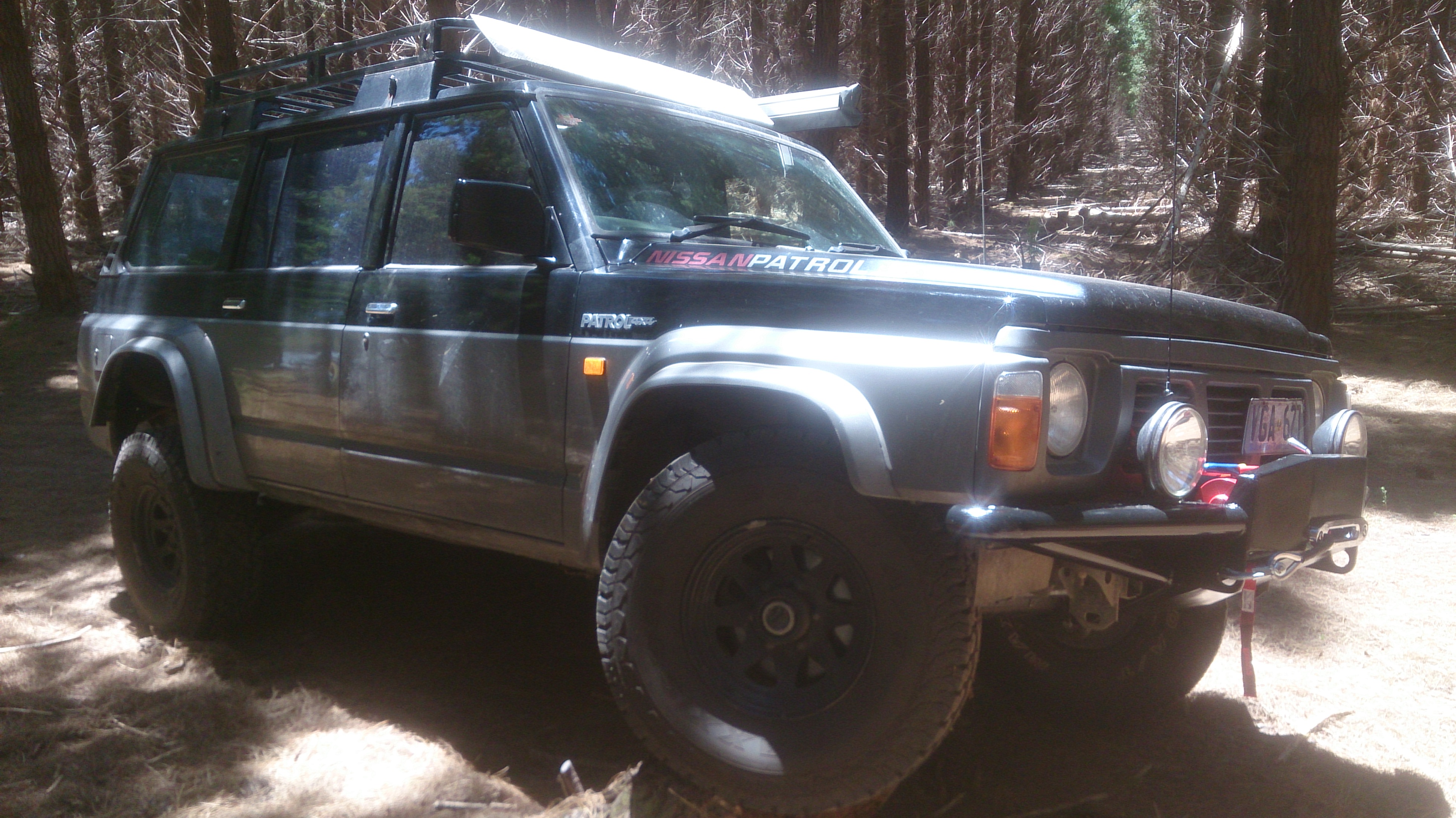

Fit roof rack and hopefully light bar...

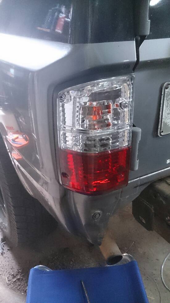

New tail lights

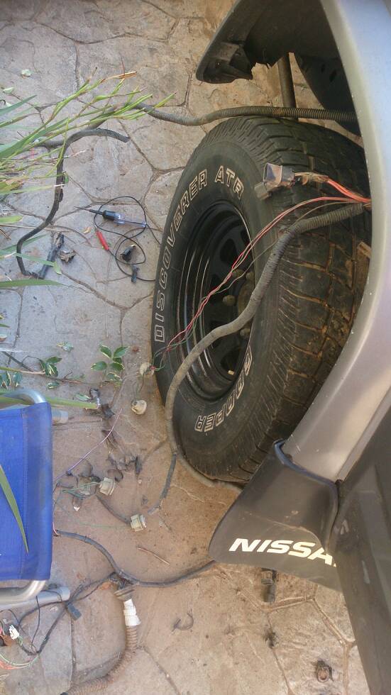

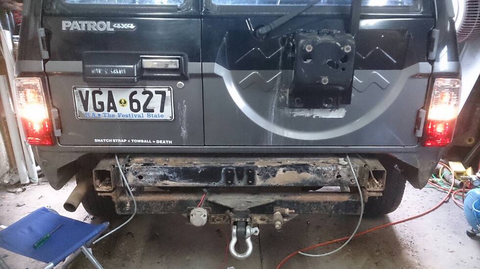

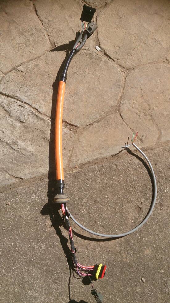

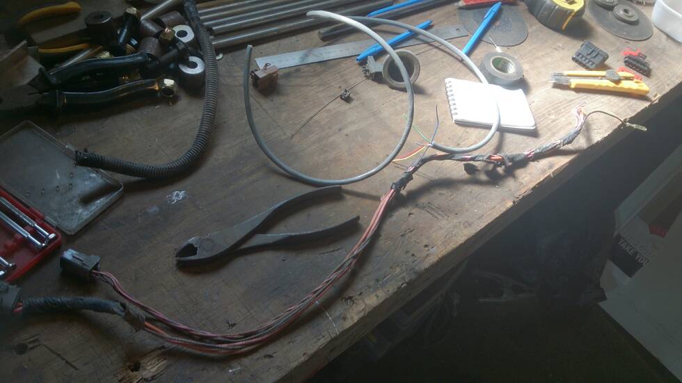

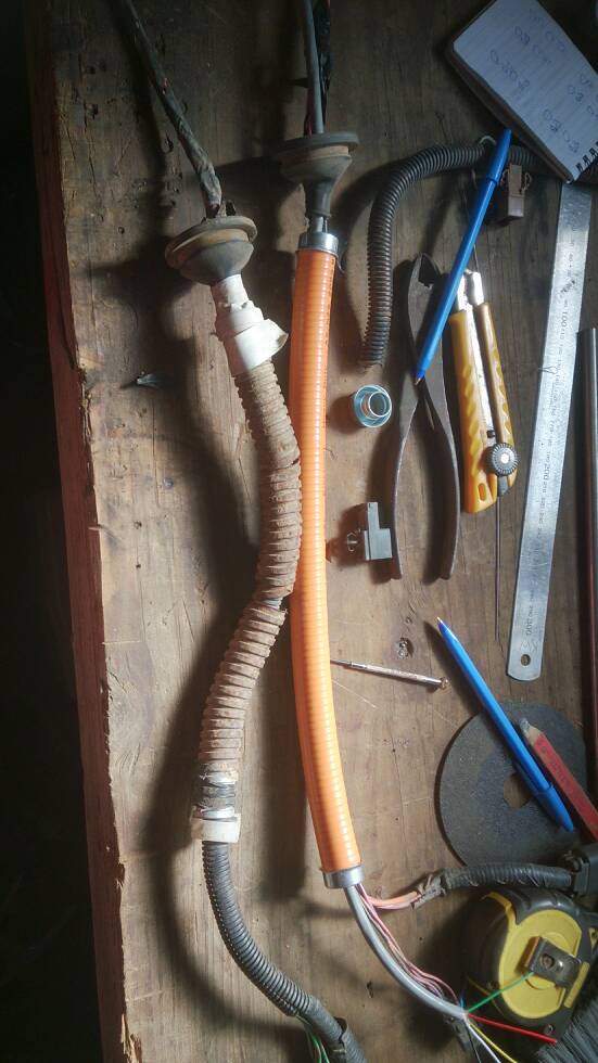

Well I started my Christmas tree body light wiring.. Doing it properly. I'm splitting out the lights from the loom and rrunning New wires to all 5 points (trailer plug aswell)
And running all exposed sections of wire in New steel conduit.
Should look good..

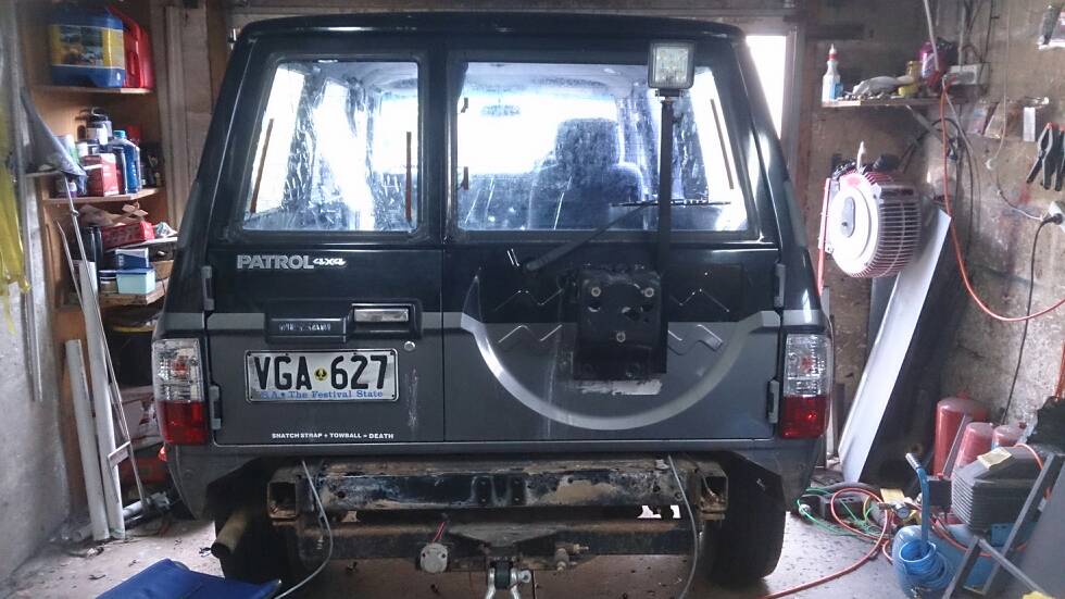

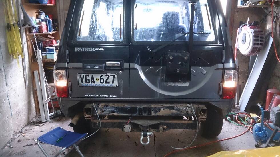

Well lights are done. Fiinnnaaallllyyyy... Lol

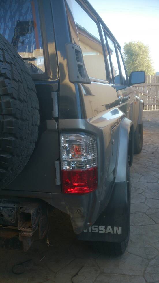

I nearly also took a grinder to the 1/4 panels, but upon a second look the rust ain to bad. So I'm going to repair it, seal it all up and spray lanolin oil around to prevent any more rust..
Ill be going flexi flares and home made mud flaps. That way I'll minimize the dirt and crap build up in the wheel arches..
Next up and some new wings for the rear bumper..

I have fitted 33's though..
Went maxis bravo 980's in a 33x10.5x15..
Not many do this size, but didn't want to go a 12.5 due to mostly doing highway k's and didn't need new rims

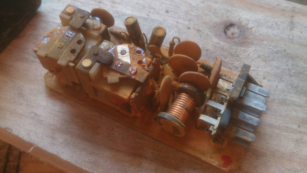

I also think I have found my window issue. The amp unit is fubar'd..
So it turns out that the bloody amp unit has been my issue the while dam time. I've removed it and all but the drivers window work. Ffs lol
So sourced a new unit from a mate for $50 so that's a lot better than $200

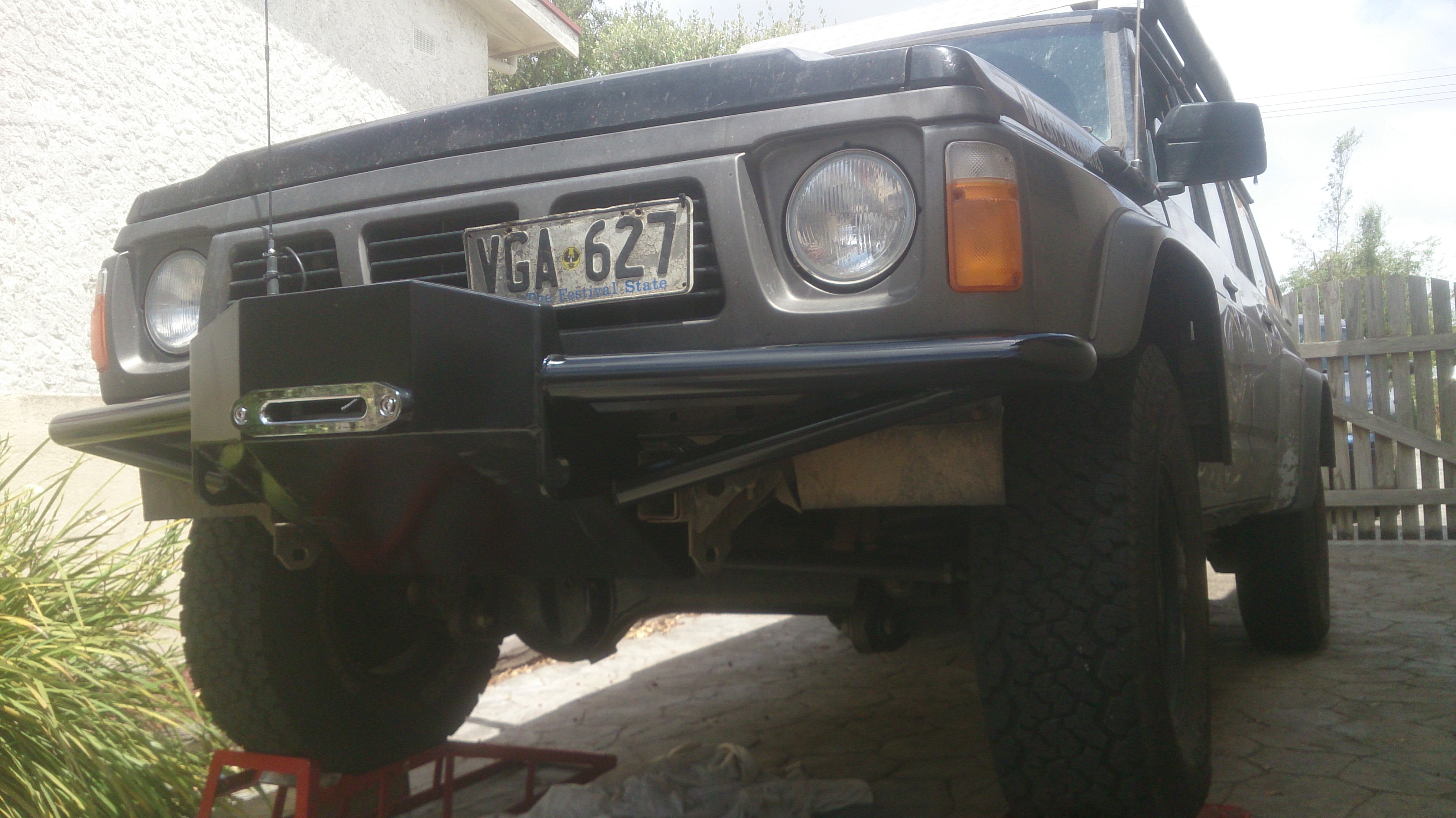

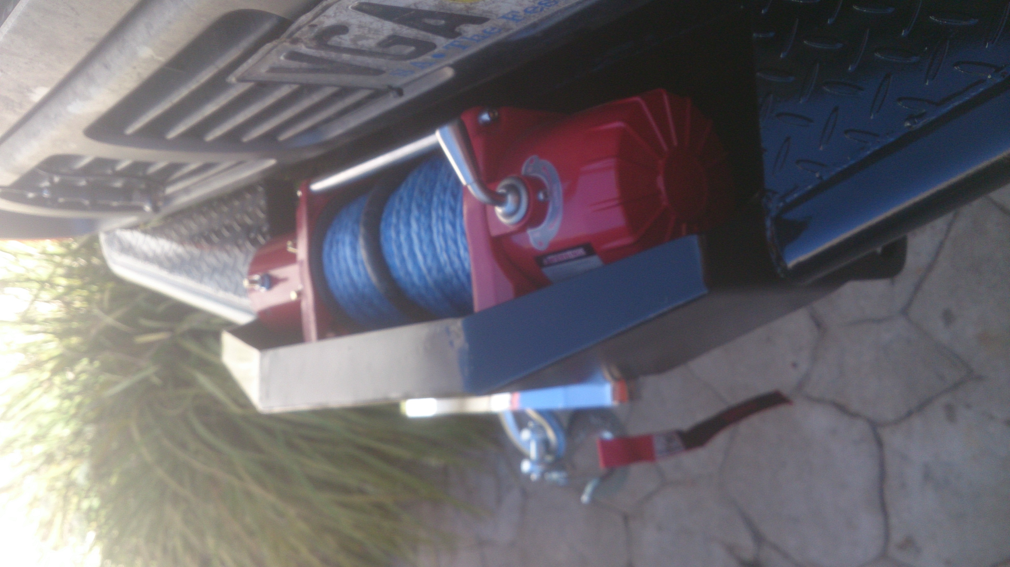

So had a productive weekend.

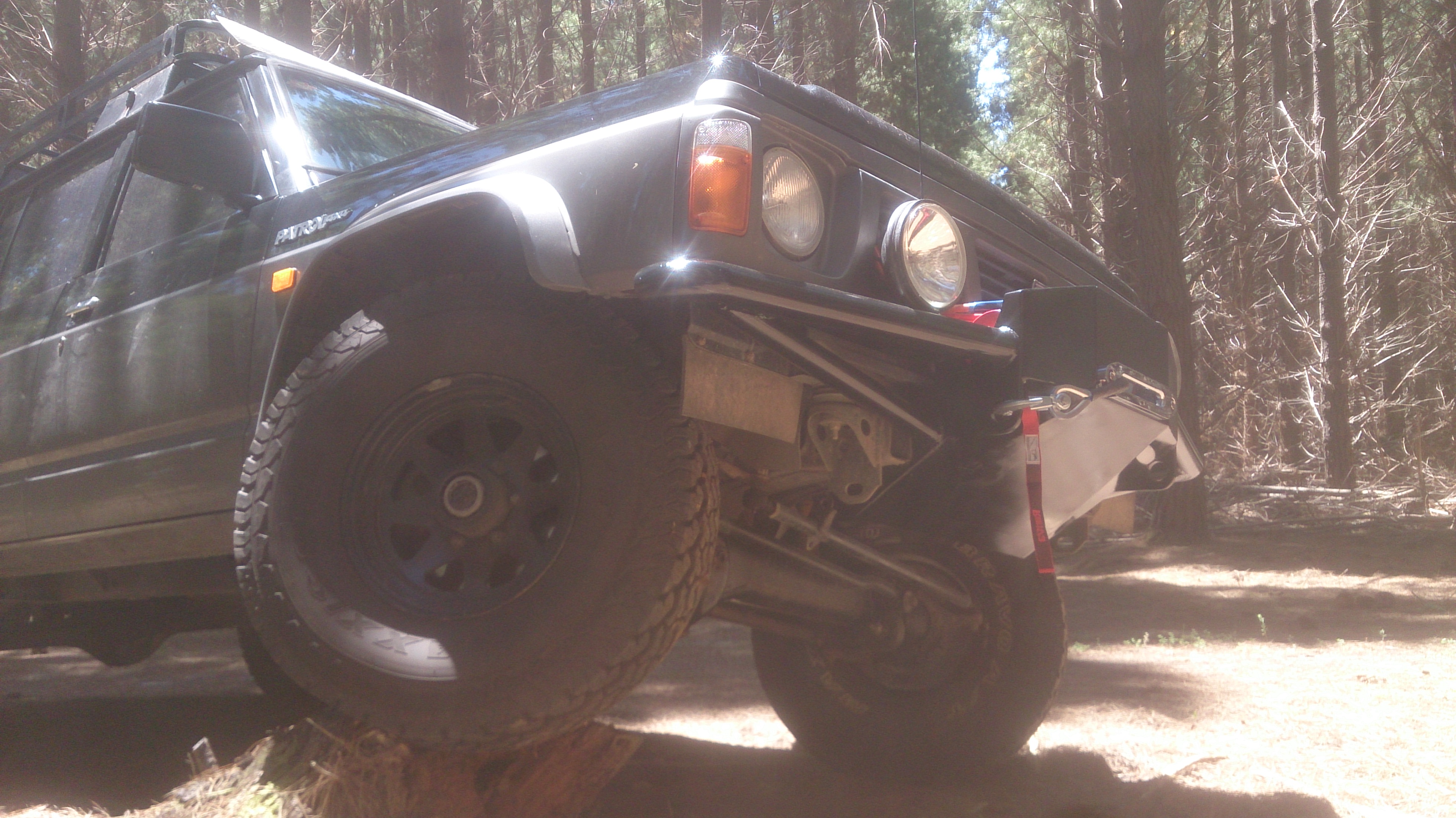

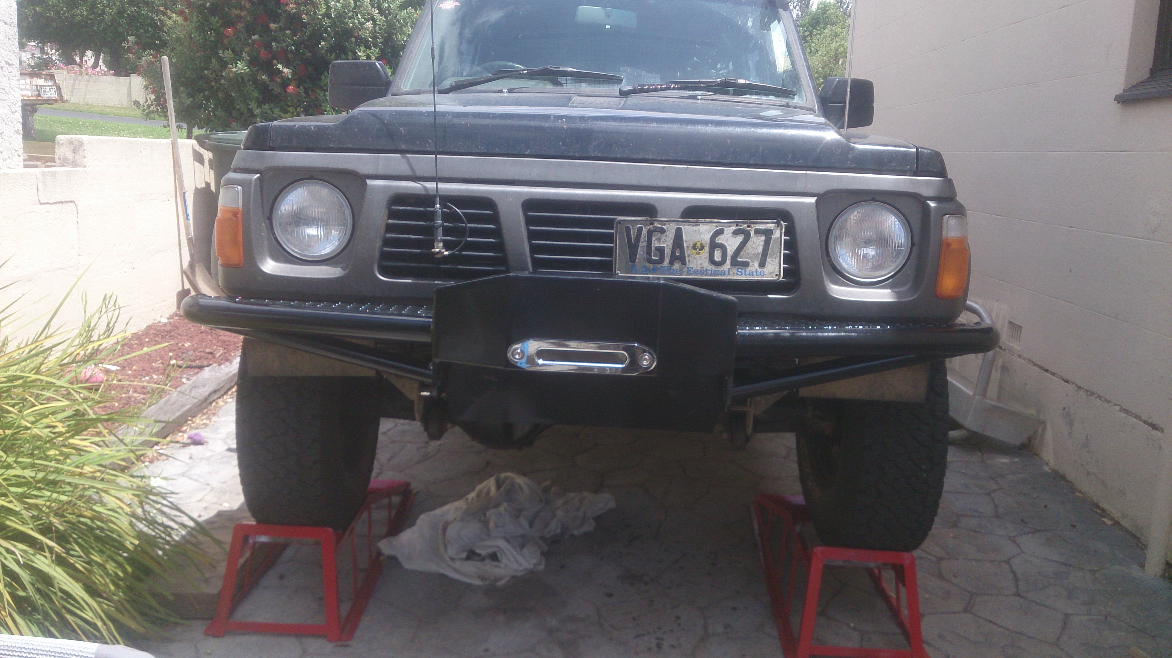

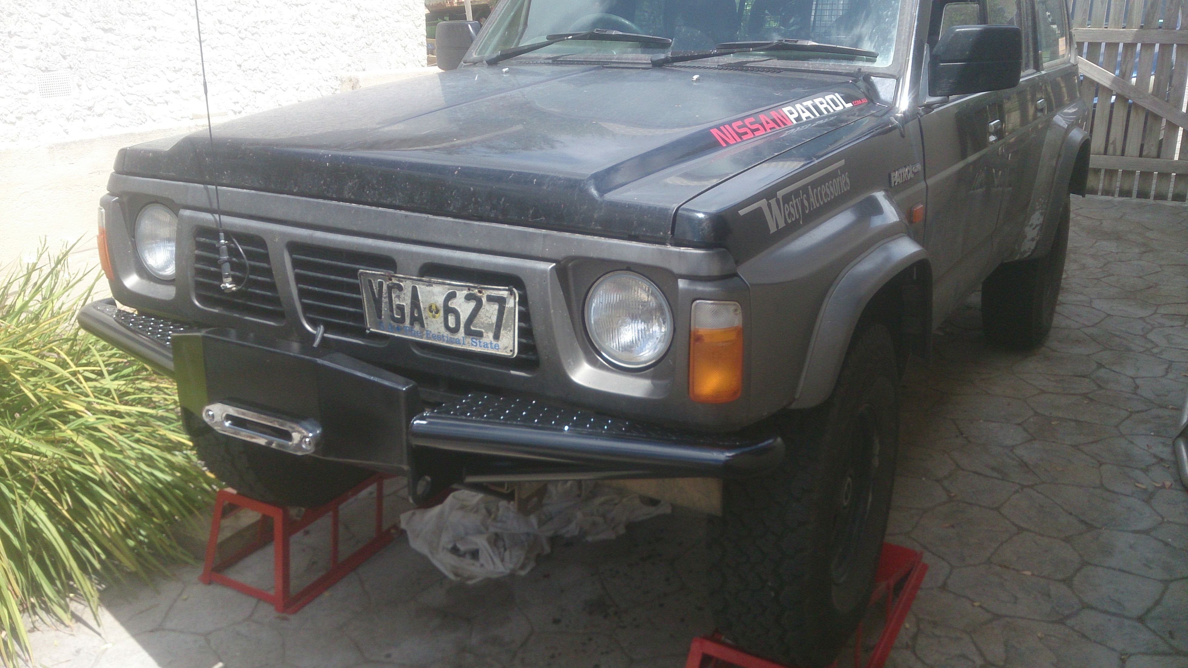

I finished (for now) my winch bar and installed.
It's made from 12mm plate on the sides with incorporated recovery points, 4mm guts and bash plate.
3mm check plate on the wings.
60mm wing tube and 50mm brace.
And is now home to the 11xp.
