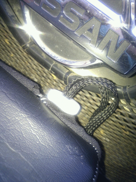

dronus4x4 Posted May 10, 2012 Report Share Posted May 10, 2012 (edited) I got a bit nervous when i heard about how water can get into the control box for the winch. I ran silicoln around all the screw holes but was concerned about the plug where the controller goes if the cap didnt seal correctly. Being that my car doesnt get driven much during the week i had an idea to make a cover that can go over the control box to keep rain out while its sitting there, or even while driving. Here is version 0.1a. It looks pretty good but i need to test out its waterproofness and how long it will last outside. What do you think? Maybe if i can refine it, and the price is right people might like one for their winch control box? Click on the photos for a better image. Edited May 10, 2012 by dronus4x4 admin 1 Link to comment Share on other sites More sharing options...

dronus4x4 Posted May 11, 2012 Author Report Share Posted May 11, 2012 Cheers for all the ideas. We did look for a spot to mount the control box in the engine bay but nothing stood out with all the other crap in there, and with limited time andtheneed to use the supplied cables. My tigerz11 came with an isolation switch so no one can activate the winch by the control box unless they have access to the engine bay. Good news is that after a week of the car sitting in the rain in the driveway and theone mad dash to the indian curry shop in therain after i got back from the airport the control box is as dry as a nuns nasty. I can't see anywhere else that water can get into these new boxes (I've also run silicon over the joins even tho they have o rings, apparently). See how it goes. Kudos to my wife for making it :-) Sent from my GT-P7100 using Tapatalk 2 heyhey 1 Link to comment Share on other sites More sharing options...
