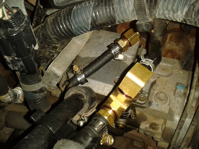

November 9, 201312 yr comment_7609 Changed oil and filters, finally fitted spill line mod. Edited November 9, 201312 yr by Rumcajs Report

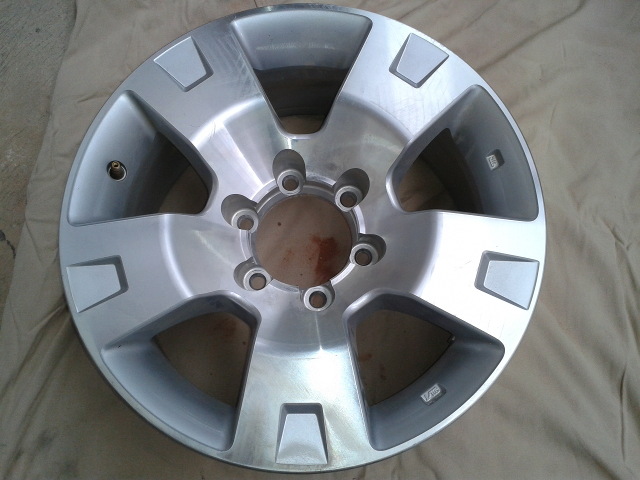

November 11, 201312 yr comment_7611 Bought replacement fan for intercooler (old one is rattling in to pieces) and spare 17 alloy wheel (Nissan). Already had spare tyre (Bridgestone D693) so now fitted it together with another spare which was never used since new from factory. So now have 2 new wheels/tyres on the rear axle. Edited November 11, 201312 yr by Rumcajs Report

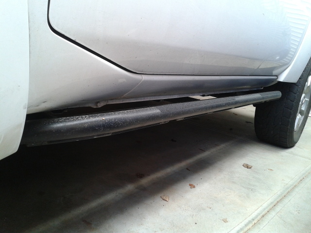

December 19, 201312 yr comment_7664 Took my rock sliders off today.. Sanded them back, have them in undercoat now, should be able to finish painting them tomorrow Report
December 19, 201312 yr comment_7665 Took my rock sliders off today.. Sanded them back, have them in undercoat now, should be able to finish painting them tomorrow ImageUploadedByTapatalk1387436105.334906.jpg Are those sliders from Bolsy's? If so, any dramas fitting them? Straight fit? Cheers Report
December 19, 201312 yr comment_7666 Are those sliders from Bolsy's? If so, any dramas fitting them? Straight fit? Cheers Yep they are Bolsey's. The seemed to fit ok. I had a mate help me fit them about 18 months ago. I did have to cut an exhaust mount to fit them, however it's an after market system so that could go either way. More the point I took them off cause they were incredibly rusty. I touch them up if I scratch them, (I opted for the painted ones so I would be able to touch up scratches etc, as opposed to powder coating) and there is no rust anywhere else on my truck, but I took I grinder and a hammer to these today... they were that rusty I was bashing rust scale a mil or two thick off with a hammer. No idea why they corroded so badly, but I soaked them in rust converter , and painted them with rust converter/primer. Hopefully I won't have to do it again. Report
December 19, 201312 yr comment_7667 Oops, that's not good that rust. So it has either been some manufacturing issue (surface preparation)or you spend a lot of time on the beach, LOL. I've been eyeing those slider for a while now, this makes me think twice, I frequently visit beach so now I'm not so sure. Have you asked Bolsy about that? Cheers Report
December 19, 201312 yr comment_7668 Yeah I do spend a bit of time on the beach. Personally I think it was surface prep. I did think about ringing and discussing it with him but figured it would just go round in circles. To be honest I wouldn't be put off buying them, they are solid, welds seem good... Seem to reasonably thick steel. (I am not gonna cut through one to check ) but they are heavy. I would just paint them really well before you put them on. Other people seem happy with them.. So my sliders might be just a rare exception . Cheers Report

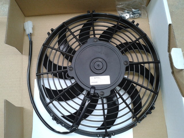

December 27, 201312 yr comment_7683 Replaced intercooler fan, hopefully this one will last....bloody aftermarket people, nothing ever fits... Report

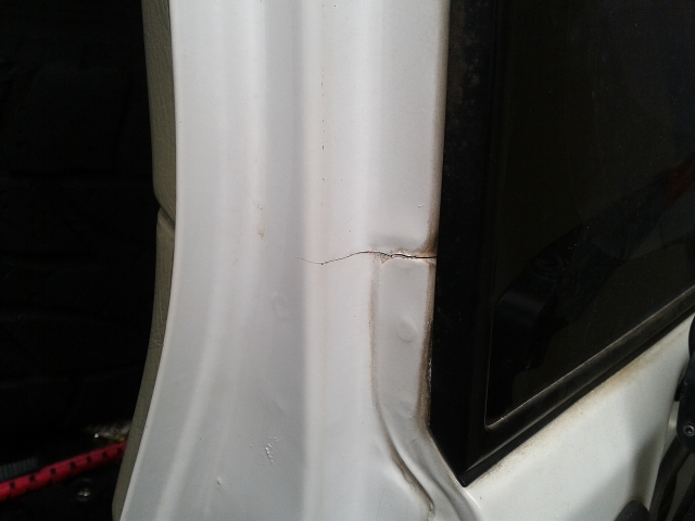

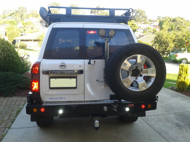

August 3, 201411 yr comment_7986 Found out that my barn door is cracked, suffers from "the spare wheel mounted on the door and POS Japanese engineering" syndrome. So removed the door carrier bracket and chucked the spare inside for the time being, time to hunt for the rear bar wheel carrier combo and figure out how to fix the crack. More money to waste on the lemon,yay! Also checked the rock sliders/steps fitment all seems good. Cheers Report
