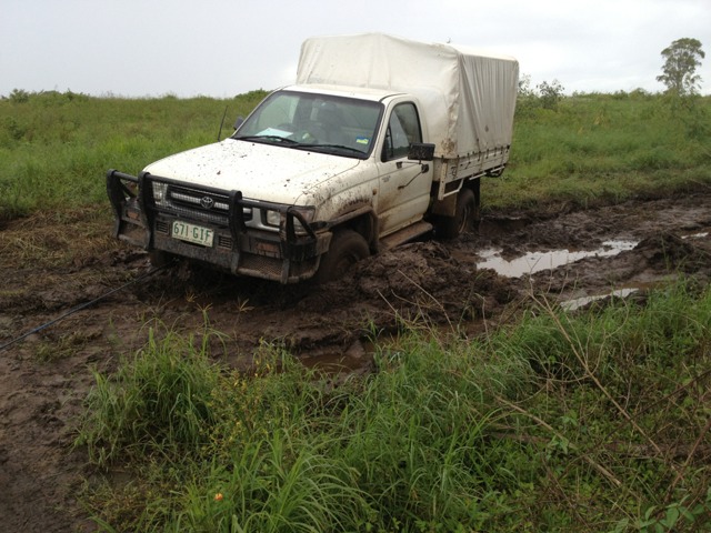

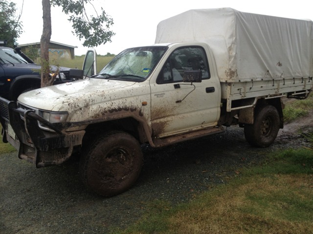

March 9, 201313 yr comment_7087 "Rescued a Toyota" Aargh, the shame Toyo saved by Patrol again...... Edited March 9, 201313 yr by Rumcajs Report

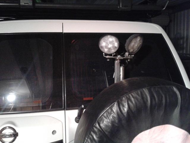

March 28, 201313 yr comment_7163 Fitted another work/reverse/camping light because two are better than one Cheers Report

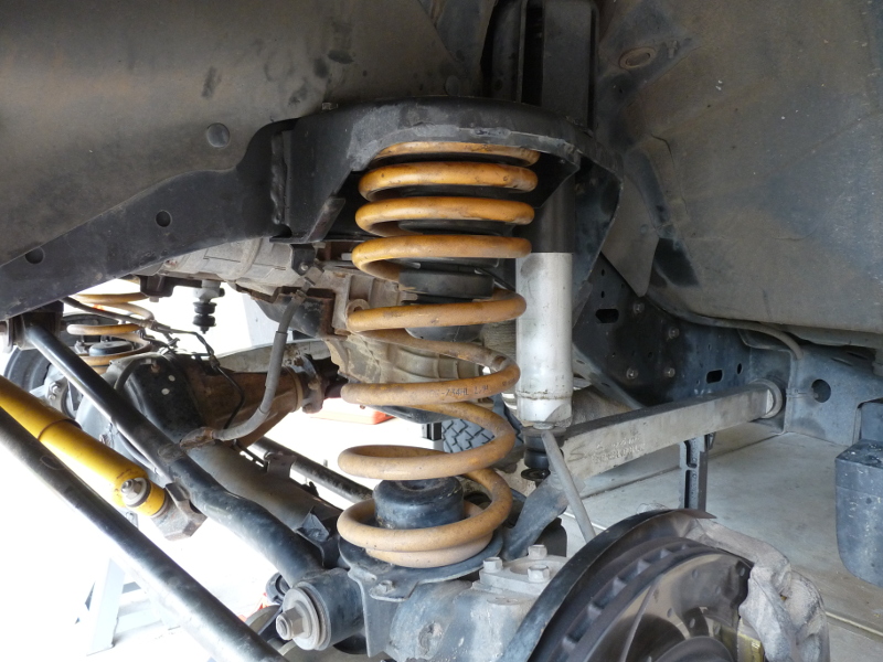

May 19, 201313 yr comment_7287 Went to NADS meet this morning and in the afternoon fitted one of these ..... Cheers Report

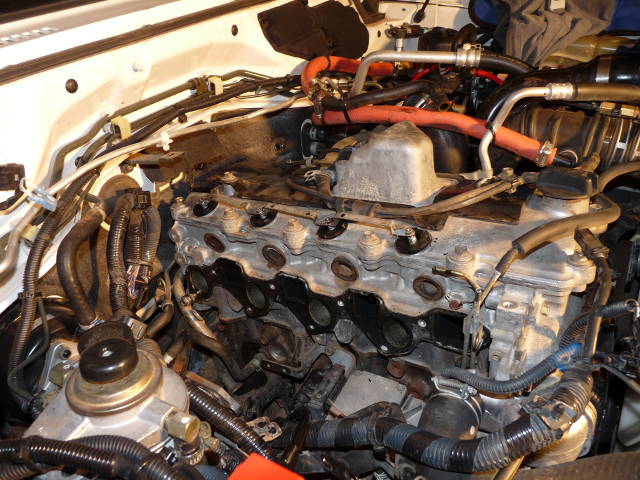

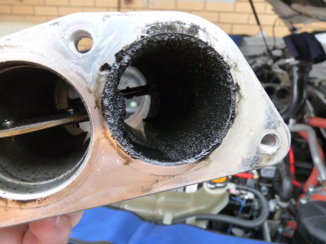

May 25, 201313 yr comment_7307 Changed glow plugs, number 1 and number 2 OK, no 3 tip burned off and number 4 partially melted tip. Easy job than decided that I could make an effort to remove inlet manifold to clean it up. Big mistake! Car is in bits, mess everywhere and me not happy. Edited May 25, 201313 yr by Rumcajs Report

May 26, 201313 yr comment_7309 Refitted inlet manifold and rest of the crap back, what a biatch job, never again....... At least its all clean and hopefully stays clean after appropriate precautions were taken. Cheers Edited May 26, 201313 yr by Rumcajs Report

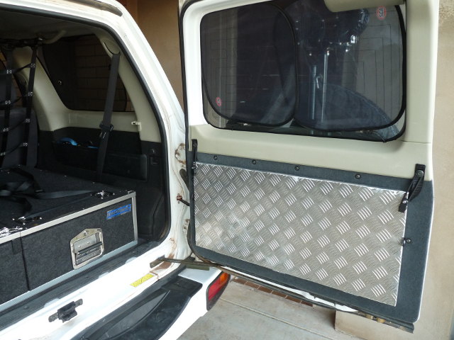

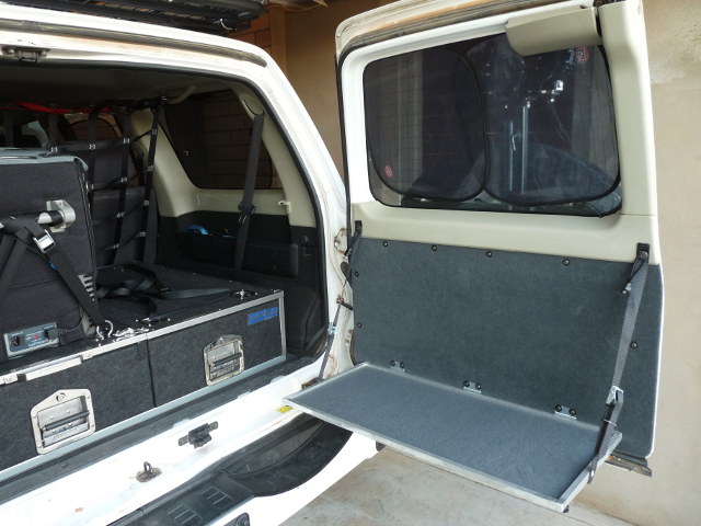

June 1, 201313 yr comment_7327 So, you have built in a way to put two wheels up on a gutter, and still have a level table! Nice idea. How did you secure the strap to the door? Report
June 1, 201313 yr comment_7329 So, you have built in a way to put two wheels up on a gutter, and still have a level table! Nice idea. How did you secure the strap to the door? I have re-drilled existing holes for top plastic trim and inserted 6 mm rivnuts than used bolts from truck dashboard panels but one can use any bolts really advantage of these ones was that they have slightly bigger shank half way length and also really wide head(like a mushroom/umbrella shaped). Cheers Report
June 2, 201313 yr comment_7331 Looks good mate. The table will be used heaps. It's the best mod I have done I reckon. I put my new/2nd hand bullbar on today. Report

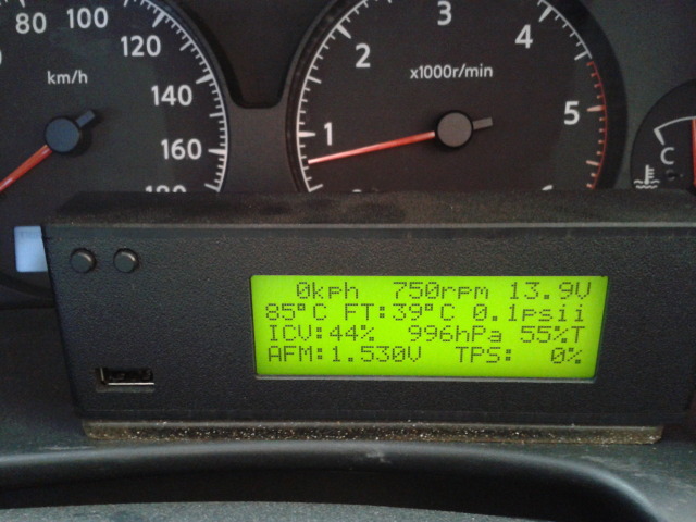

October 13, 201312 yr comment_7546 Reloaded firmware in the ECUTalk LCD display unit so now have "fuel temperature" to worry about..... I love that unit; audible warnings ability have saved ZD30 a few times (coolant temp, RPMs) speed and odo can be calibrated correctly, DTCs read out on the fly, Cheers Edited October 13, 201312 yr by Rumcajs Report

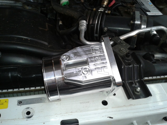

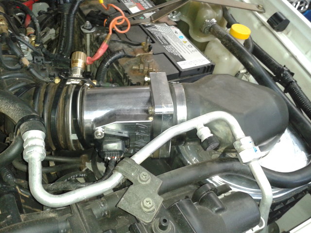

November 1, 201312 yr comment_7597 Fitted HPD high flow MAF housing. Need to retune JDVM now looks like a time consuming trial and error setup or I need access to dyno and diesel chip as well. Cheers Edited November 1, 201312 yr by Rumcajs Report
