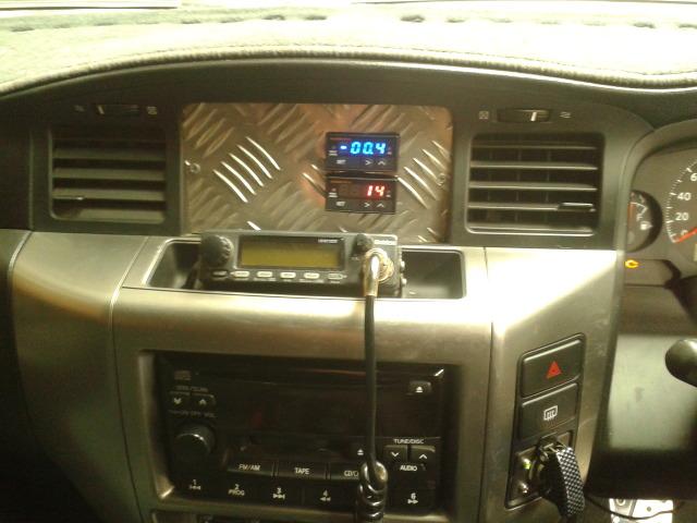

December 17, 201411 yr comment_8165 Just wires going through the fire wall. The boost sensor is still in the engine bay Report
March 25, 201511 yr comment_8287 Finally out in my boost and egt guage, along with an egr blocking plate, now been spending last 2-3 days fine tuning the needle and dawes valves !! Pain finding the sweet spots !! Report

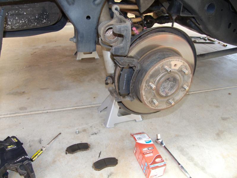

March 28, 201511 yr comment_8288 Decided to change brake pads all over before Easter trip. Interestingly found that aftermarket pads might not be necessarily better from how much material they contain. Genuine pads front 12 mm aftermarket 9-10 mm, rear 10 mm aftermarket 8 mm. Makes me wonder what is going on. Well time will tell if it was the good decision to go with these fancy Bendix hybrid pads. They certainly have less "meat" on them than genuine Nissan ones. Report

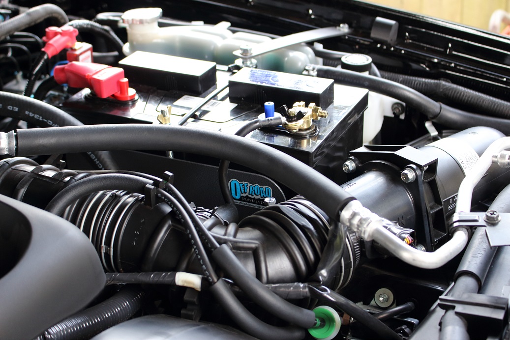

July 29, 201511 yr comment_8384 Replaced another battery, the main one this time, I'm so over this shyte, so far 5 batteries in 5 years........Bought classic vented lead acid one instead of those crap MF sealed POS. Seems like my shitbox runs on lead acid fuel, lol.Cheers Report
August 4, 201511 yr comment_8390 Replaced another battery, the main one this time, I'm so over this shyte, so far 5 batteries in 5 years........Bought classic vented lead acid one instead of those crap MF sealed POS. Seems like my shitbox runs on lead acid fuel, lol.Cheers Mate... Have you added the extra earth between chassis and battery negative...seems like its running down... My 2003 had a similar issue when I got it and did thus, no new batteries since... The aux can get hot. Was recommended to get a hybrid..and add heat shield. Did that and all good... Report
August 8, 201511 yr comment_8397 I have fitted several earth cables already, one between chassis and body and another between engine, chassis and body.I did fit heat shield to the aux battery now too. I think 2 batteries were cooked and drained dead too often, one got shaken to bits during Simpson Desert crossing and one simply failed (poor manufacturing perhaps) and I had to replace the OEM battery after 8 years of flawless performance. I went back to old style wented caps flooded type as Patrol has zero capacity left in its alernator for the fancy new types with higher charging rate.Regards Edited September 6, 201511 yr by Rumcajs Report

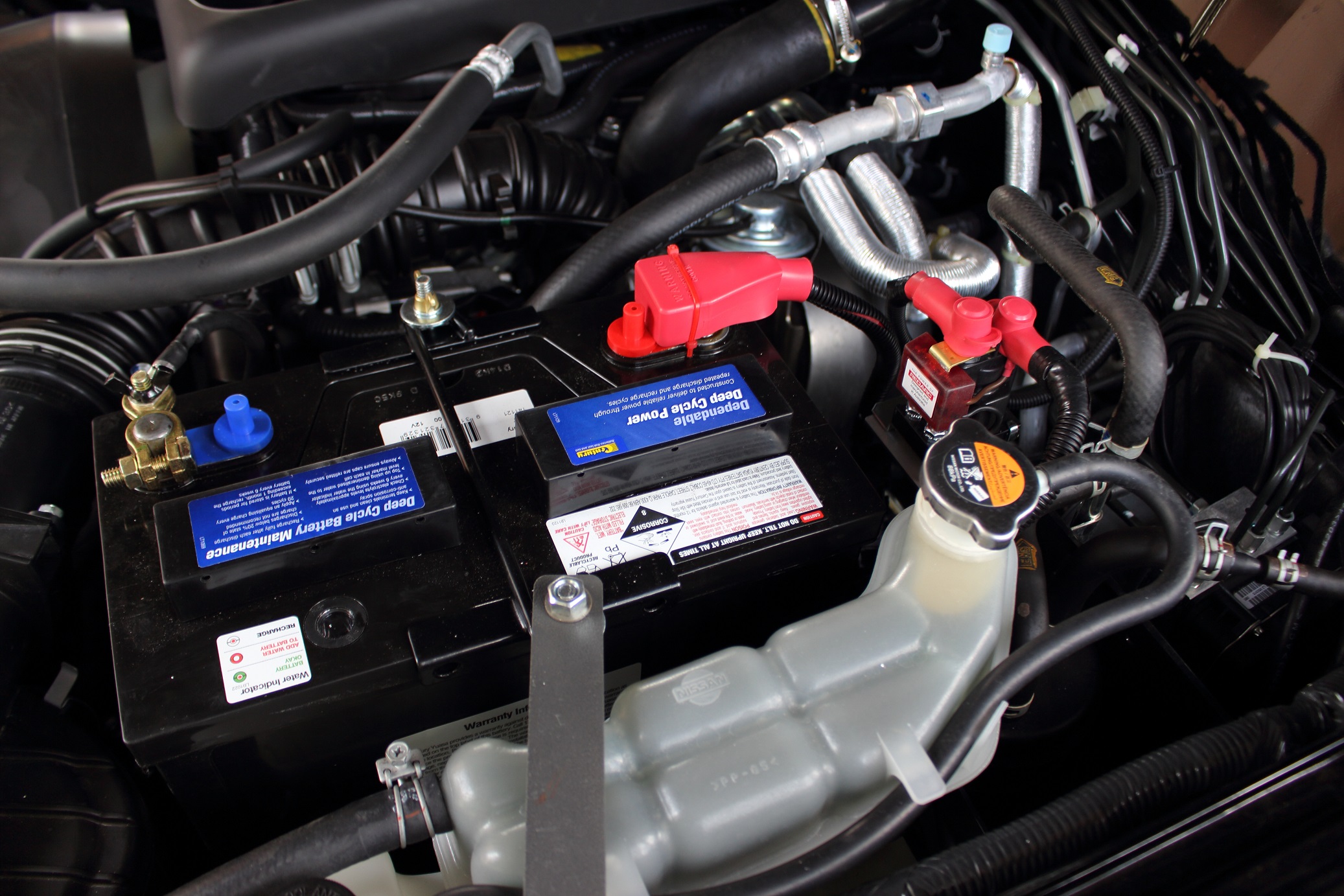

November 1, 201510 yr comment_8597 Hooked dual battery up. 1) Off Road battery tray with heat shield. I put 5mm flat conveyor belt rubber in tray for more battery support. 2) Century N70T deep cycle flooded battery. 3) Redarc SB112 Dual battery system. Ive not done the found a good over ride switch or battery monitor any I dears guys>? paul Report

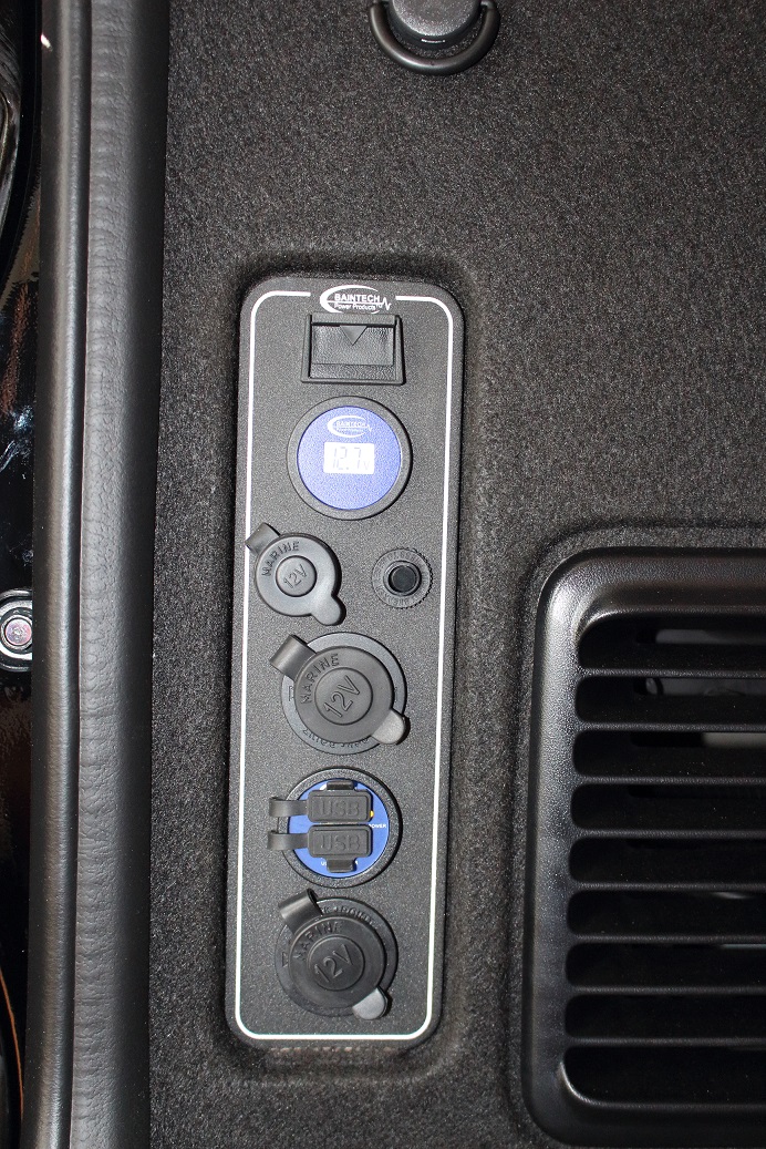

November 6, 201510 yr comment_8629 Installed Braintech power board in rear, replaced one of the cig outlets with dual USB. Edited November 6, 201510 yr by Paul Report
November 8, 201510 yr comment_8630 I've got the same Baintech panel, you had good idea to convert one of the sockets to USB charging output, where did you source USB sockets from? Regards Report
November 8, 201510 yr comment_8631 I got it from TJM @ cooper plains $30 bucks. Just watch your amps with usb ports as there are different sizes for min power rate on usb iteims. This is a 1.5 amp witch will does charge my Samsung 5 phone. You can get larger ones up to 2.5amps. Seen one that had both 2.5 and a 1.5amp. Report
