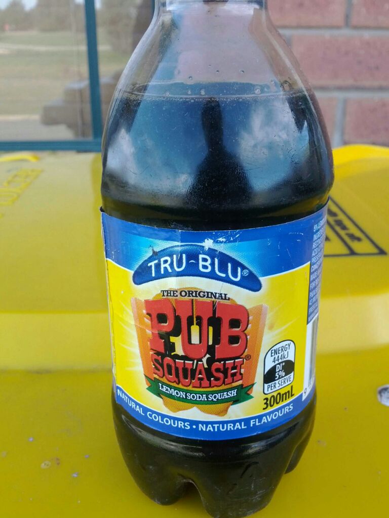

Replaced pro vent drain bottle. This is how much oil I have collected...

Wow, over what distance was that accumulated? initially that looks like a lot of oil, I now get around 40ml per 5000k which is the range I have settled on as a checking distance even though I don't change the oil until 10,000k.

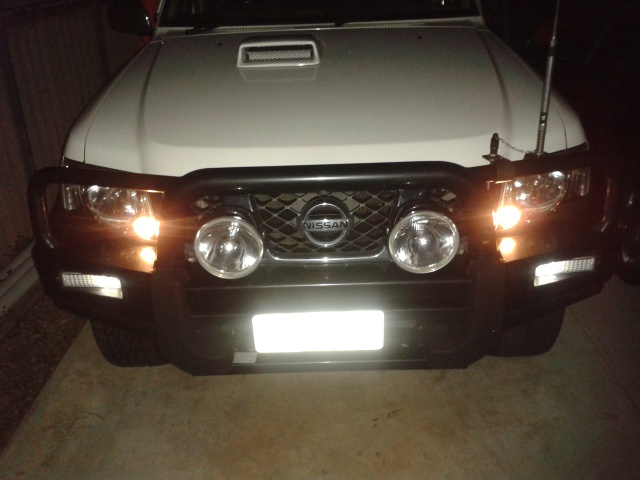

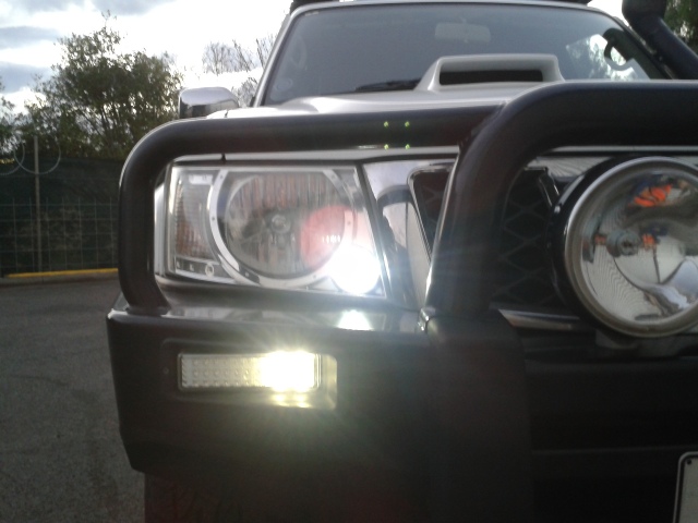

Fitted LED replacement T10 Wedge type globes in to main headlamps (the yellow glow of OEM globes was seriously disturbing to look at after the white glow of bull bar LEDs) part # ZD-0394 from Jaycar $6.30 for two.
Is that for the park lamps? I thought they were dual element?
Yeah that is over quite a while.. I get about what you get.. I think.. good feeling chucking it out instead of it going through intercooler etc..
Sent from my Galaxy Nexus using Tapatalk 2
Mine is 4 series, it has parkers incorporated in the inner corner of the main h/lamp assy and is single element globe T10. I think yours is the same except it is located in the separate indicator/parker assy on the outer side of the main lamp. I'm sure there is a replacement LED for whatever the type of globe is in there.
Edited by Rumcajs
Ohh OK cool thanks.
I went to replace mine with led but it was too hard to find a duel led park globe, too hard to pull mine out and I gave up...
