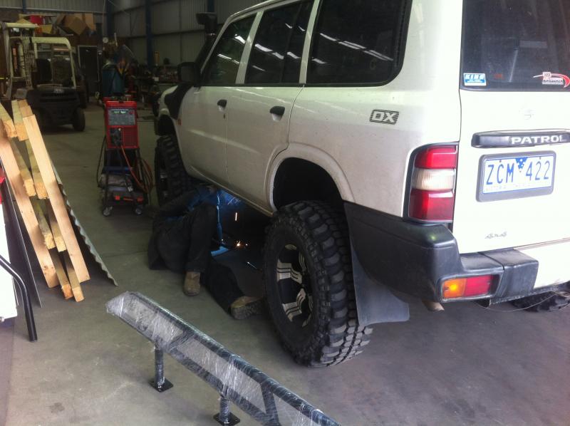

Dropped it off today to be stripped and built this week, i cant do anything much on the build this time as im busy with work. :( hope Alan takes his time and does a good job for me.

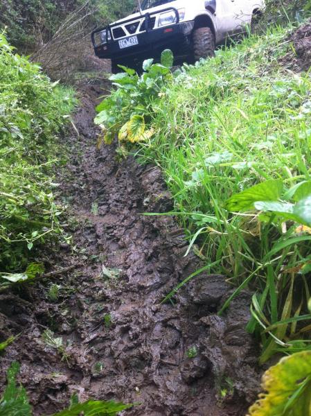

Ah, I haven't driven that road, though did have a look around the Bungaree area and Grand Ridge Road and saw some pretty good looking tracks in the logging areas. It's boggy enough where we go collecting wood at the moment, so don't need any more excitement.
Ray
Ray
When i organize a daytrip here we should meetup.
Im planning a tour of Boolara, budgeree, and middle creek, so pretty close.
I went to the Halston area a few weeks ago to have another look at the side tracks for wood and the main road going into the lower area required 4L just to get back without mad wheel spin (that was on my road tyres). The mud around here can get somewhat insane after even just a bit of rain. I might wait till summer and check out the logging tracks around Grand Ridge, I'm just not set up for the mud in this area.

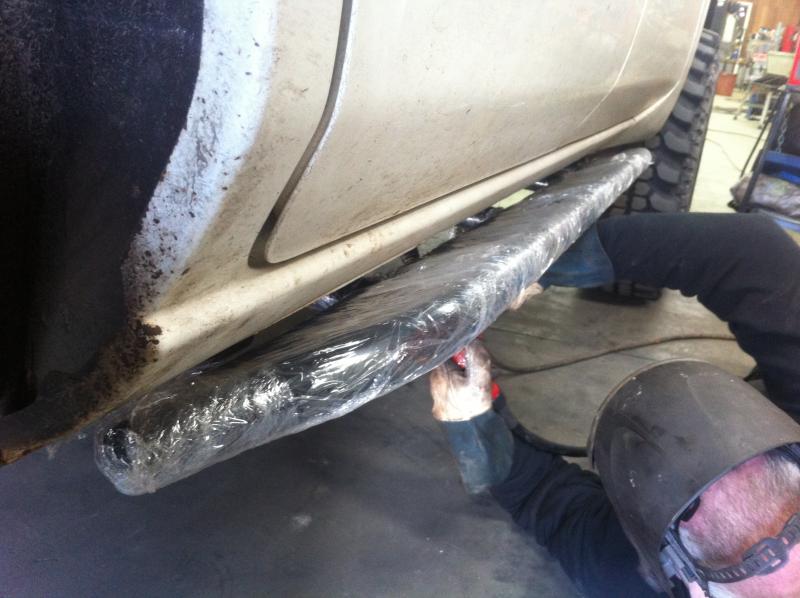

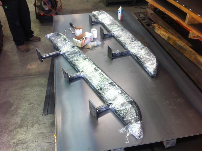

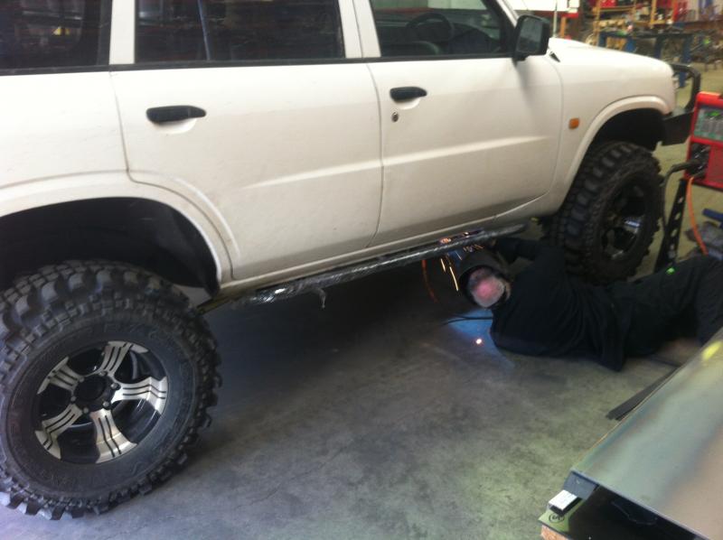

Where did you get them from?
Alan @ Racebred4wd.
Alexanders road morwell, Vic.
PHONE: 0351 341 007

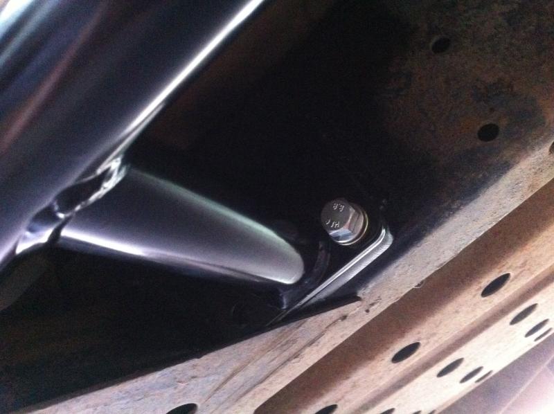

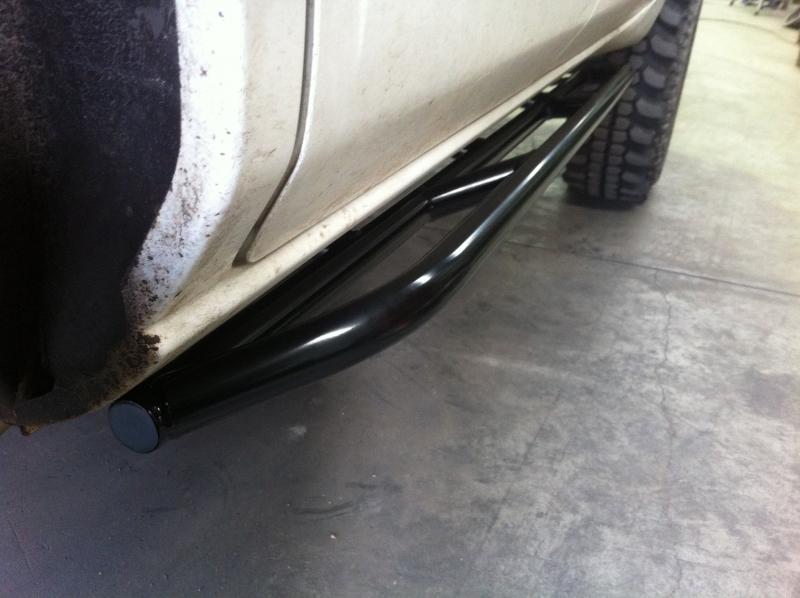

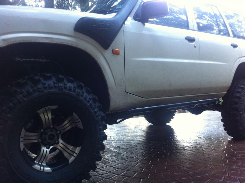

I get heaps of bits from Alan, he does good work, i paid $630 fitted for this set of sliders. probably not a normal price, but it gives you an idea.
EDIT: asked Alan today, Normal fitted price is 700. just the sliders are 550 plus postage.
