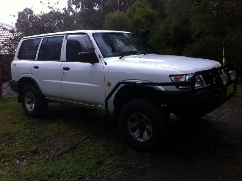

I just got home, i had a sleep for a few hrs just north of Cann river(until i nearly froze to death). Car got the normal economy(admittedly a little disconcerting to drive 80km and hardly see the gauge move, Im used to the rb30 now, thats 1/4 of a tank!), i filled up on the hume before the turnoff to canberra, it got home (around 750km) with a 1/3 of the main tank remaining(according to gauge, ill find out for sure when i fill up). i used the subtank. so getting around 12litres per 100kays sitting near as i could on the speed limit. -cruise control is nice.
pics in a few hr, im having a shower an gonna have a rest before i face the day.

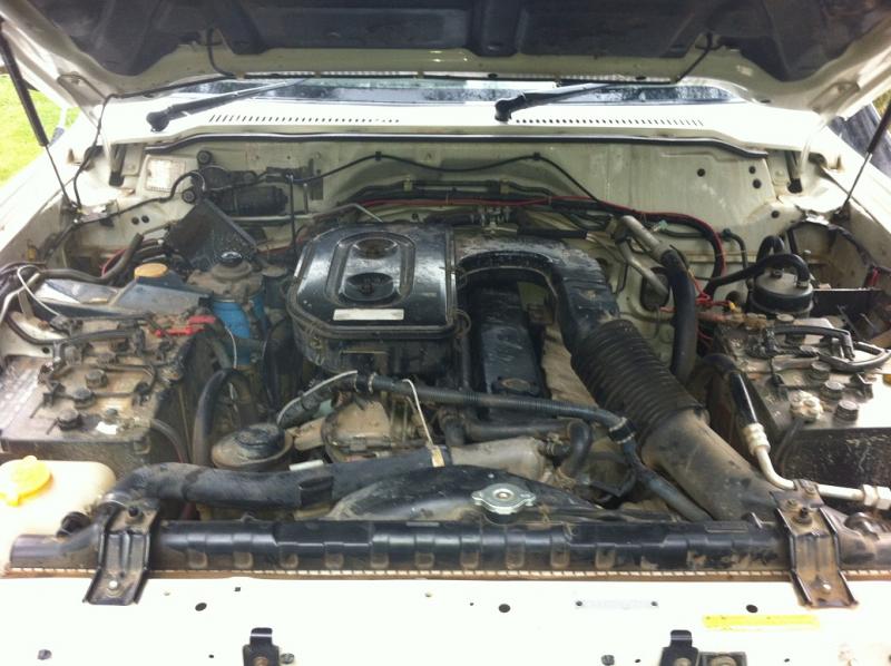

Bit of under bonnet cleaning needed I think.. then again ive seen pics of your other rides. :D

I must be some kind of clean freak. I've never had a dirty engine bay, or interior for that matter, in any Patrol that I've ever owned. They have been dirty after a 4WD trip, but I always pressure clean them as soon as I get home, and the interior is vacuumed and cleaned as necessary. And polishing is so worthwhile. After our last trip, I was certain that the pinstripes would be really bad, but after a good wash and re-waxing, the paintwork looks pretty good.
Ray

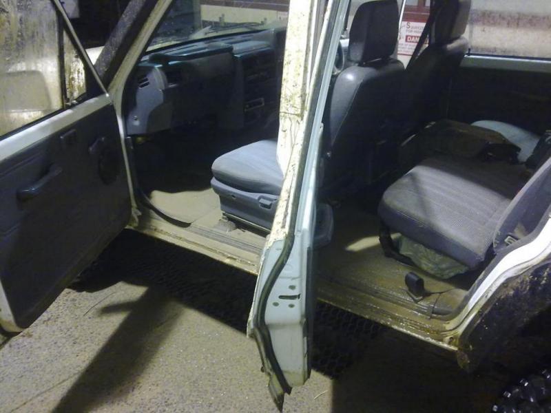

My interior gets dirty. . . i do the same as Ray!, pressure-wash it.
-also found it good if you get to it before she dries out....
High tide mark in one of my GQ's. same tide on a GU of mine.

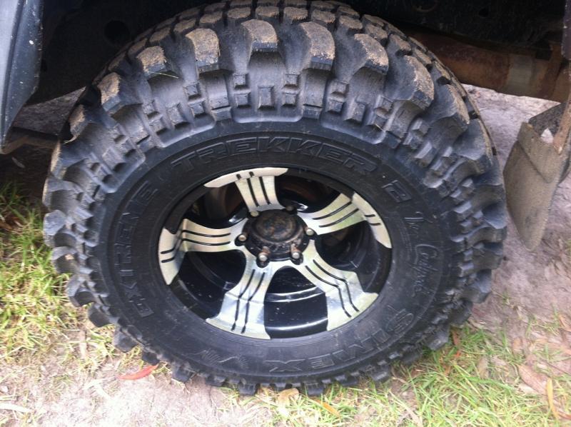

2: ill stick to running my simex's on my alloys to start with.

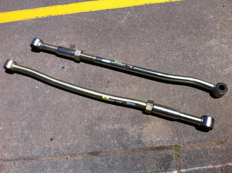

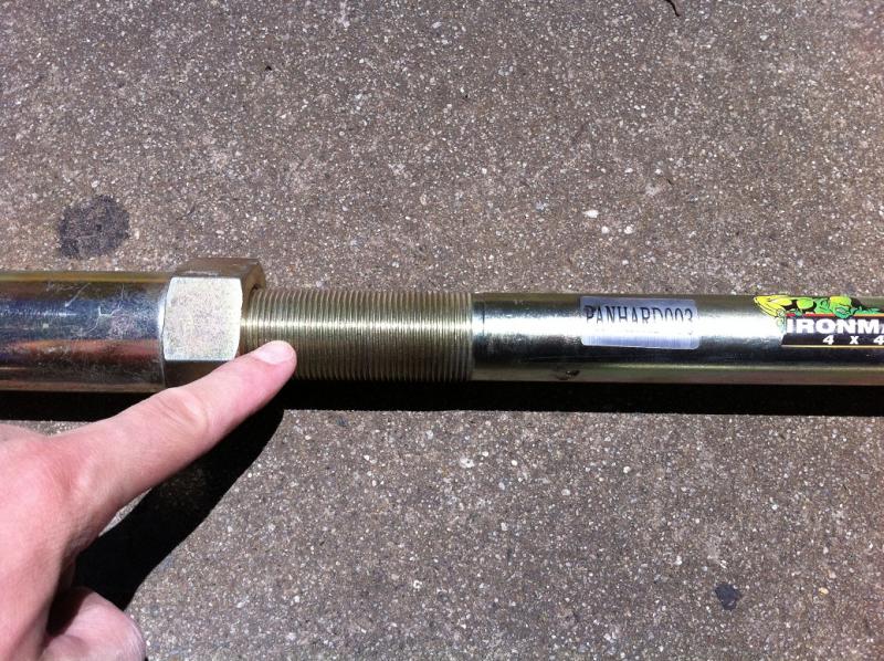

4: bought Ironman HD panhard rods F&R.

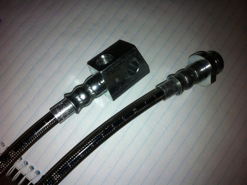

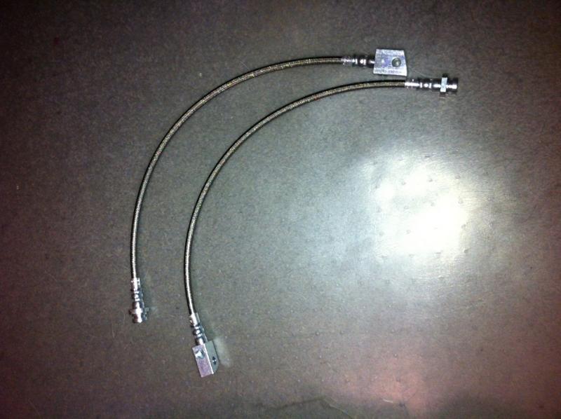

5: had extended stainless brakelines made up at enzed.

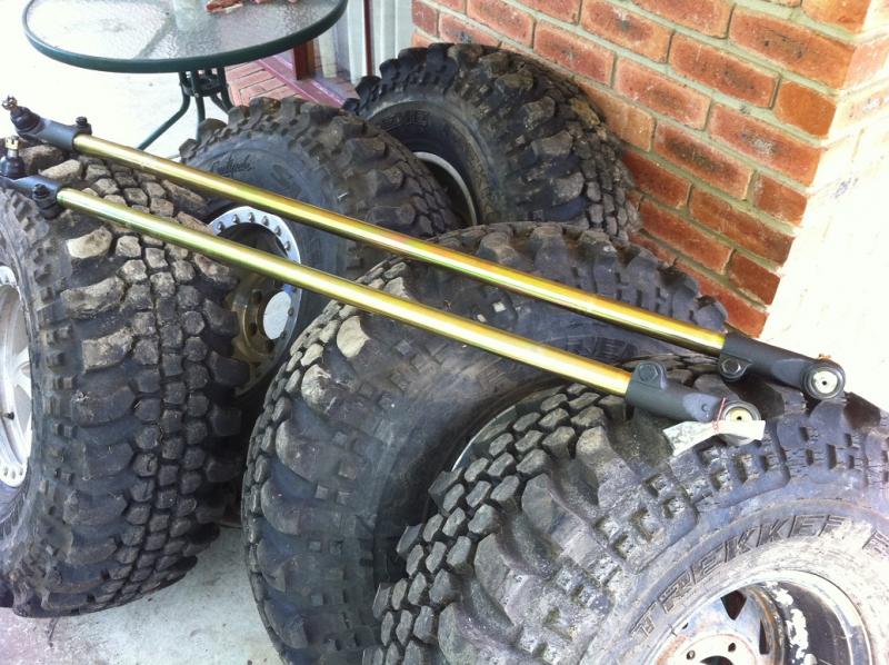

12: bought steering draglink, and rock rod.

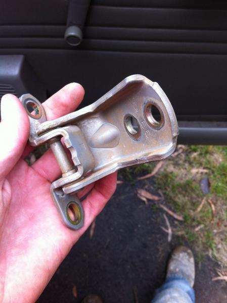

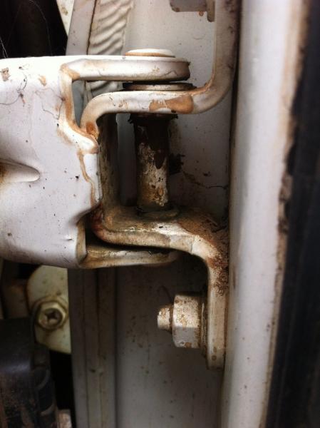

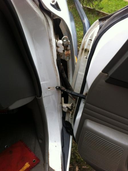

Started tidying up a few bits today. Front door hinge was stuffed.

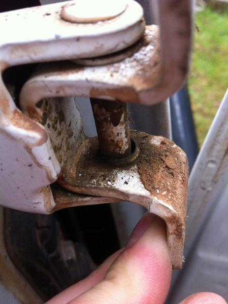

New one i got yesterday.

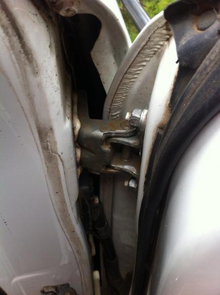

Have to take the door off to get the hinge out. found an old sock works good to stop you chipping your door/sill paintwork.
New one in place. . . door opens/closes good now.
You can also undo bottom of gaurd to get hinge out!!!
Still difficult for GU top hinge. but yes -that is the other option. . . . remove guard,
As a side point, ill say nearly any wrecker you go to will have no upper RHS GU hinges left. . . . they are somewhat of a crap design.
tip: pinch a lower left hand side one(all wreckers seem to have these, and they are about half the price lol.) they are cross interchangeable. bottom right fits top left, top right fits bottom left.

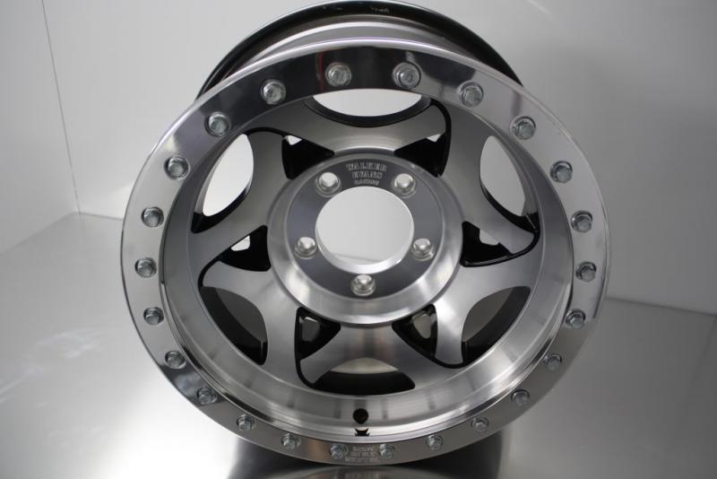

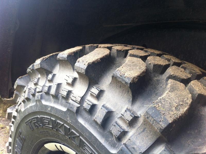

New walkers, What do we think? iv been offered a brand new set off the first boat,
set of 5 inc wheel nuts, balance/fit, on maxxis 37x12.5/17 comp treps for $5,400

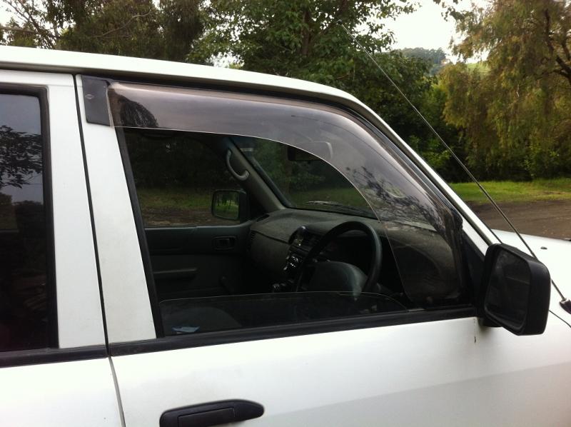

also started on my journey of simplification. got rid of weather shields,
(im a tall coot, 194cm, so i belt my head on these thing whenever i try looking out the window, -annoying)

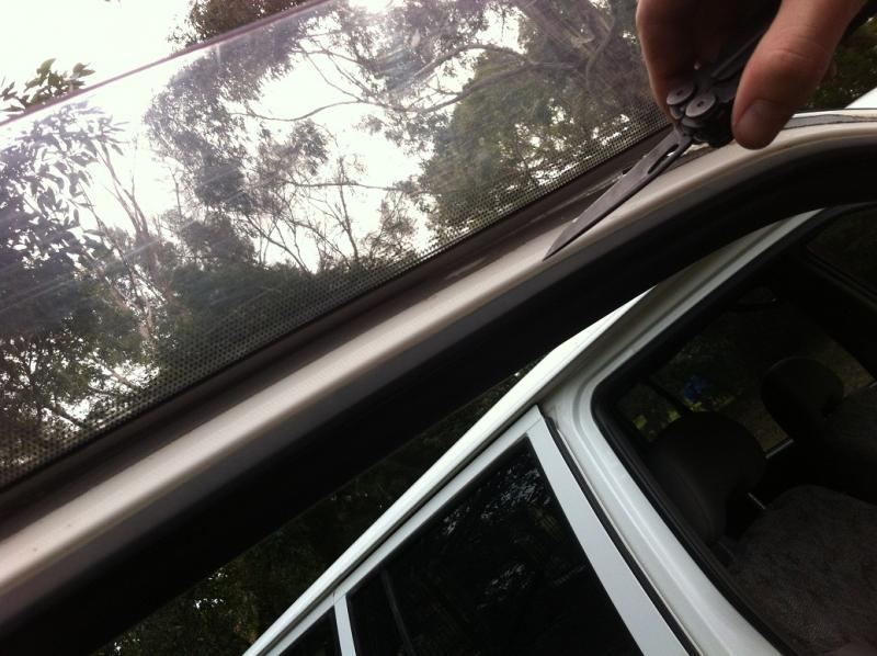

Undo bolts, cut double sided tape with knife, crape off rest of tape/glue, cut and polish to remove paint discoloration.
