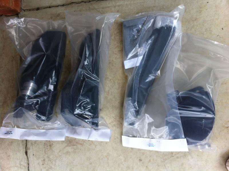

Bought some bits today :D , still getting ready for the build.
Iv decided to go with the ARB airlocker again :rolleyes: , im not sure why, it was an honest 50/50 either way, but i had to get the build done at 2 shops if i went with Eaton. . . easy to just do one shop build because of the forum trip being so close. Sad excuse i know, and ill still try to do an Eaton one day soon. :ph34r:
So anyway, here's what i got sorted today.

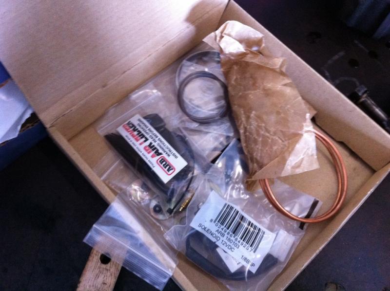

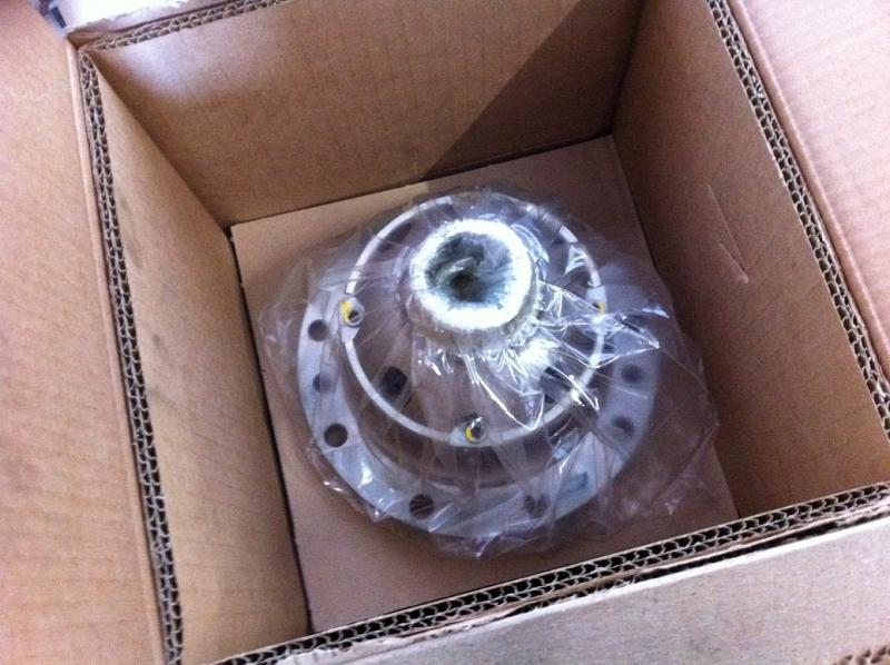

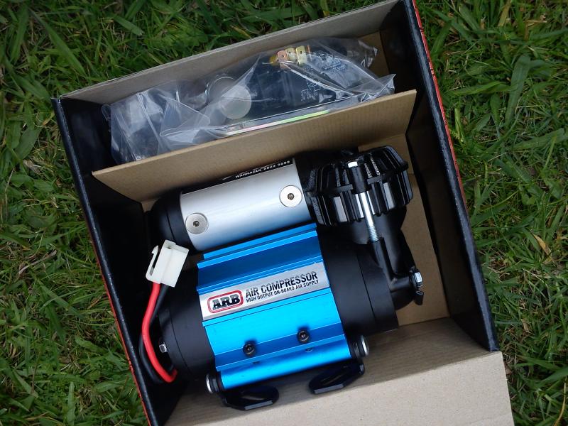

Paid for Front ARB airlocker Here's whats in the box.. :wub:
Paid for bearing/seal rebuild kit.
Paid for drop boxes.

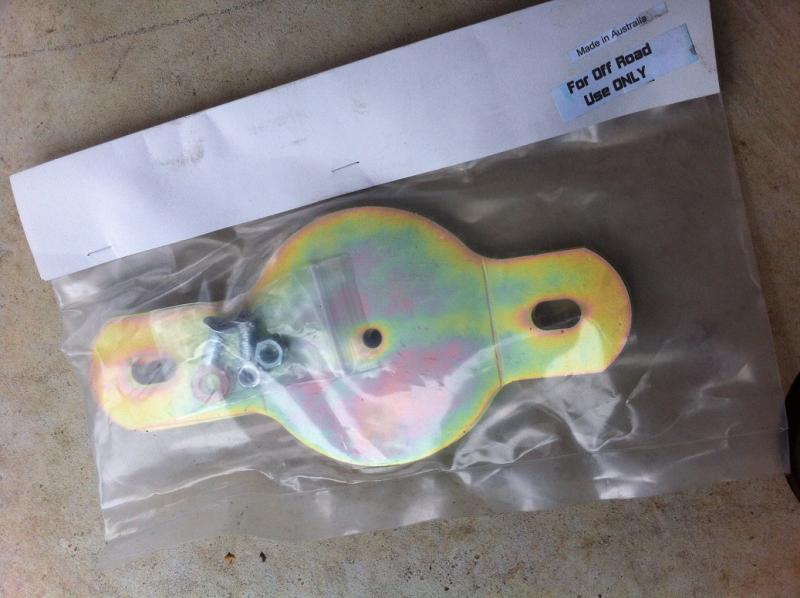

Paid for diff brace/lamination kit.
Got king smoothie canister bolt-in kits.
Paid for 80 series bumpstops and mounts front and rear.

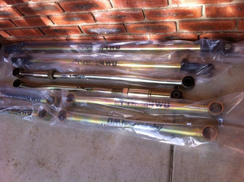

Found some radius arm bushes.
Paid for big ARB air compressor.

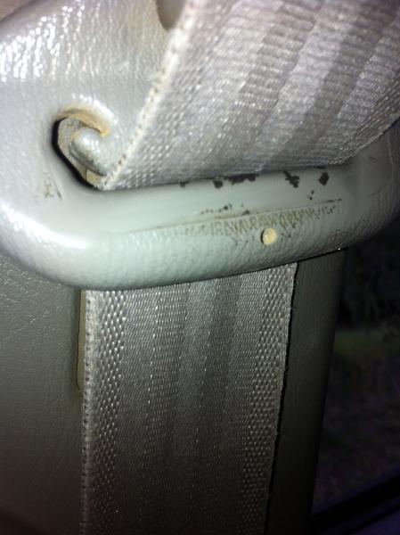

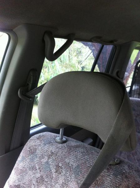

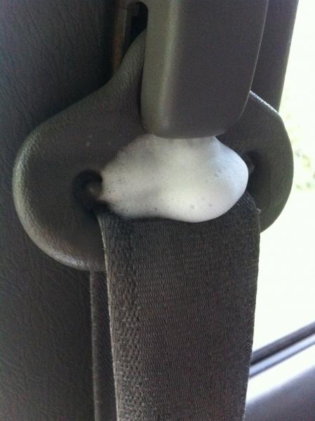

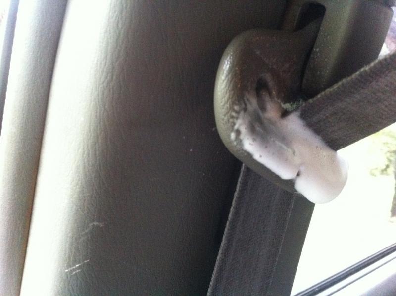

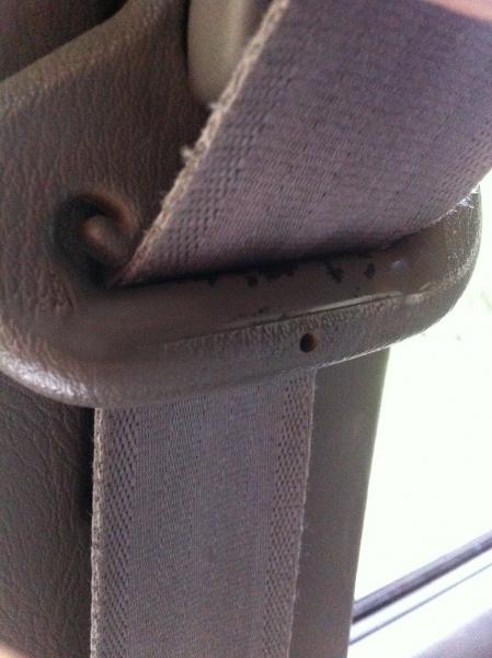

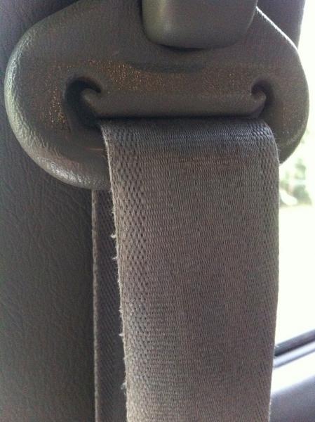

My seatbelts didnt need pulling apart in the end, just cleaning. -anyway i said i would picture the event.
One drivers seatbelt!
Underneath, years of sweat, snacks-dropped-on-shirt partially-on-seatbelt, essence of previous owner, and crud from dirty hands.
eww, Now with the flash on!
Use this, or other spray cleaner(probably not the best idea using Armourall etc since its oily and dust will stick to it re-creating the issue)
Spray here.
And spray here.
Allow a Minuit to soak, then use old toothbrush or the like to get Gunk out. Hold seatbelt out of the way conveniently as in above photo like this.
Usually fixes my seatbelts.

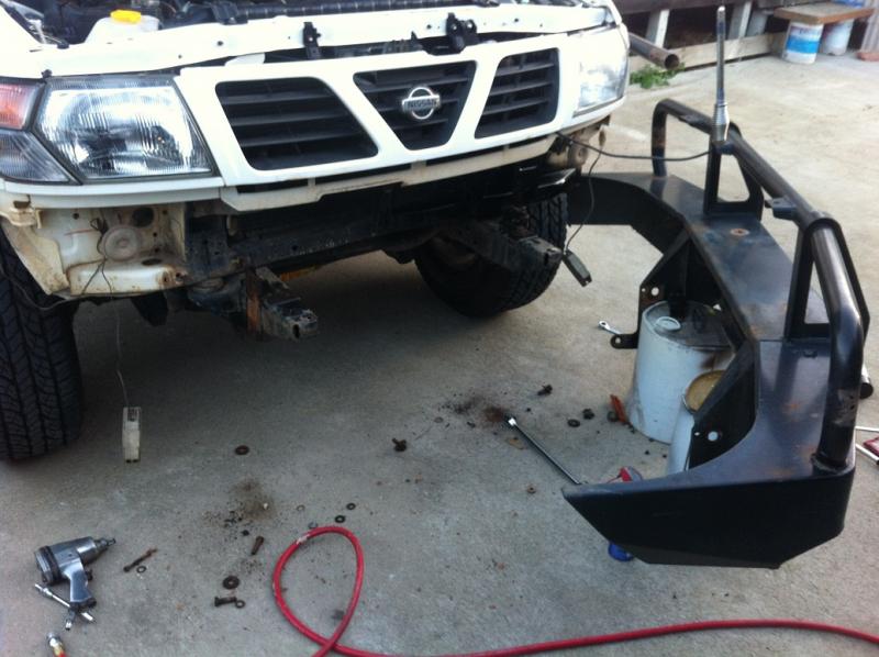

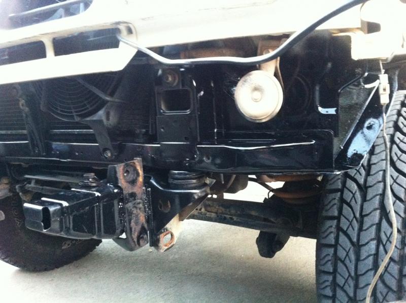

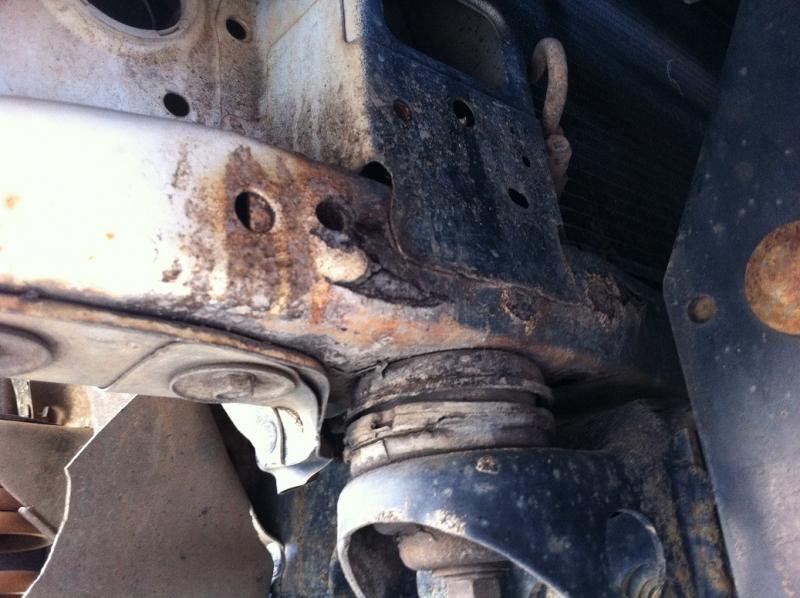

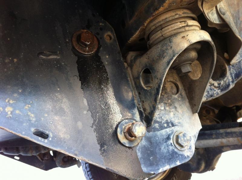

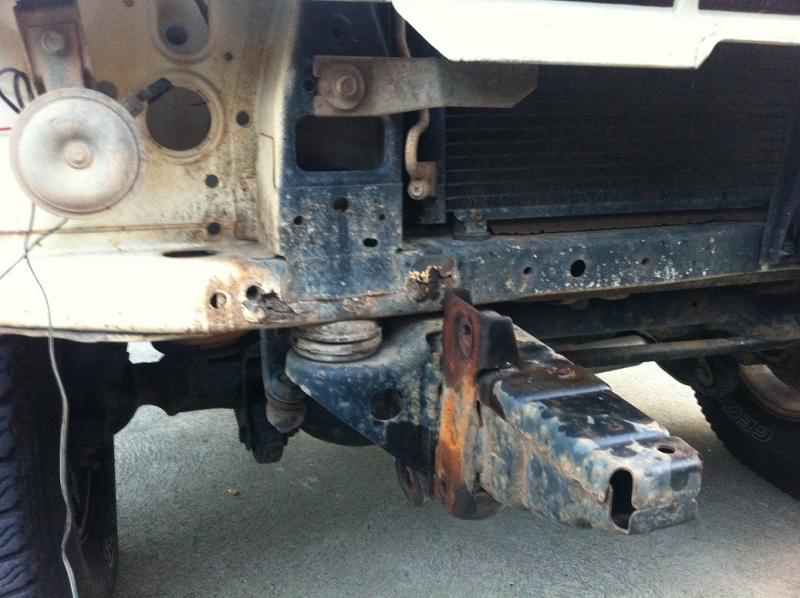

Started working on the Rusty radiator support yesterday.
Left.
Right.

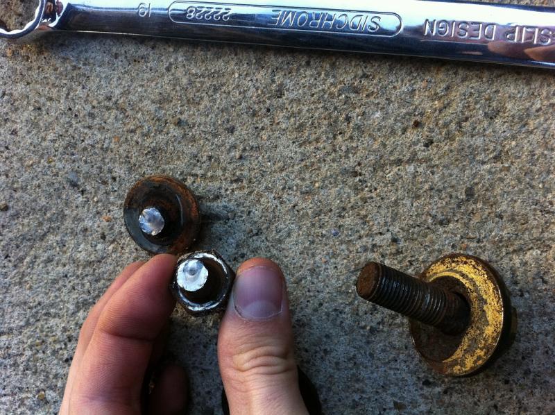

The annoying classic rusty Bullbar bolts, all 8 of em'.
bullbar out of the way.
This side is the problem side. . . . and the radiator support is a double skin design. . . . . perfect for rust. lol, im not sure why Nissan do it.
Fixed this side and most of other side, Finnish it today.
