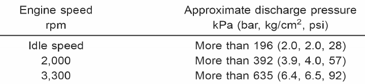

  1. Well, that might be possible(mine primer button is rock solid after several hours of engine being off). Fuel delivery system on my car is heavily modified and I'm not 100% sure that could also influence it. Fuel system on ZD30 seems self priming and as such will have a pressure drop once the engine stops. What the residual pressure if any is left I'm not sure. On fully closed fuel injection systems running at around 150 to 200 kPa delivery pressure the left over is about 50 kPa because fuel lift pump has non return valve built in to retain the residual pressure. The trend on self bleeding fuel systems is opposite they drop the pressure to 0 kPa because those systems have a small orifice after the pressure relief/regulator valve so there is a constant bleed off while engine is running. Those systems do have however external high volume fuel delivery lift pumps usually gear type. Looking at the design of VP44 system it is kinda weird cause it doesn't contain fuel bleeding nipple at the either the filter or the injection pump fuel gallery which suggests it isnot fully enclosed system and by having internal fuel lift pump one can't tell if there are non return valves of sort in there.....(note bellow is a image of 6 cylinder version of VP44 but essential components are the same e.g. 4 cyl version has just 2 high pressure plungers...) so it basically purging air only after enough pressure is generated by fuel and relief valve starts to unload... So it is possible the filter head contains non return valve therefore if it is leaking it allows fuel to drain back to the tank. I have had no privilege of dismantling fuel filter head yet on Nissan so I don't really know. I'm very familiar with heavy vehicle diesel engines fuel systems and variations of non return valves vs self bleeding restrictor/orifice in the fuel return line is mandatory. These engines do use separate geared fuel lift pump (like ZD30 common rail version) because fuel volume and feed pressure requirements are much higher (around 500 kPa). What is clear from your issues is that fuel delivery in to the IP (injection pump) is compromised. Low ICV% are also result of blocked fuel filter, restriction in suction line this part is very difficult to identify. If Nissan included some kind of screen/sieve in the fuel pick up pipe and that is restricted with debris could should also be not discounted. One way of seeing that is to make you own temporary "fuel tank" with the jerry and direct hose to filter housing to see what happens to those ICV% or indeed primer on the fuel filter head. B/R

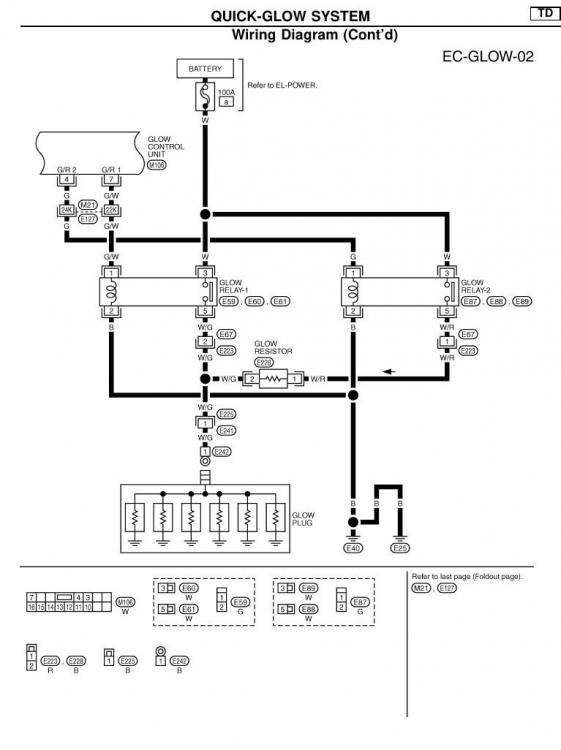

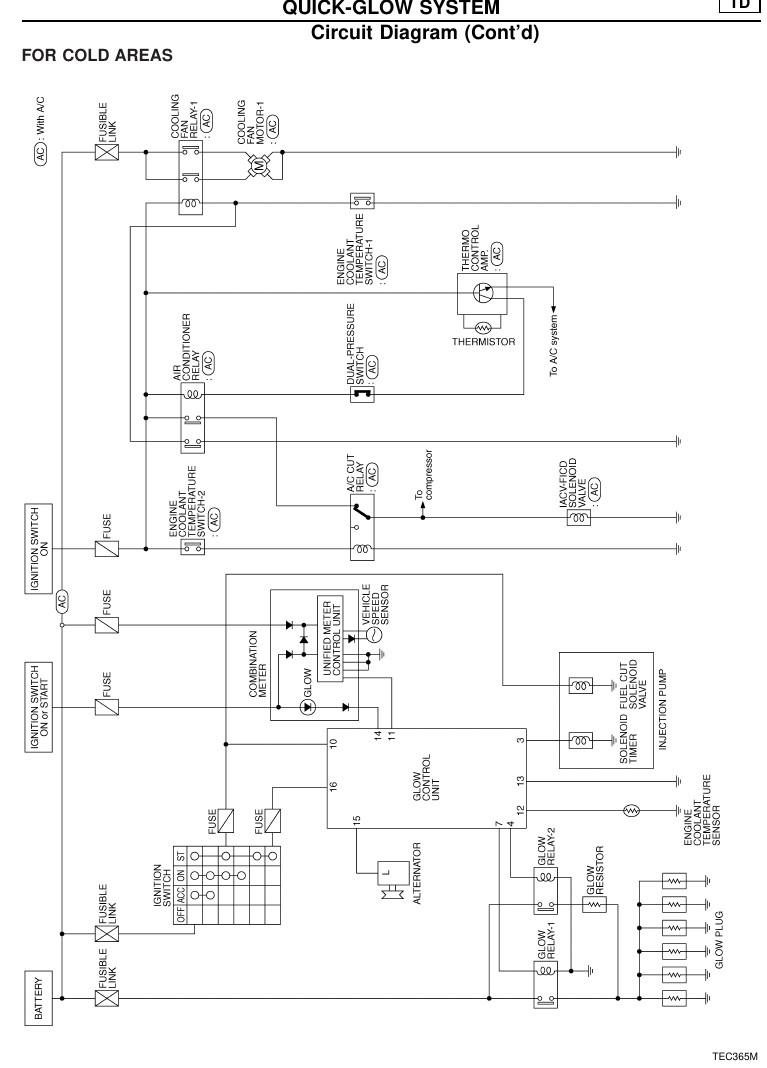

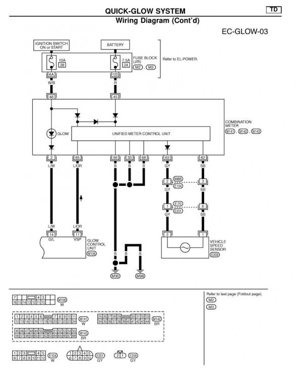

  25. Try this ==> but with caution as Ni$$an is typical with how one can't identify which version one has. I looked in the manual and the way they list these glow plug circuits is either for cold areas and except for Australia or just but there are two fundamental versions.... since yours has been converted it is even worse to identify. Bellow is an example for "cold areas" whatever that suppose to mean all places but Middle East and SE Asia and Africa? Cause if you live in Darwin AU you don't need glow plugs but if you live in Tasmania or Victoria's High Country you definitely need glow plugs for cold areas.....This entire control system BS I would re-wire to manual control where I get to choose/decide if I need to glow. However TD42 being indirect diesel injection system those are notorious to require glowing even in mild temperatures..... this system is over complicated as it has pre-glow pre start and then post glow after start (for emissions) ..... Regards
