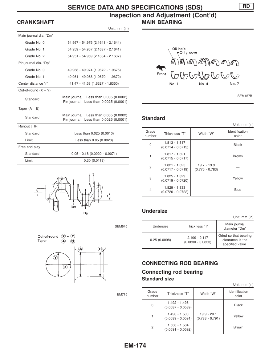

  8. It means tolerances given for each block and crank combination. You will need specs for each to understand the sizes. Something like bellow Regards

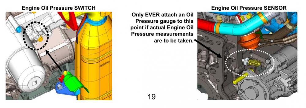

  15. The usual location of oil switches/sensors on ZD30 ===> Note bellow explanations refer to "common rail " version of ZD30 2007 onwards hovever the location is the same on previous model too. If you only have one than it is the one on LHS image. Which means no resistor either, easily checked by disconnecting the plug when engine run if the light is on it will go out..... Regards
  16. I'd lock hubs manually first to check. If it is CV then in most cases the clunk would be there only on full steering left or right lock. Personally I'd gut out auto hub lock clutch and be done with it if yours are auto locking hubs. That way it is on only when manual lock is engaged. If you have access to 4 axle stands then raise the vehicle of the ground and "drive" it that way so you pin point the source of the noise. Cheers
  17. G'day, The switches are not same, and the resistor is upgraded one. What might happen is that the replacement switch will fail again due to the resistor. That is/was explicit warning on the Nissan repair bulletin. Part numbers: LHS switch ---> 25240-8996E (low side) RHS switch ---> 25240-2X90 (high side) One of the difference is that RHS switch is marked with green circle as well. I tried to swap them around as to what will happen and the oil light will not go out if the low side switch is on the high side! Regards
