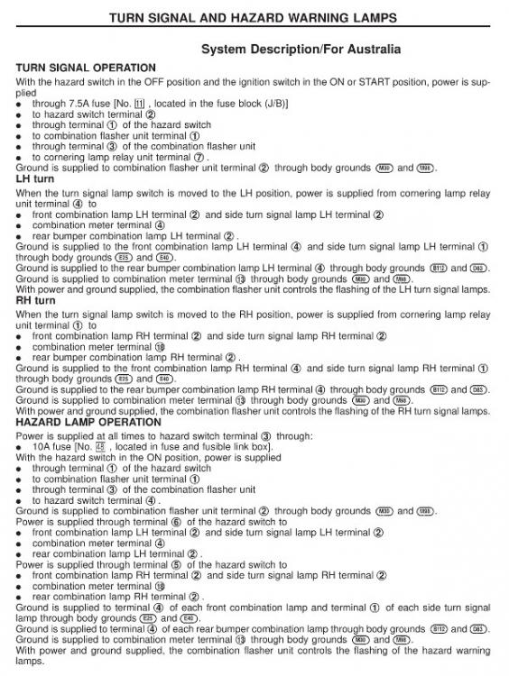

  18. You can certainly try and see what will happen, I'm at a loss to explain why would that cornering lamp unit even affect the indicators because to me it should only be processing the signals for cornering lamps outputs not actually affecting the indicators buit that's the design those monkeys have chosen. Remember these cans are negatively switched so I'd still make sure you have a good ground. Patrols are notorius for earthing issues thanks the Nissan idiot saving money by not including extra earth strap between the body and the chassis. Regards
  19. Hello, There are 4 different version of indicator/flasher circuits depending where you live (typical Nissan). I reckon you have earth/ground issue. Bellow is the description for Australia :
